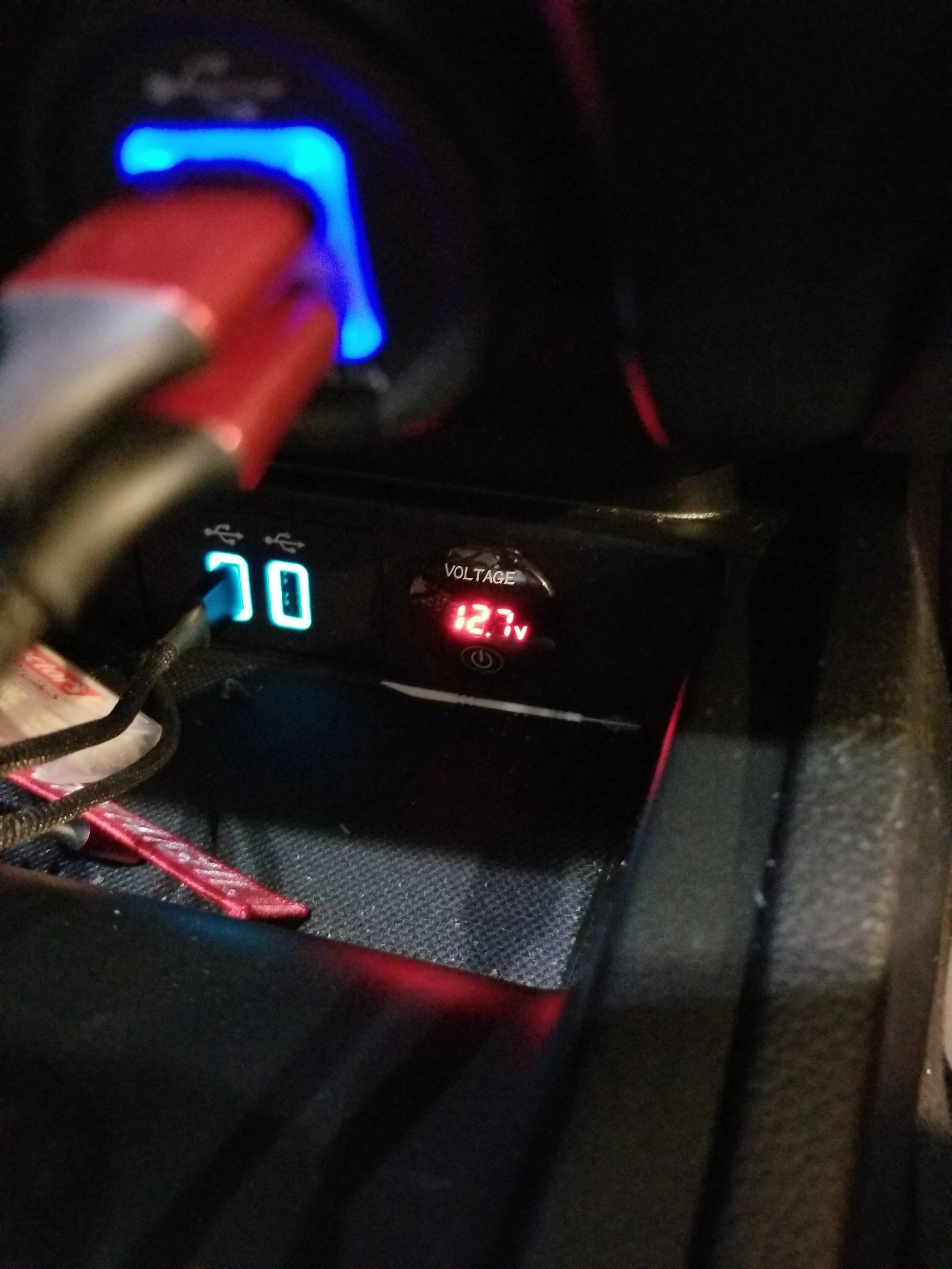

I don't believe that screen is available in Forscan but I could be wrong. I installed a volt meter so I can monitor voltage and see what works. You have to be quick because as soon as you get near the Ranger every light and system come alive and the voltage starts dropping. Before upping the SOC to 90% and using a trickle charger the voltage would be below 12v regularly. Now it stays in the high 12 range, all with a new battery.
