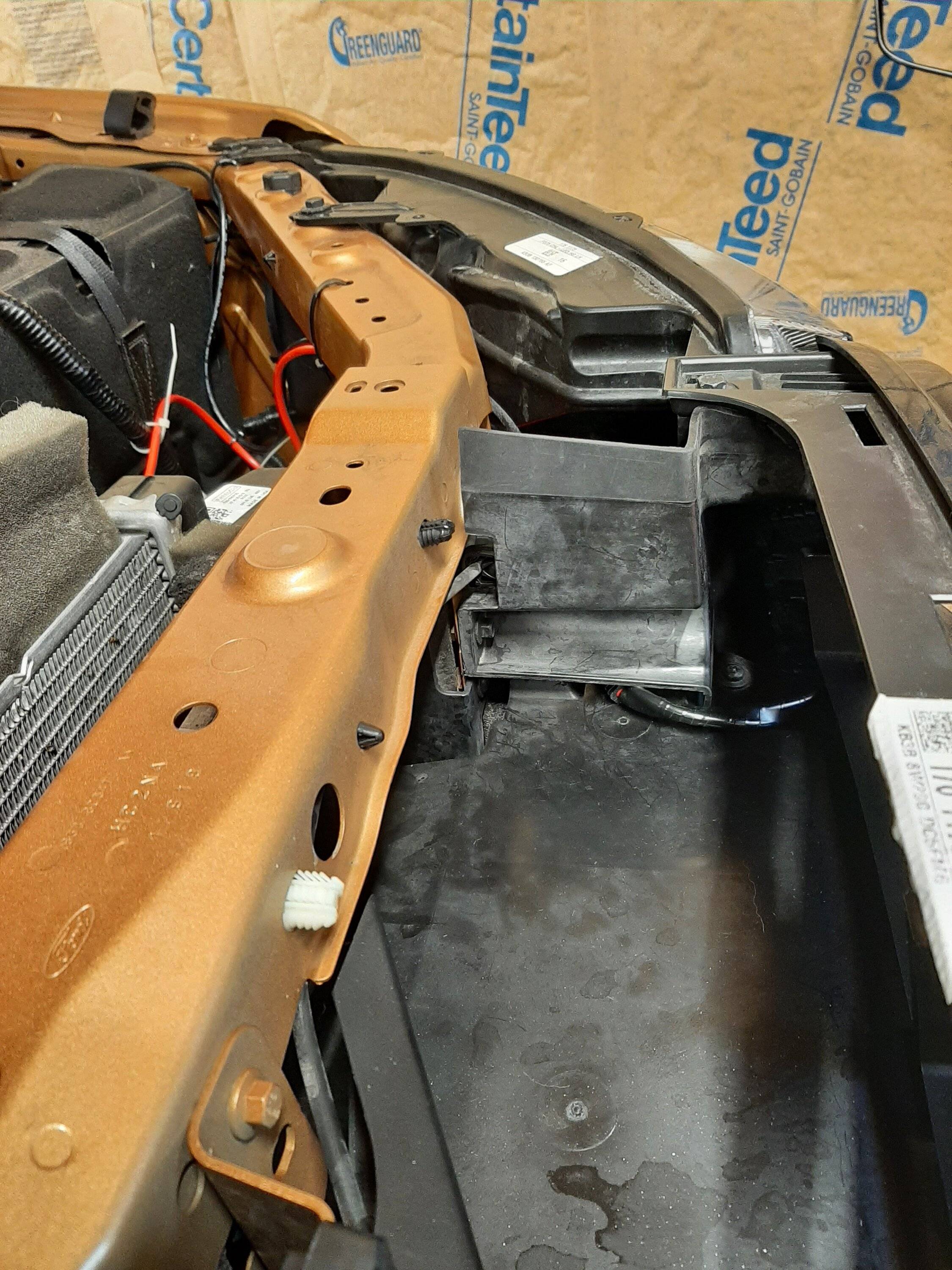

I'm not sure what the heat rating is for it or if it will get damaged from the vibration. Do you have a garage or a porch close by? You could get the longer lead and have that come out the grille and then the charger could be protected undercover and run the extension cord from there.
I ran mine down to the lower front tow hook. This way I can tuck it in the rubber boot when I'm not using it.
https://www.ranger5g.com/forum/threads/fordpass-app-message.20787/#post-447866

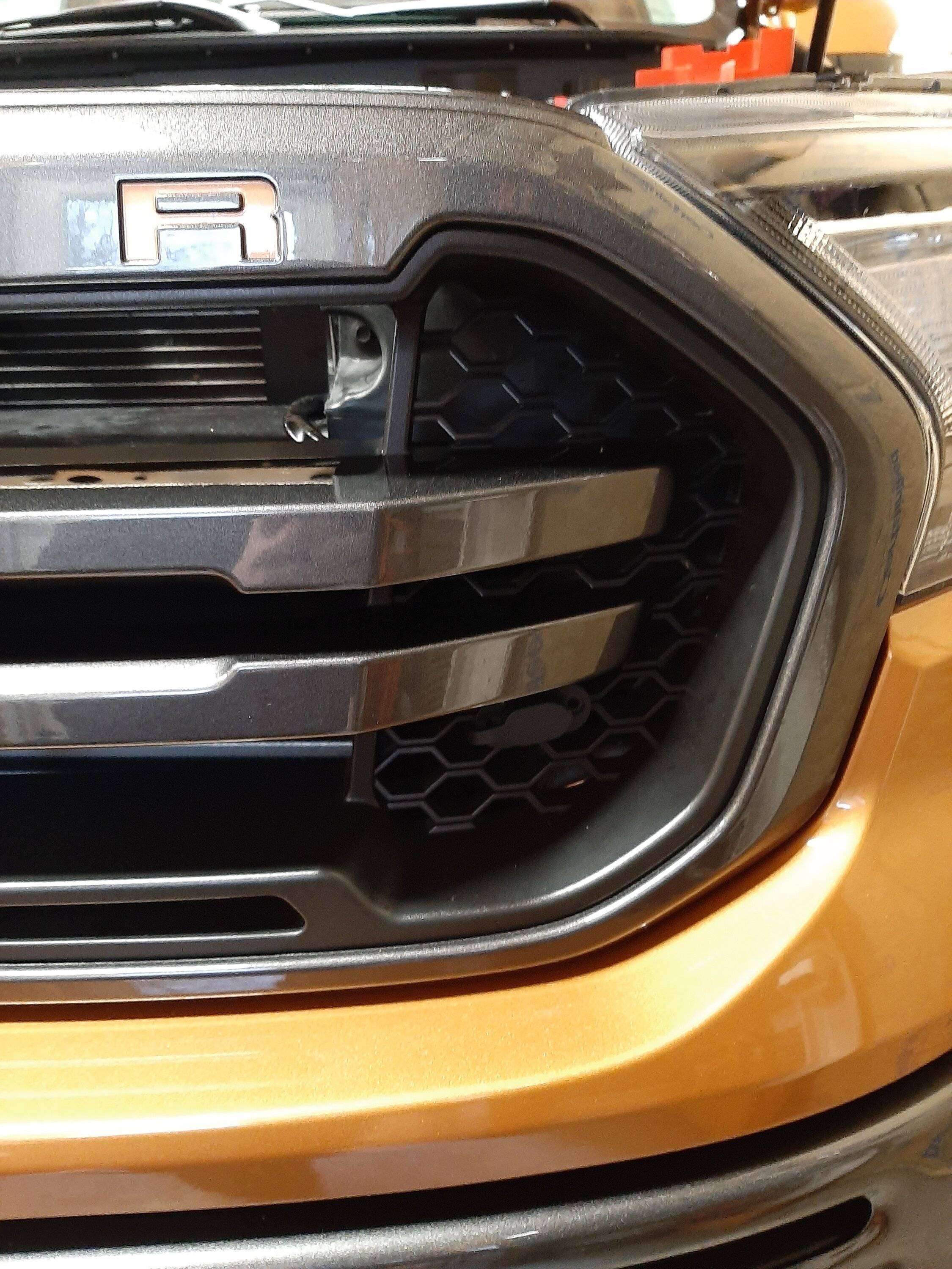

Here is how I handled wiring for my trickle charger. Where I park in the garage, I have a hook on the wall to hang the trickle charger on. I was able to pressure fit the SAE connecter in one of the holes in the grill. It has a cover I can snap over it when not in use.
That's a great location too! I have to pull all the way forward so I can lower my tailgate. There's not much rom up front so I had to run mine down low by the tow hook for the best and easiest access.

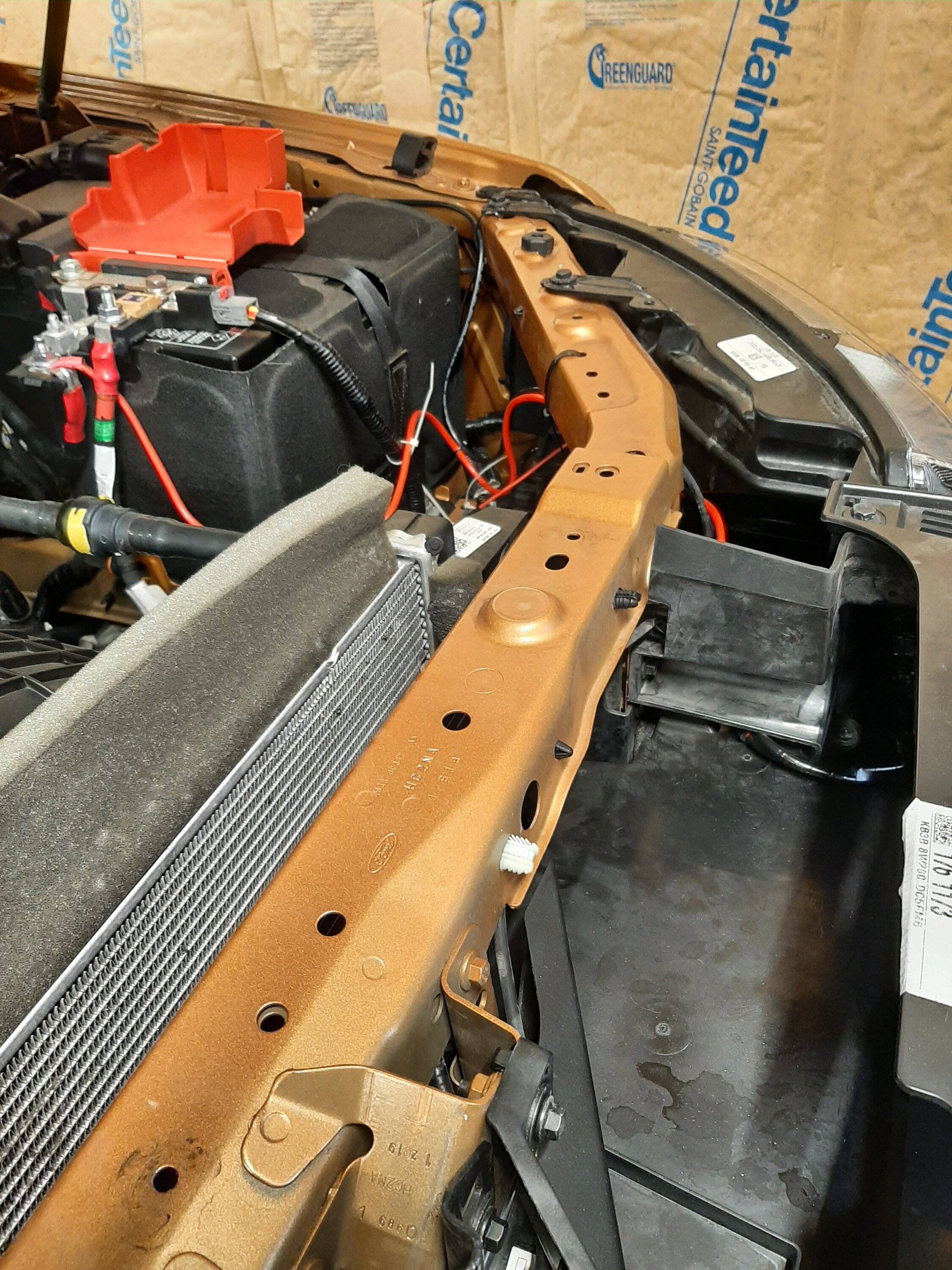

Thanks. Now if I can only find away to install this set up on my '22 Bronco Sport as I am having the same battery issues on it. The grill is not as easy to access from the engine compartment as the Ranger's. I am going to have to really study how that grill and front clip are attached to find a good route and attachment point.
On my wife’s BS I ran the leads up the cowl just to the side of wiper. Easy to get the leads there.
Here’s a view on our BS. I went with the CTEK charger.

@SigOris Thanks for the photo. I had thought about that route.
Truth be told I didn’t look for a grill location as I was afraid of out of sight my wife would drive off without disconnecting ?
