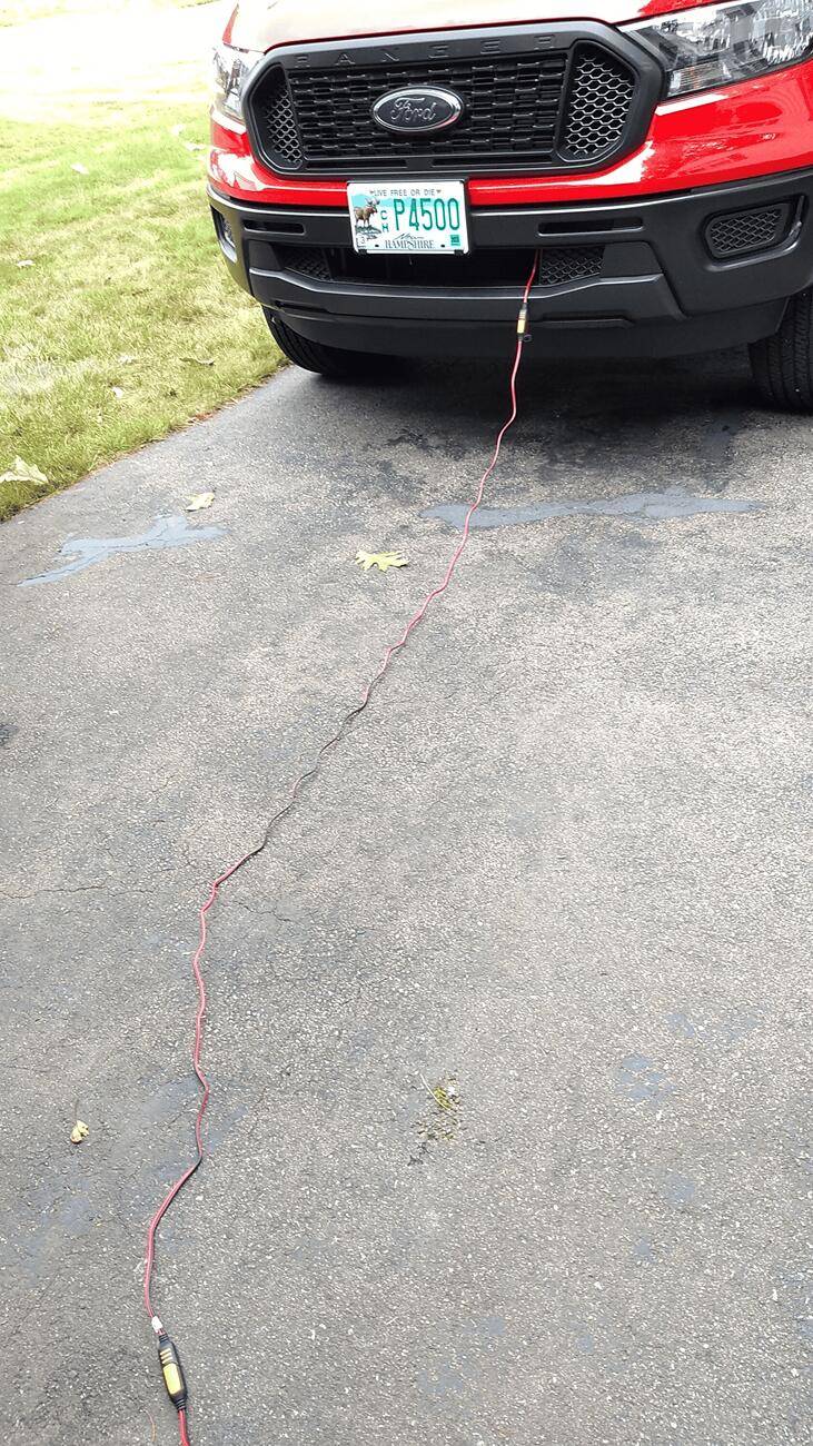

CTEK Maintainer:
https://www.amazon.com/dp/B00CD44RQ...0W5WUIWA&psc=1&ref_=list_c_wl_lv_ov_lig_dp_it
Extension Cable: **Make sure you ground this to the chases and not the negative post.
https://www.amazon.com/gp/product/B00ADIHUVG/ref=ppx_yo_dt_b_search_asin_title?ie=UTF8&psc=1

Here's a post of mine showing where I grounded it and ran the extension wire. Don't mind the dirty engine bay. :surprised:
https://www.ranger5g.com/forum/threads/fordpass-app-message.20787/post-447866

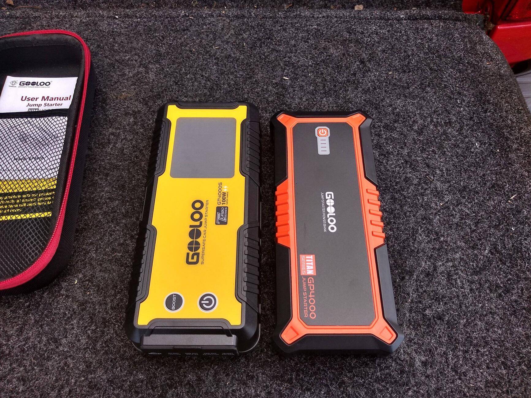

And a battery pack FTW! =)
I still carry jumper cables but love the ease of the battery pack. I know mine will work since I use it when working on the old FJ40.
I probably should free up my storage and just leave the jumper cables at home.
I feel that the battery pack also introduces less liability if I'm trying to jump start a stranger. I may be naive in that thought.
Since I'm ever overlanding and away from civilization any time, the battery pack alone is probably ample (plus I have AAA too).
