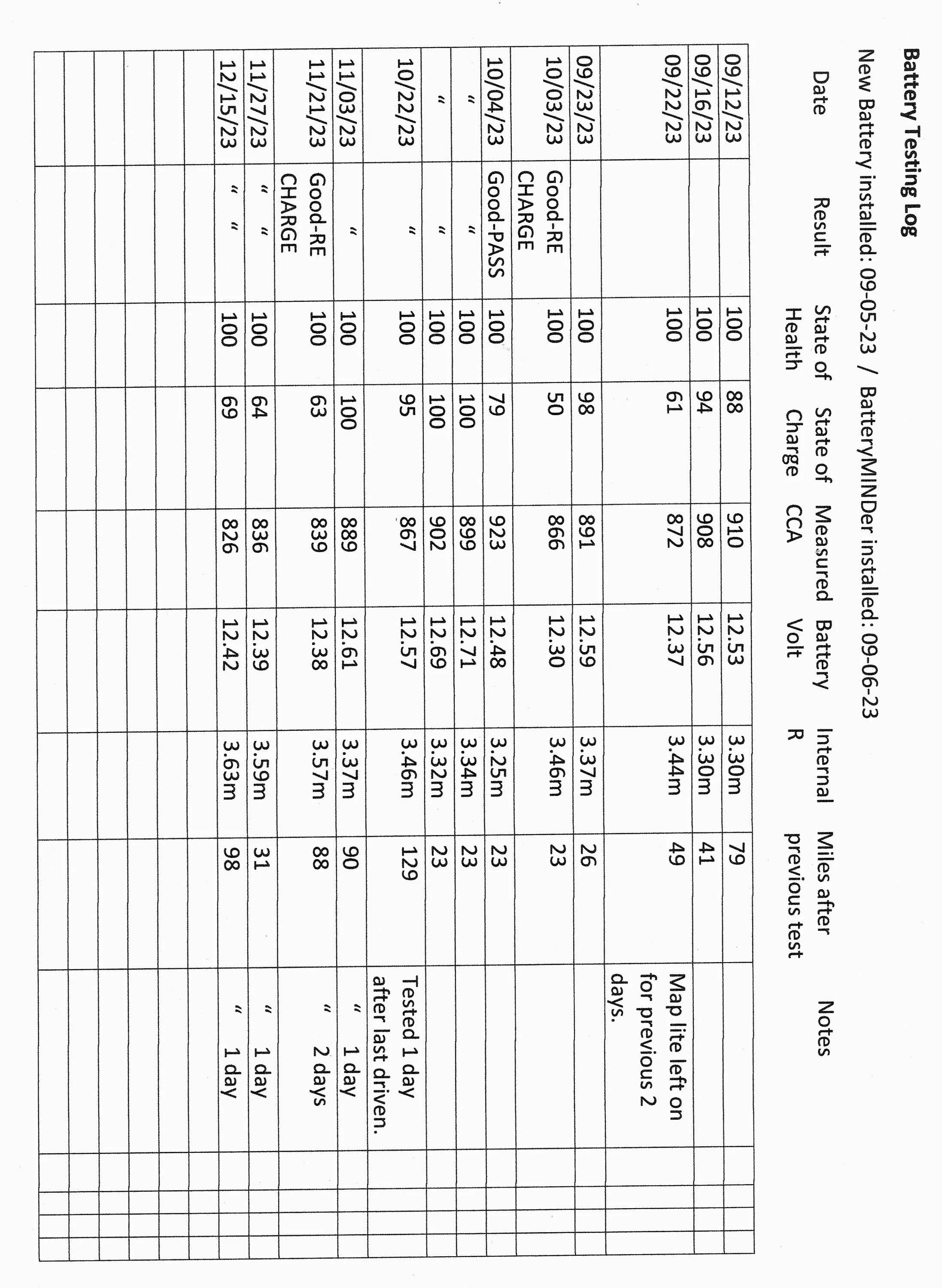

I am very challenged when it comes to electrical systems. Tony @TJC is guiding me with steps on how to learn to use this system. I'm not sure yet how to monitor the BatteryMINDer results but here are the readings so far according to my battery tester and hope they help. I have a NOCO charger that I haven't used yet but need to start hooking it up when the battery shows that it needs a charge after testing.

Kee in mind batteries are chemical devices and readings are impacted by a number of factors , especially by temperature differences and if you still have the bms operational I'd expect to see a wide range of readings.
TJC
Aug 28, 2020
47
4,002
10,083
Yep, temps matter. I would try unplugging the BMS module at the neg terminal as an experiment. Drive it for a month of two and then check your results. You might be surprised.

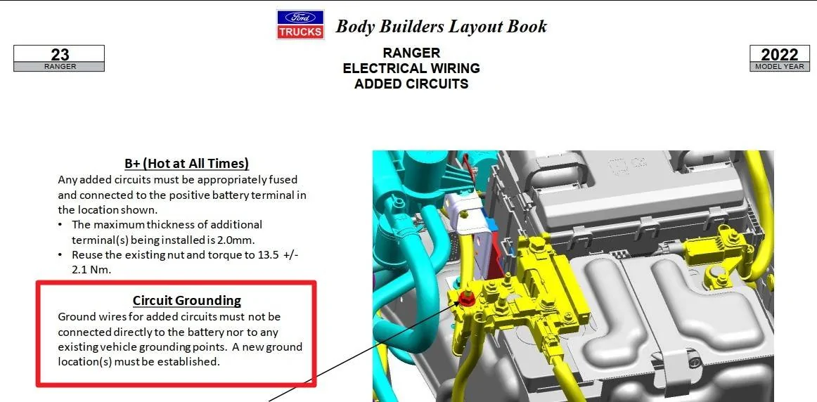

Had a new battery installed under warranty and I have been charging using a smart trickle charger (NOCO with intelligent battery state CPU) when the truck sat unused, the factory battery still died within a year and a half. Started throwing U codes and wouldn’t charge items like cell phones nor provide DC power for accessories.
So even if the BMS is tweaked, it may not be always yield the best battery life.
And yes, I was charging thru the current sensors, not to the battery posts directly.

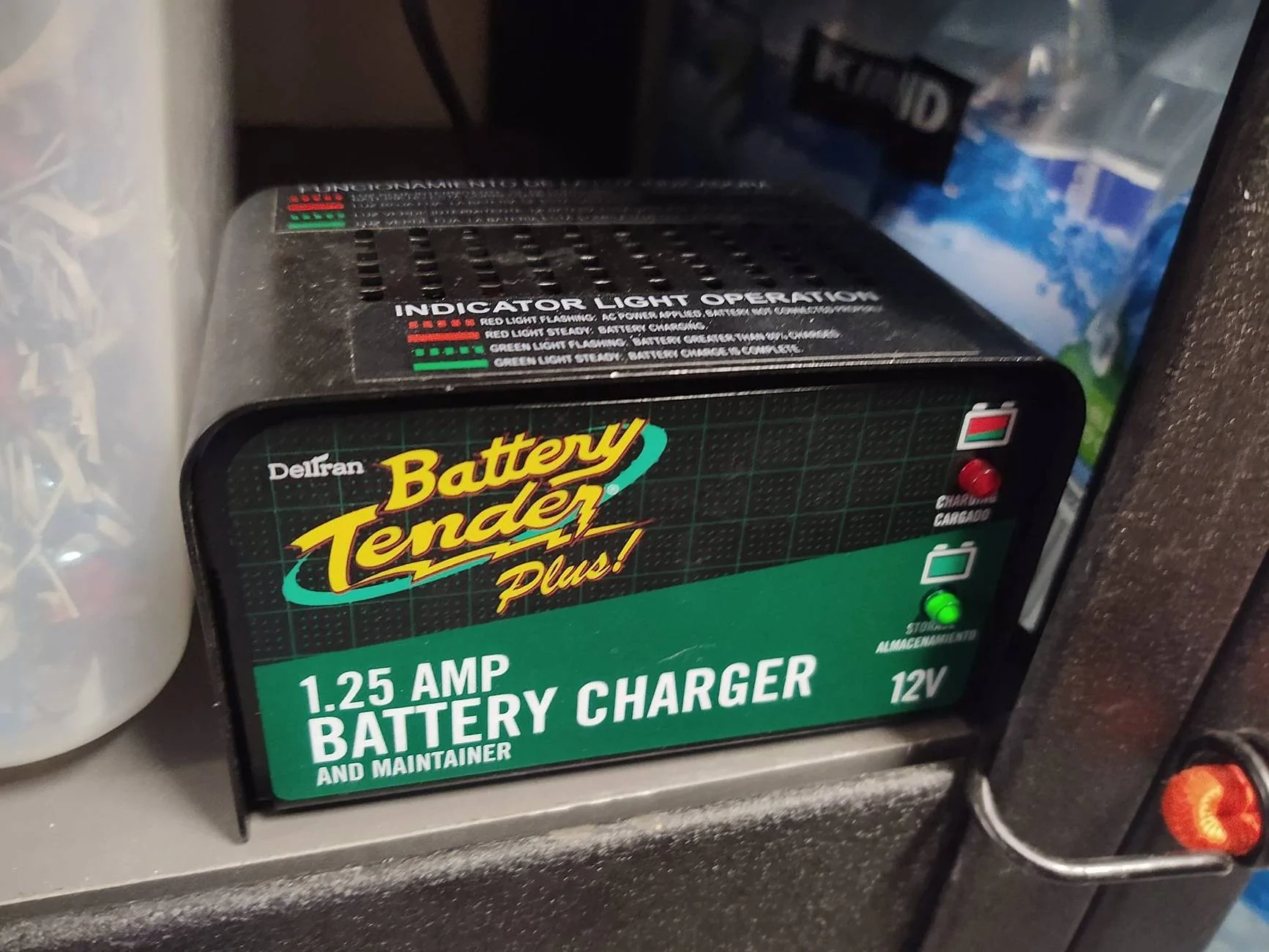

Mine has been hooked up since purchase in 2021 (and my Bronco since 2022) to a Deltran Battery Tender, 24/7, hooked up directly to the battery. Zero issues, battery is tested at 90% and it is always ready to go. I have had all my vehicles, show cars, farm equipment hooked up this way for at least 2 decades with no issues and extended battery life.
This model:

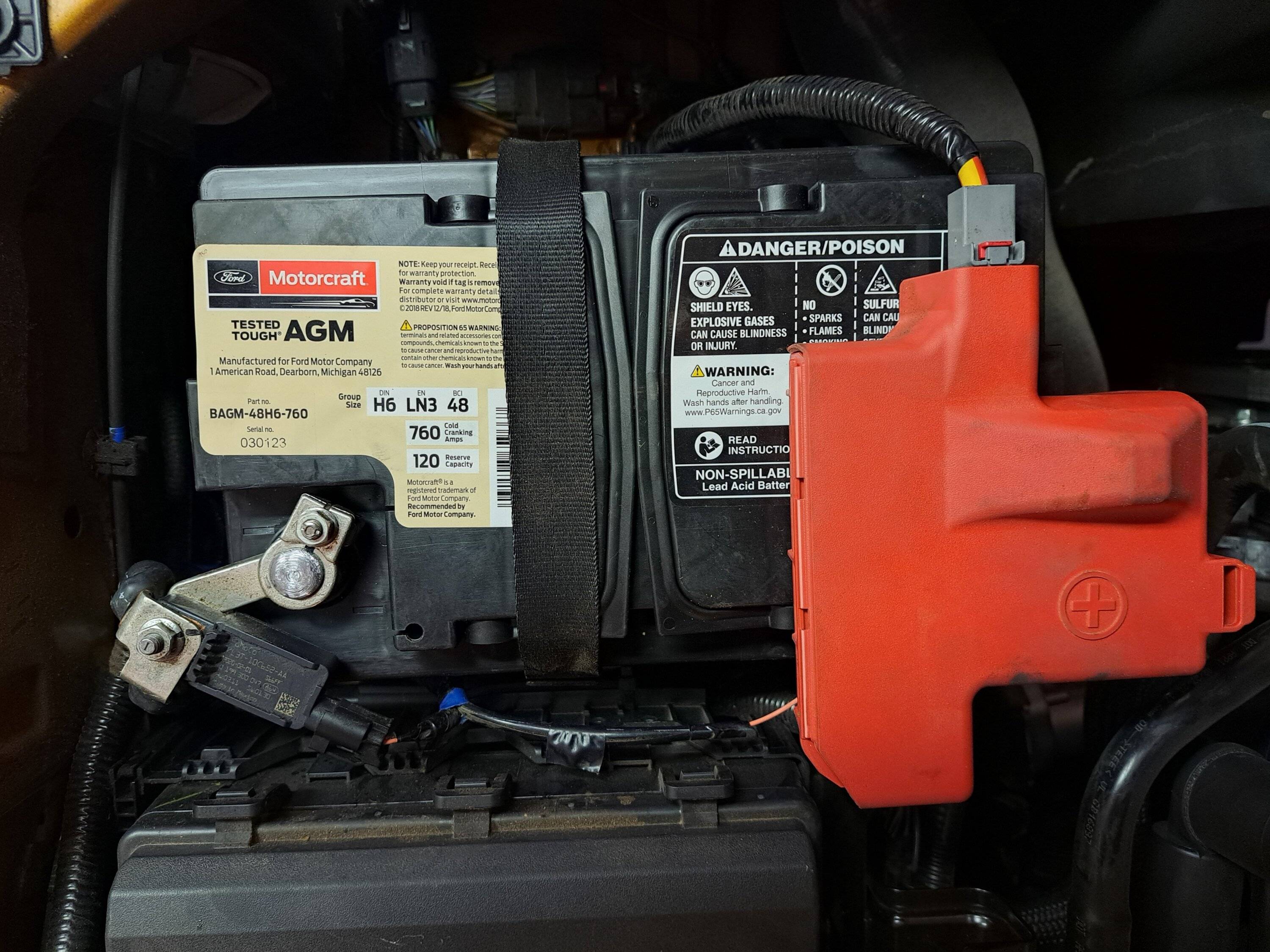

Hey @ryyck long time no see! I don't drive mine much either (maybe a little more than you lol) and most of my trips are short commutes. This really never gives the battery time to charge and while it's sitting there's quite a bit of parasitic drain on them. I started using a battery maintainer on my '19 after the first battery died in 18 months and that seems to really help. Taking it out for long drives is good too but sometimes it's not always practical to do. If it were me (and being that it's a 2019) I would replace it and then add a maintainer on it. Here's the one I use (and several others here use it too) along with the extension lead which make it way more convenient.
It's on sale now for Black Friday too.
CTEK Maintainer:
https://www.amazon.com/dp/B00CD44RQ...0W5WUIWA&psc=1&ref_=list_c_wl_lv_ov_lig_dp_it
Extension Cable: **Make sure you ground this to the chases and not the negative post.
https://www.amazon.com/gp/product/B00ADIHUVG/ref=ppx_yo_dt_b_search_asin_title?ie=UTF8&psc=1
Here's a battery many have purchased.
https://www.weizeus.com/products/we...otive-battery-140rc-850cca-36-months-warranty
Here's a post of mine showing where I grounded it and ran the extension wire. Don't mind the dirty engine bay. :surprised:

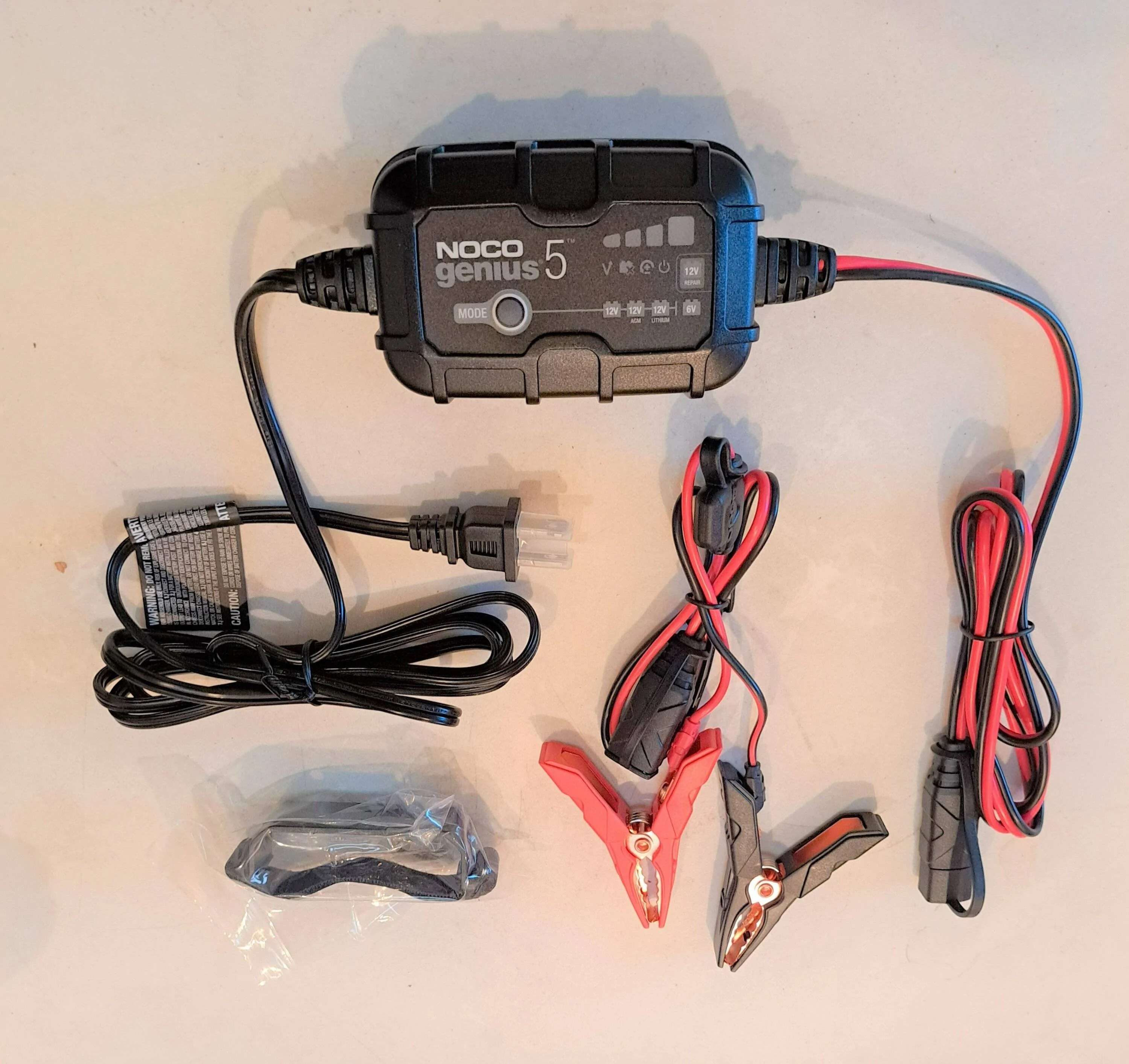

I had the battery tested yesterday. It tested good at a 48% charge. I was surprised it was an AGM battery. It's always cranked up without a problem. I picked up a NOCO Genius 10 and I'll charged it up. And I'll start driving the truck more often. Maybe that was the problem all along. All this information about memory and such is still valuable to know. Winter is here...
