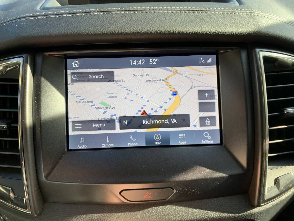

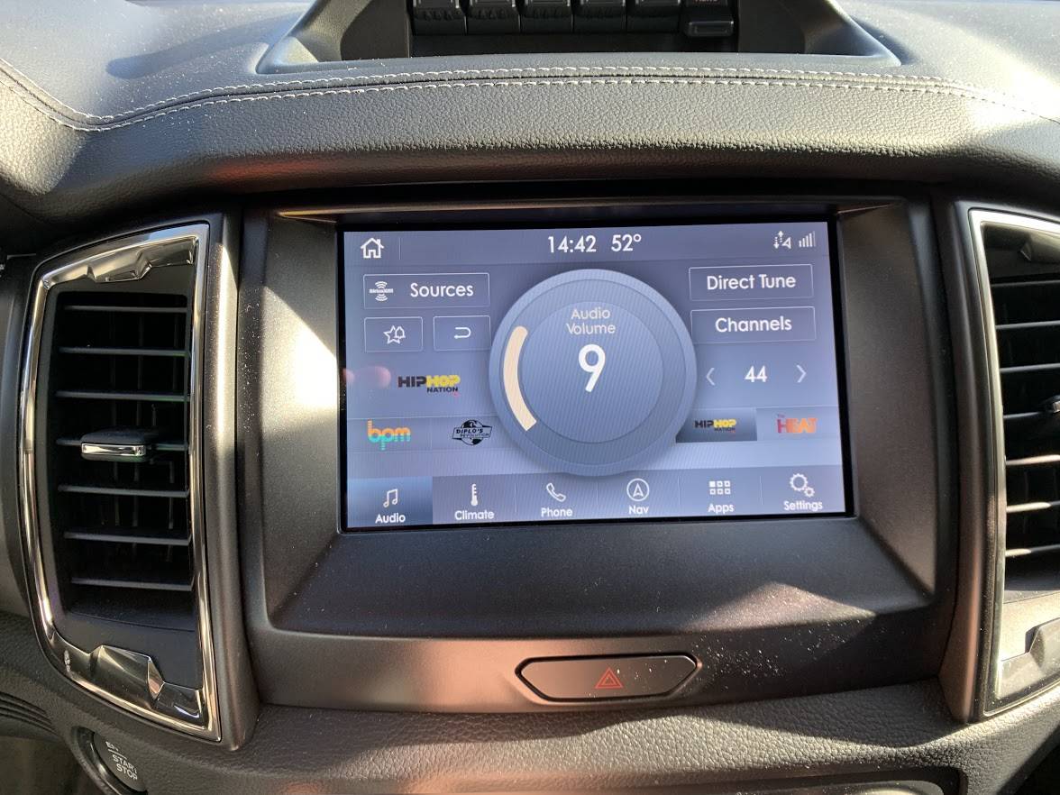

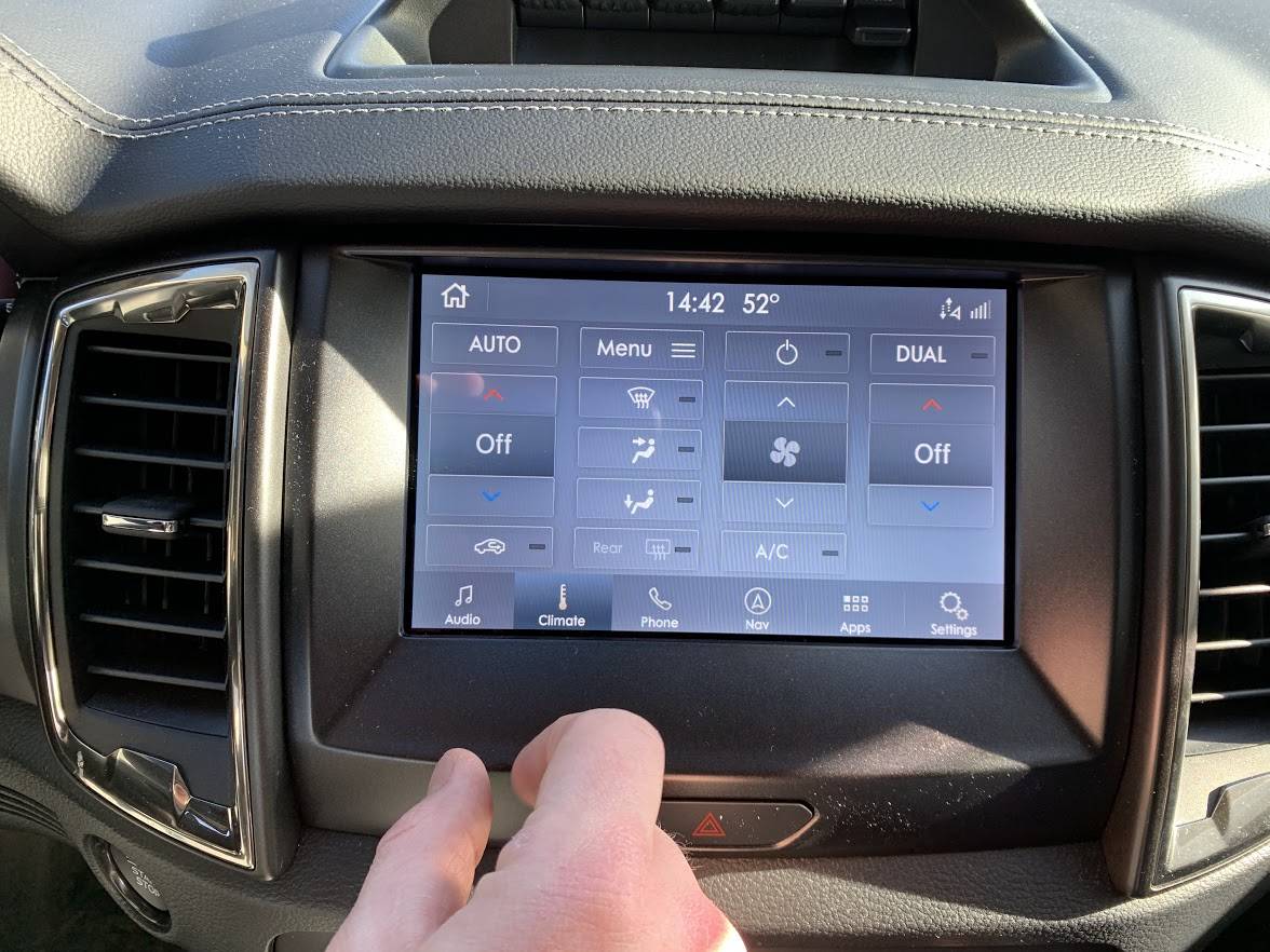

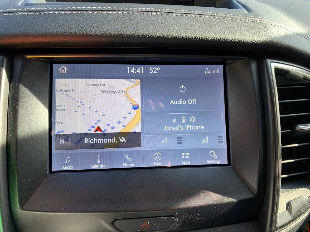

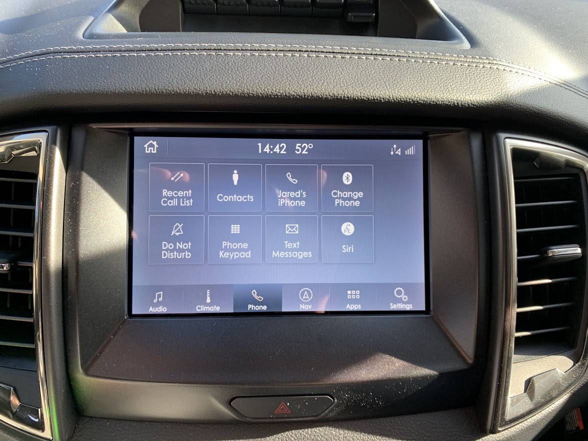

hello, My MY21 Tremor seems to have some potential changes. in addition to US style speed limit alerts, I am able to modify my climate utilizing the right steering wheel buttons.
I also have been able to configure my splash screen for startup and shutdown to always be the raptor logo.

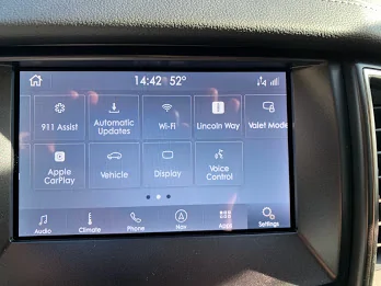

See the "Lincoln Next" theme i've managed to make stick.
APIM set “Brand” to “Lincoln”
Write
Set “visual design variant” to “Lincoln timeless”.
write
After ignition on / off, exited truck and locked it to confirm reboot. Upon next entry I had raptor logo, timeless theme and raptor logo at shutdown. This has stuck for a few hours&stop/start cycles already.

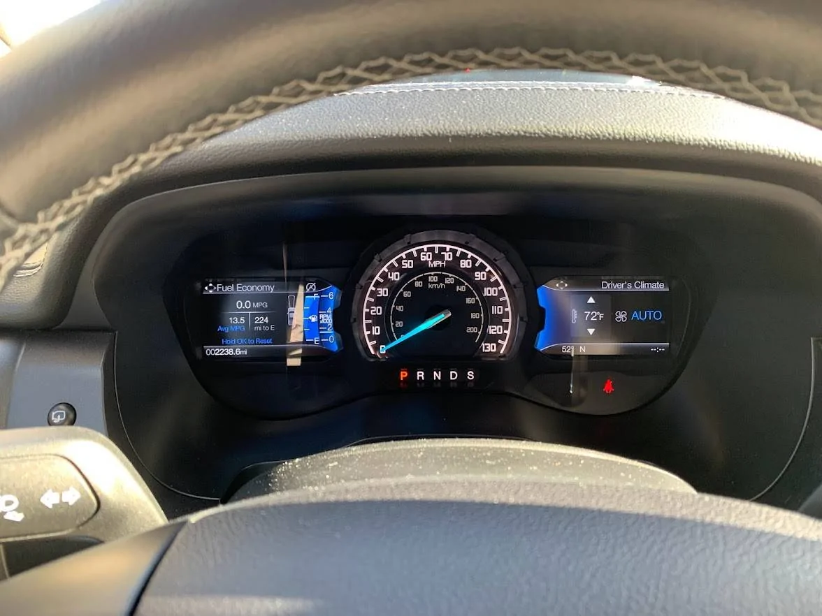

Update: I think I can manually shift while in sport mode now? Accidentally hitting the button on my shifter caused gear indications to show up on my LEFT dash display wish is abnormal. (I always drive in sport) I will confirm tomorrow

I actually did almost exactly the same thing last night on my 21 Tremor. I chose the Ford Performance splash with the cobra, however. The Lincoln theme is SO much better than the blue stock theme imho.
Write
write

I have always been able to shift manually with the buttons on the stick while in sport mode, however never seen the gear indicator on the left.

Yes the "normal" gear indicator is on the right screen. When you enter into manual shift in sport mode, it shows up on the left screen near the tach. I have never understood the reasoning why Ford decided the default for gear indication is off, until you hit +/- (which is the first thing I do on every drive). And why the normal indicator disappears in sport mode was also an odd decision. But I digress...

I have a Lariat Tremor too. The gear display in the right screen only becomes visable when you hit the gear shift lever toggle once. It disappears when you put it into sport mode. When in sport mode and you and go into manual shift mode a single digit for the gear you are in shows up in the left side screen.
