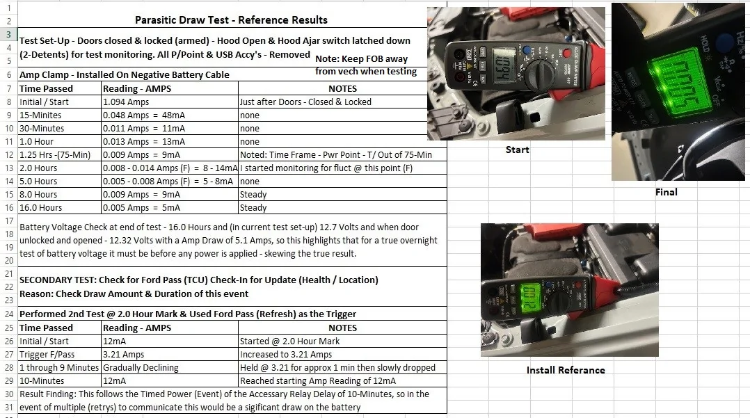

Curiosity got me wandering - so I did a quick overnight monitor of the system to find what is actually normal draw for the truck.
Granted - I forgot (1-Thing) as I did not note any TCU (check-Ins) while out at the truck.
I wish I would have (forced a refresh) to see exactly how much amperage is being drawn during those events.
Most specs that I can find are anything under 50 mA is normal to see with the engine off with 25 to 30 mA is the average - however I noted that it stayed under 0.014 mA after 2.0 hrs
I did have some fluctuation of readings prior to me actually recording them, but I wanted to ensure accurate readings after all modules should be asleep
Sometime between 5.0 & 8.0 hours - The Readings went steady @ 0.009 mA
The 75-Minute mark is important, due to the fact that it is a known Time-Out point for the console power points, that's why I made sure to check it at exactly 75-Minutes and saw the drop (live)
Granted - They were empty
Here is my reference results

Interesting,
I was getting .14 ma after an hour, the doors were locked but I didn't have the hood completely latched. I need to try again but do an overnight reading. I use a Fluke MM, which I borrow from work.
Appreciate your input, thanks

Interesting,
Did you mean .14 amps? That would be 140 mA (milliamps).
.14 milliamps is an extremely small value of current and is an unlikely reading for your truck.
Amps x 1000 = milliamps (mA)
Milliamps divided by 1000 = Amps
Some of the values being used in today's posts are off by a factor of 1000.

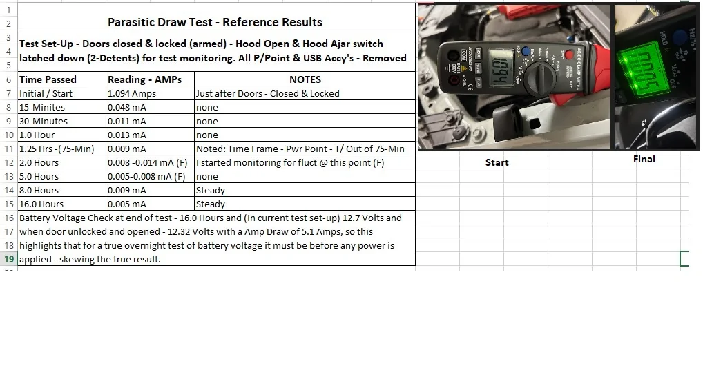

airline tech
Aug 24, 2022
4,525
8,622
Midwest - KS
Aircraft Tech
I updated the Test Results to include the (Ford Pass) TCU Check-In Results
