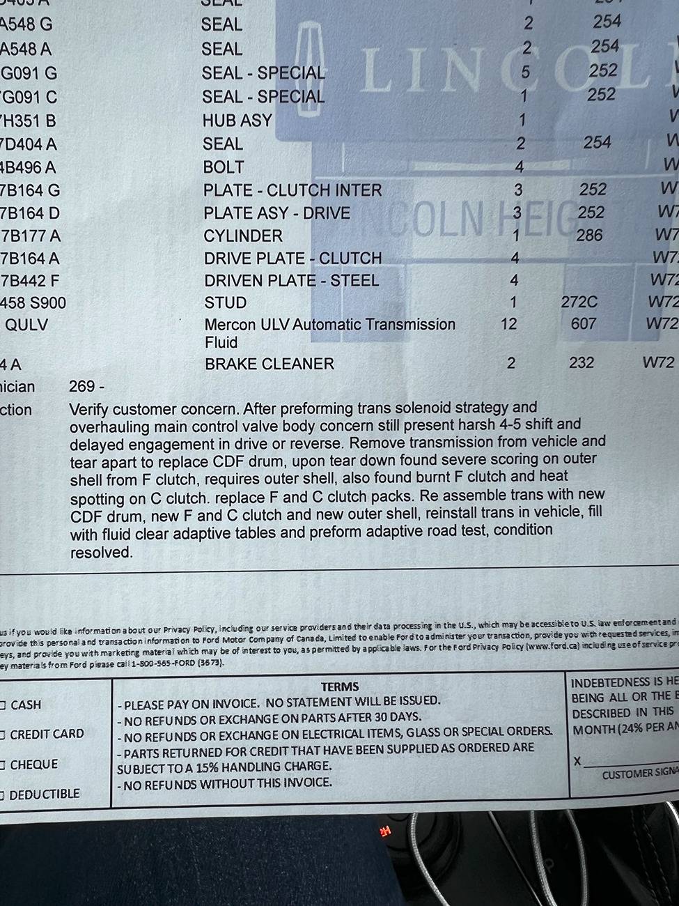

Pretty sure they started putting these in the production/warranty replacement transmissions not too long ago. Not sure if any of the 23’s got this though.

Here's hoping it's in my replacement ?
I do think they'll eventually get this right, they've got a beta tester pool in the tens of millions. Just would have been nice for it to have the kinks fixed before it went to market.

It should be, mine was replaced in June and quite confident that it has it. I messaged Flying Wrenches to see if he knew when exactly they started using them in production. He replied that he wasn’t sure but that they just started getting them from Ford parts for repair jobs and that usually doesn’t happen until after production starts using them.

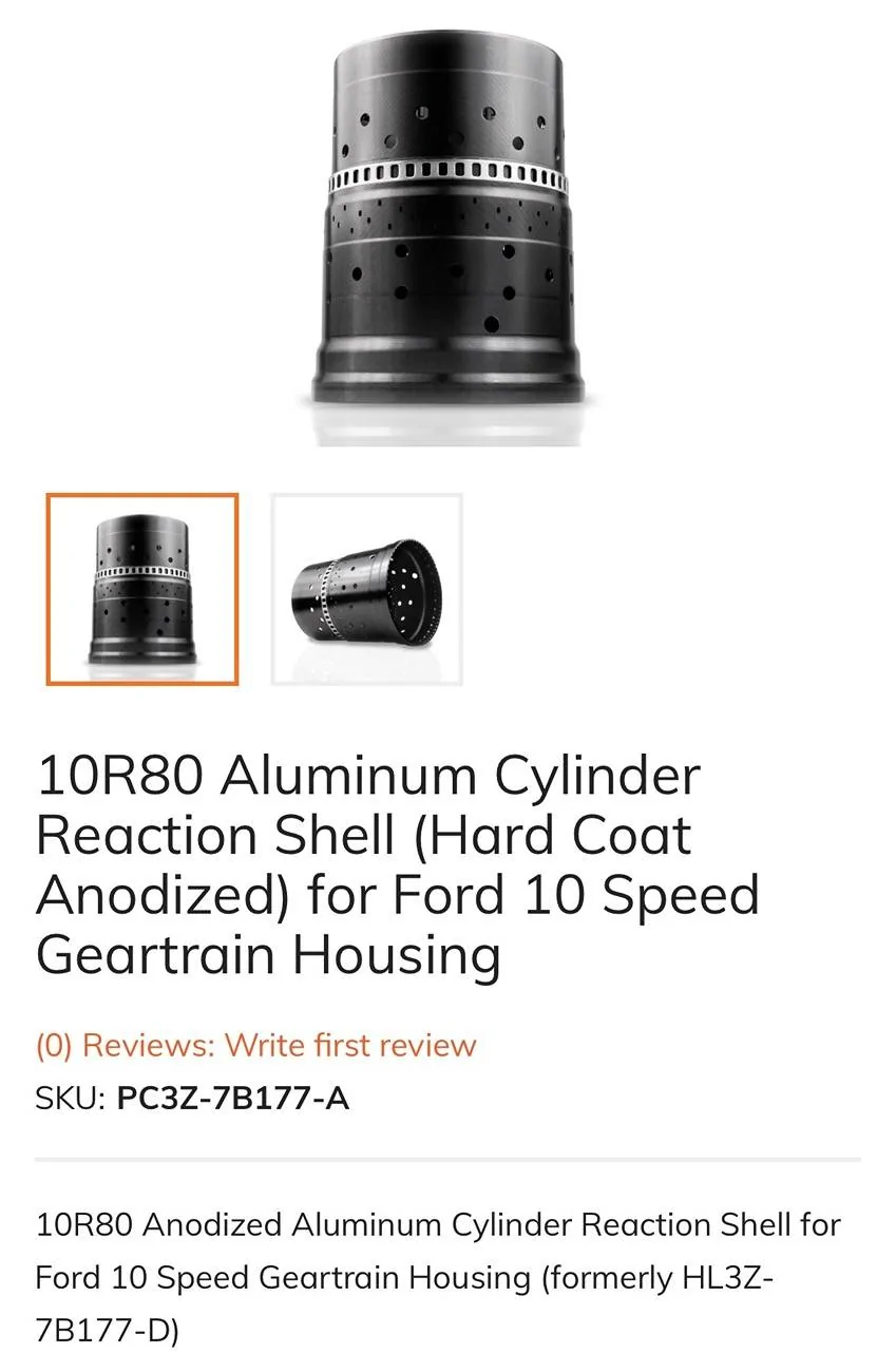

Ford CDF Part #JR3Z-7J351-B replaced the defective JR3Z-7H351-A origional.
In the Ford listing for the previous model number of this 'reaction shell' I find 'To ensure reliability, purchase Ford part # HL3Z-7B177-D CYLINDER.' pictures I found show a non-anodized silver unit but I presume the treatment is better. Seems like this part is part of the re-design.

Supposedly the anodized outer shell is in the 23 Rangers along with the updated CDF drum. And of course any replacement transmissions produced after that.
