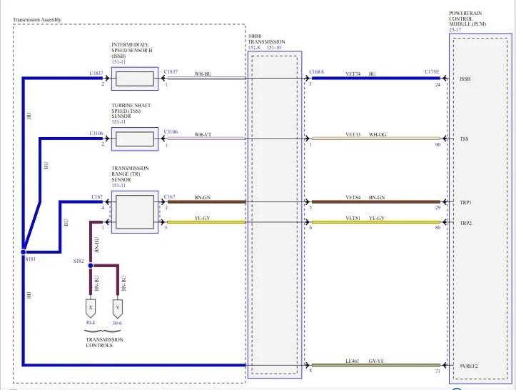

I would check the MAP Sensor and Circuit as well as the (Diesel Variant of the DPFE is the DPF) and circuit.
With it shifting to (neutral) and (downshifting to 1st) on its own
I would check this circuit for the 3.2 with the 6R80, it should be similar except you have a TCM in the system for the transmission - the US Version uses the PCM for Transmission control.
Note: This is for a 10R80 and this uses a 9 Volt (VREF) circuit
Your mentioned issues Buck/Surge - Shifting to (N) etc may tie into this specific VREF Circuit

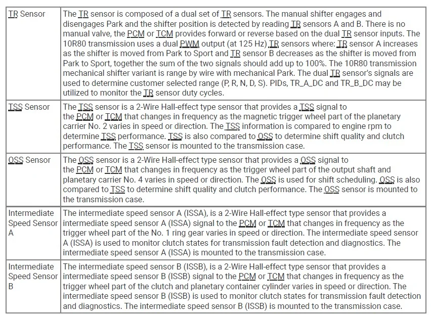

Take a look at the (2) TR Sensor PIDs A&B, anything look abnormal?
Plus you might try checking on the selector cable adjustment, it may be slightly out of adjustment.
Should be similar to this: Note the (100%) Total above (TR Sensor)
Note: PWM = The Duty Cycle (PID)
Again - I have a hunch that your issue is here and needs to be checked.
Thanks dude I will check that later today , that's real helpful 👍🏻

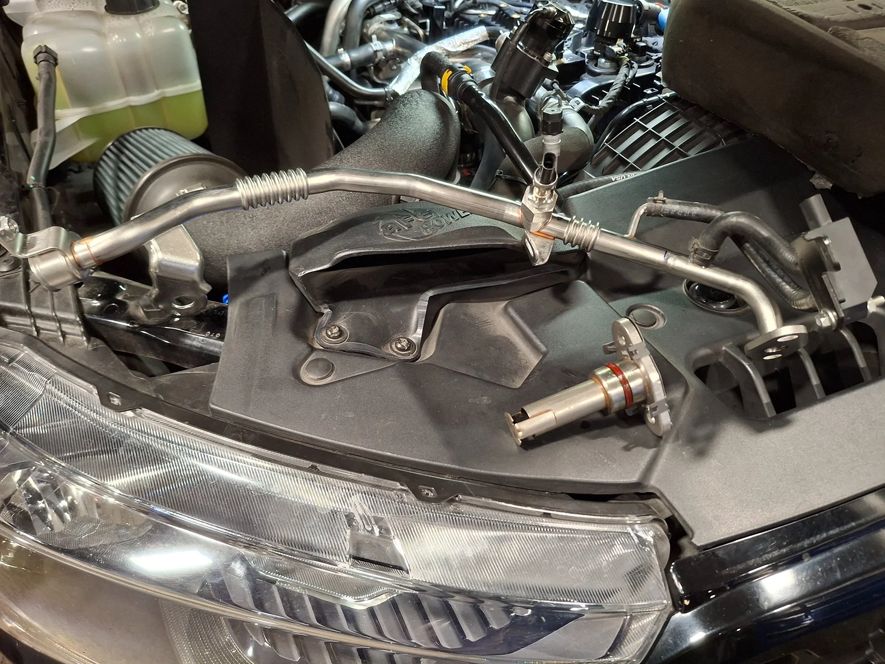

Decided to replace the EGR tube assembly like ford recommends for the surging issues, notice the small fitting in the picture goes inside the intake manifold (make sure to clean this )
Just curious, but where did you find the info that Ford recommends the EGR tube replacement? Is it available in a document (TSB)?

That came directly from Ford tech line, we had two rangers here that received transmission replacements and still had the surge/bucking issue, after sending tech line live data they recommended egr tube and egr sensors to be replaced due to moisture in the tube causing sensors to read out of spec
Curious if you can fit a borescope inside the old tube and inspect the orifice area for buildup and blockage

Update, ran my bore scope down the tube and saw no blockages with normal EGR buildup until I got to the small hose for the DPFE sensor which had quite a bit of buildup on it (50 % blockage) at this point I do not believe the tube replacement is necessary, but I would recommend cleaning both dpfe sensor ports
Just so I understand, the small hose had the build up, not the tube or the tube bungs.

correct, find something bendable and ream the inside of the small hose for the DPFE port on the tube assembly
