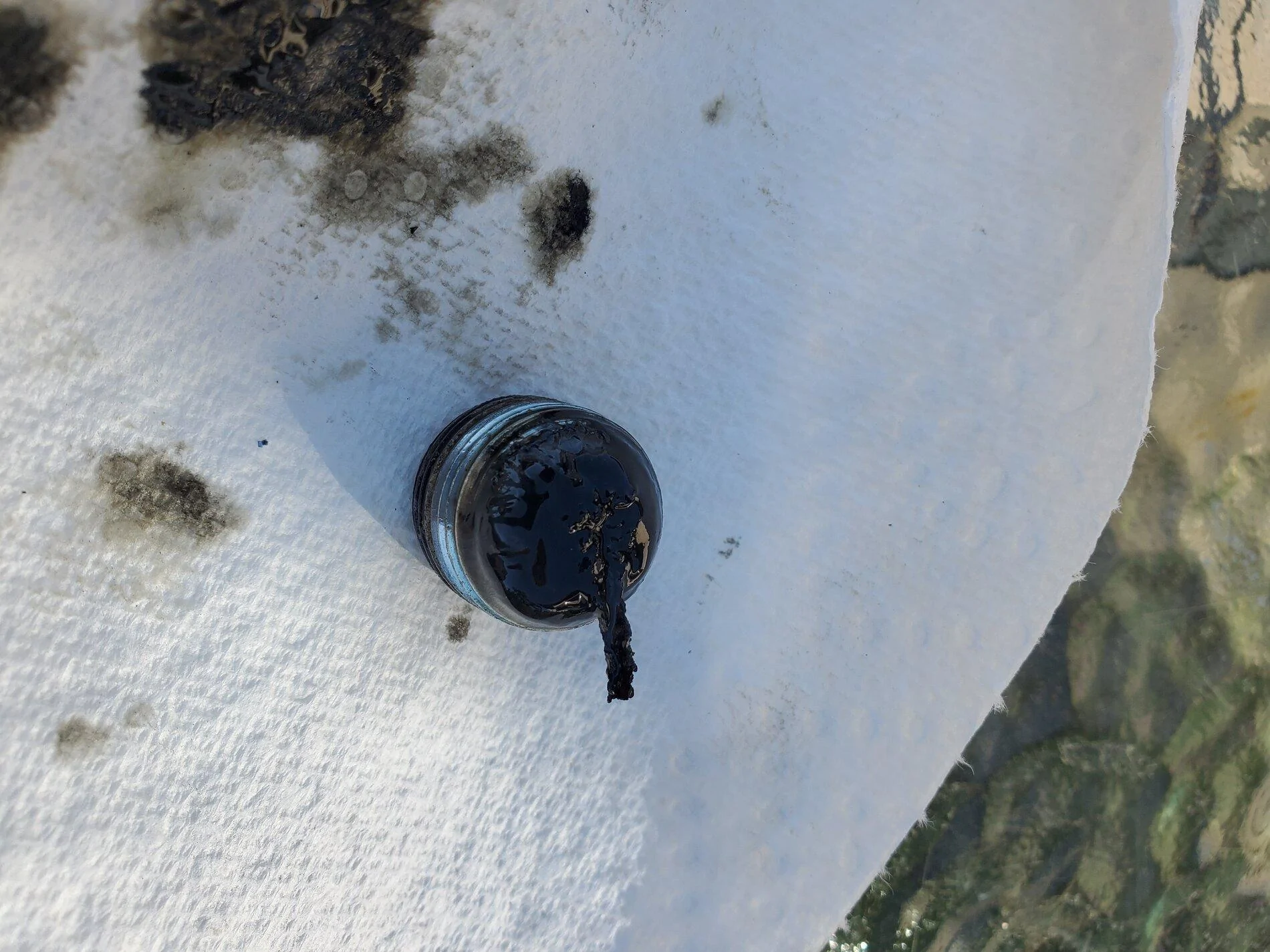

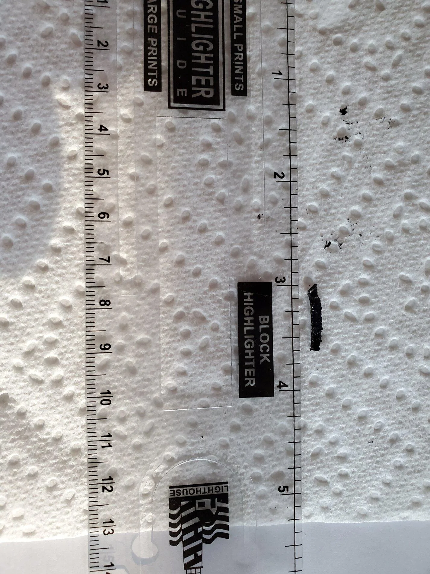

Add me to the list of people who changed their rear differential fluid and found nasties. 6200 miles and should have done it sooner. Dark and found a 5/8" long machining chip stuck to the magnet, some other fines in drained oil. I worked in a machine show while going to school, so I know what a machining chip looks like.
At least it was on the magnet.

Agreed fine, emphasis on fine, is normal break in wear. Still it is good to get it out. 5/8 inch machining chips are not normal and should not be in there. Too many have been finding them.

5/8" machining chips? I call bullshit. Show the photo's and I'll believe it. Until then... it's bullshit.
No way that makes it through Ford QA in the modern era.
Look at post #52! That's what came out of my rear differential.

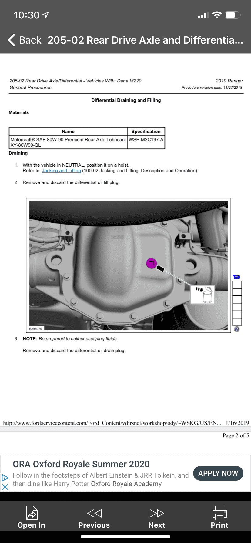

Gotya. Thanks. One more question. The manuals say to throw away drain and fill plugs on the axles after replacing fluid. Is that right? Feel like you can reseal them no?
Can you post the full PDF for the Rear Differential if you have it? Thanks!!
