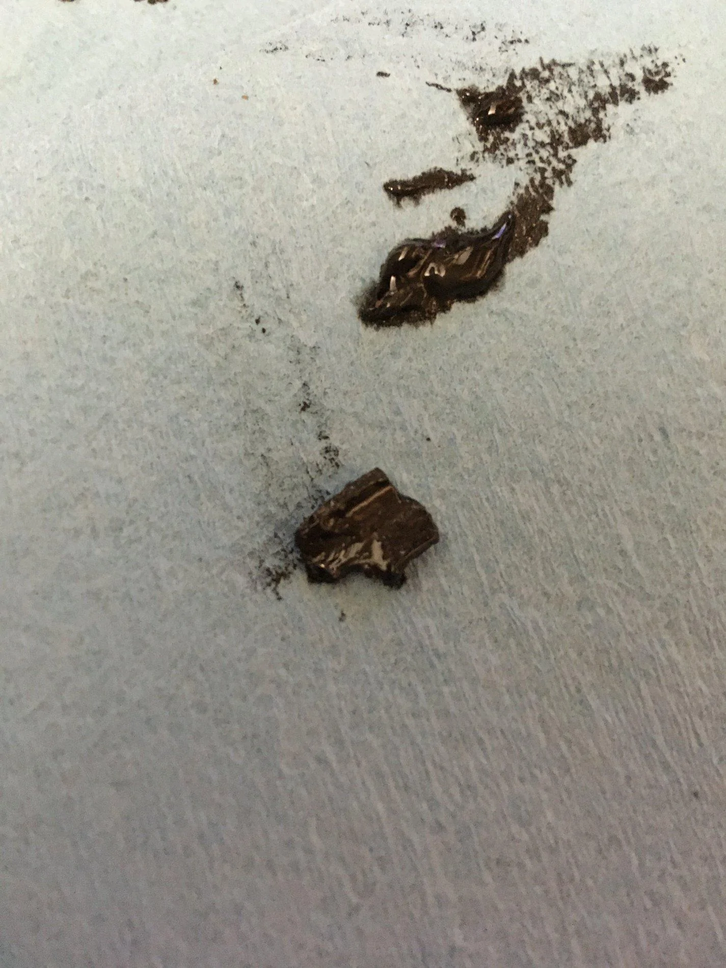

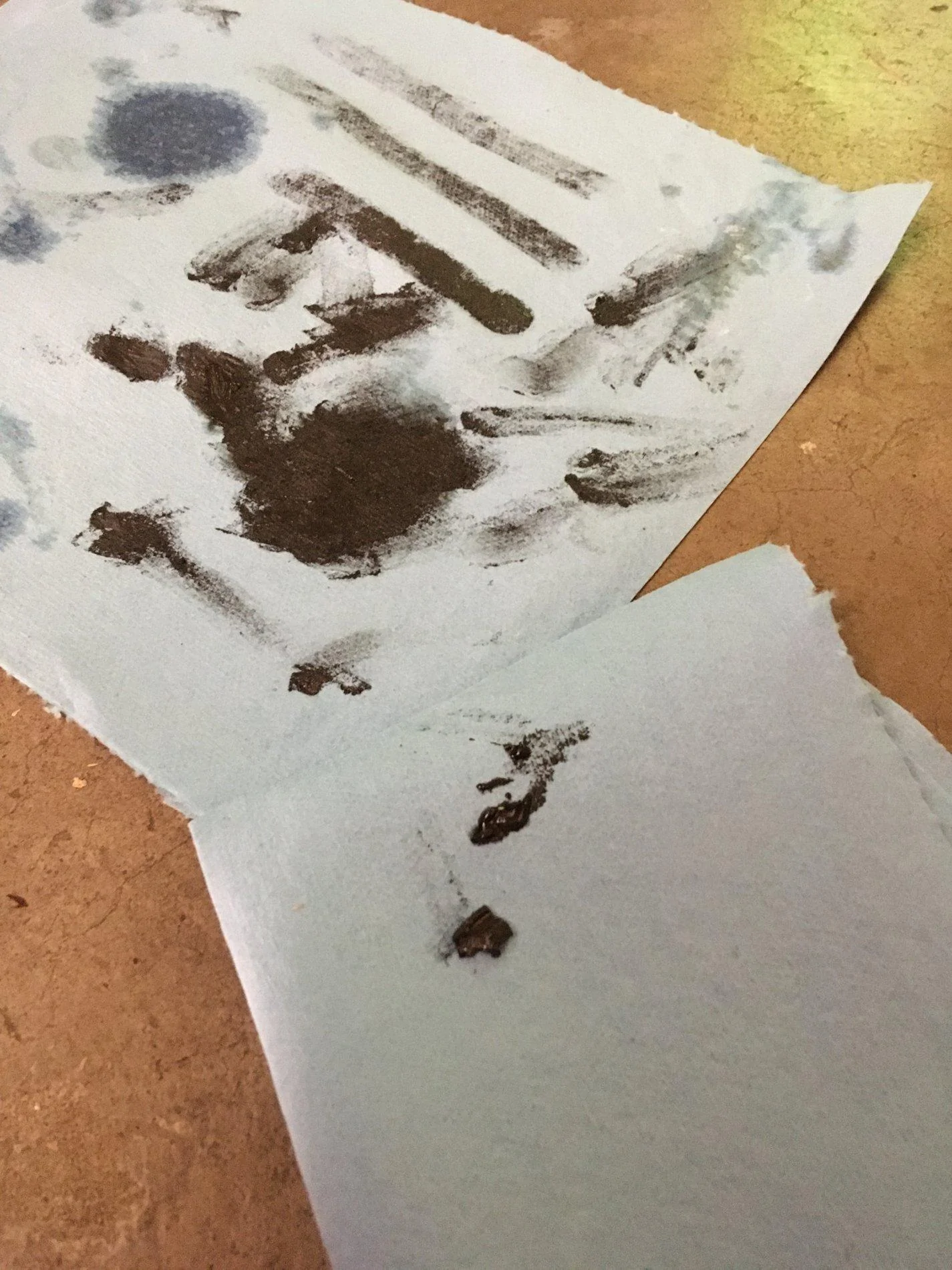

Add me to the list of people who changed their rear differential fluid and found nasties. 6200 miles and should have done it sooner. Dark and found a 5/8" long machining chip stuck to the magnet, some other fines in drained oil. I worked in a machine show while going to school, so I know what a machining chip looks like.
At least it was on the magnet.

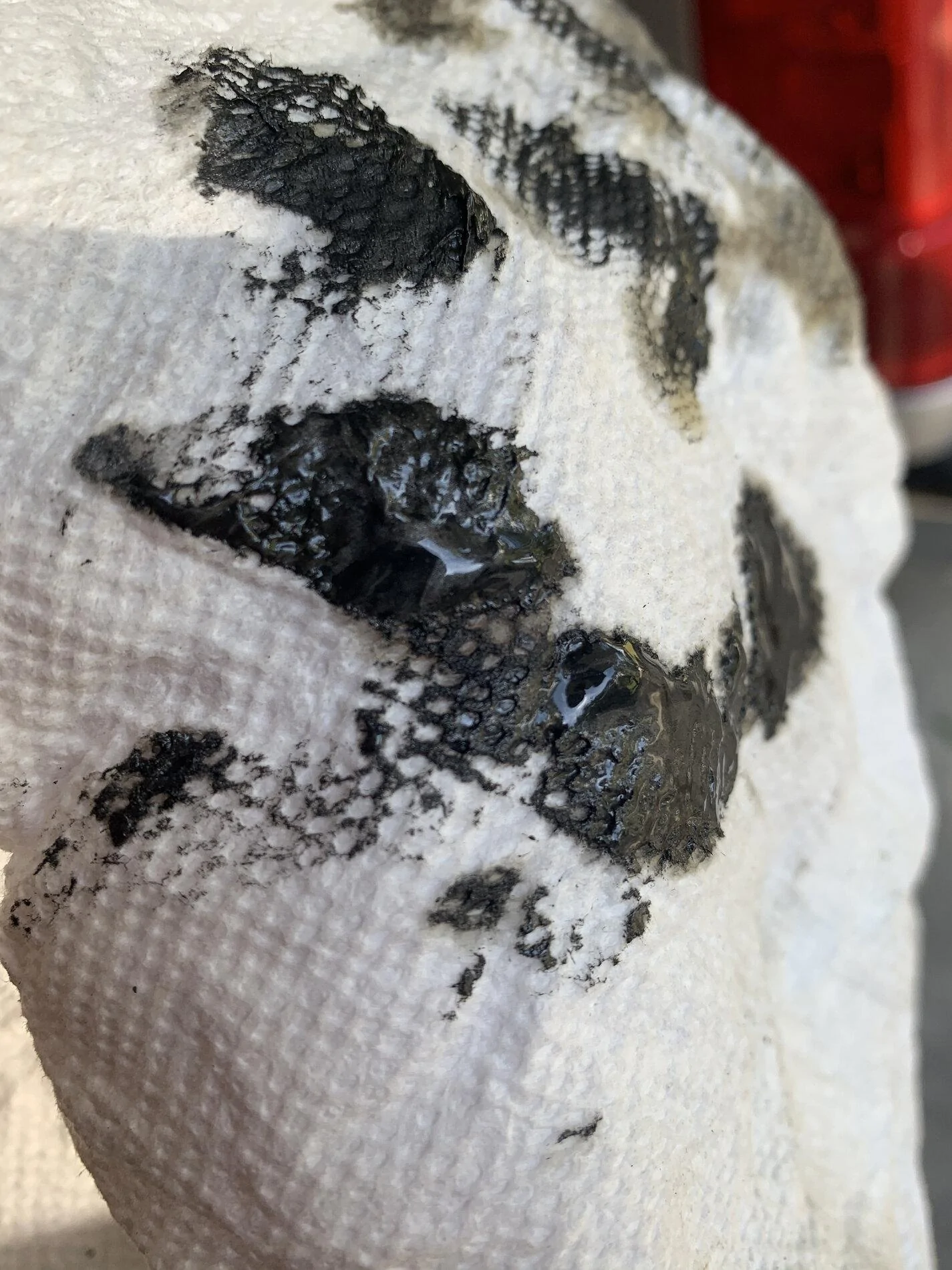

So decided to change the fluid on the front and rear differentials at 25,000. Front was clear with a slight purple color(I use royal purple). So the front is doing great and I honestly just wasted money. The rear however came out black and with a big chunk of metal. I’ll show pics.
