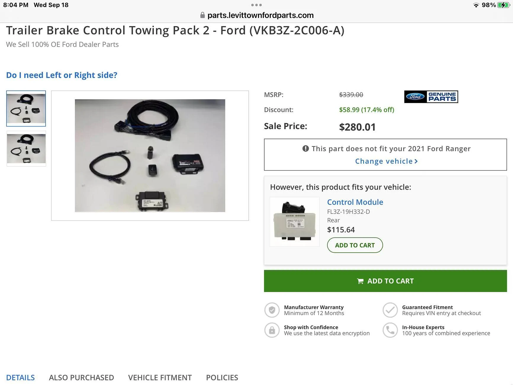

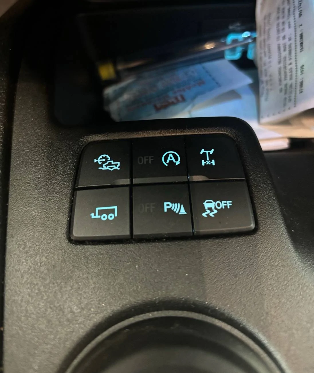

I do have the tow package but only the 4 wire plug. It has the towing button on the console.. As I said I just want to add the 7 pin plug. And have trailer braking available..
The part number that was posted from for also said it’s not compatible..As I said I have the control module behind the glove box.

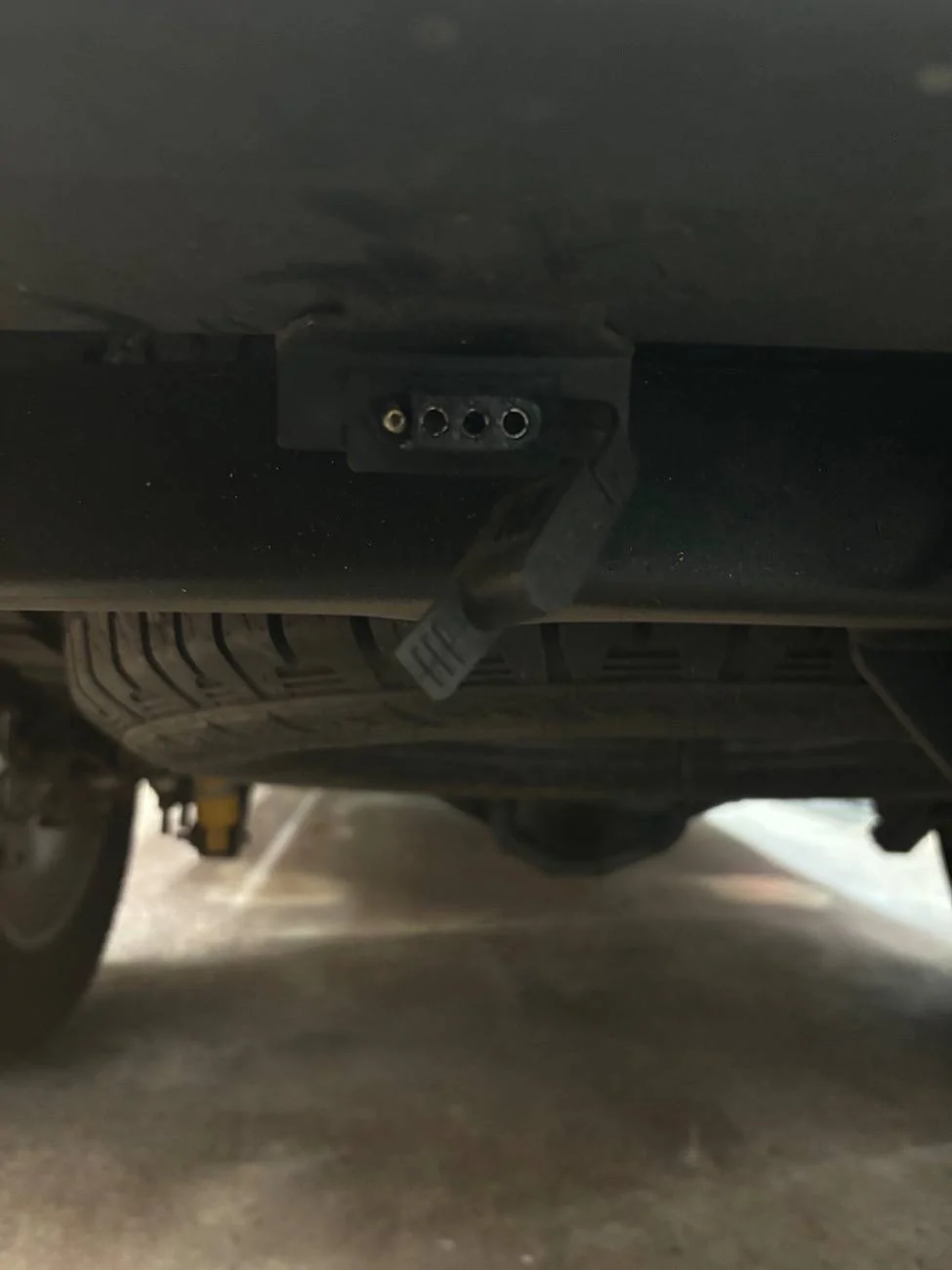

But does it have the hitch reliever (square) at the bumper or do you only have a hitch ball cutout in the bumper?
That Tow/Haul switch means nothing to the Tow Package- all Rangers have it.

Hitch ball cutout in the bumper. I installEd a class 3 hitch.

Ok so why can’t I add the Ford brake controller Along with the plug and the wire harness?
Ok - tow guys confirm but he is still limited to 3500 lbs - correct, this is why there is not a 4/7 - Thus Non Tow Package
As I posted above- for some reason, Ford lists it as effective for 2022-2023 only for 2019-2021 it directs to the TRM. It appears to be on Backorder or Out of Stock throwing a wrench into getting it.

as you suggested I’m going to as Benny to see what I can do..

A lot of confusion here. First I have never heard of tow package 1 or tow package 2, just with or without tow package.
All 5G Rangers have the tow/haul switch, the anti-sway setting in the IPC, the tailer blind spot settings in the IPC and the 4 pin connector. They are limited to tow 3500#, because that is all the bumper is rated for.
With the tow package gets you the, I believe a class 4, receiver hitch and the 7/4 pin connector. I have heard rumors that the front axles on 4X4s are also different, but I cannot confirm. The tow package increases the tow rating to 7500#. This is because of the frame mounted receiver hitch. There are no other drive train/chassis changes. A brake controller is not included.
What this means is you can install the 7/4 pin harness along with an aftermarket receiver hitch and a trailer brake controller and be rated to tow what ever the hitch is rated for up to the 7500# rating of the truck.
One last thing, I beleive the Ford recommends the trailers without brakes be limited to 1650# and I know that state regulations vary, but some are as low as 2000#. So, even the bumper hitch requires them.
