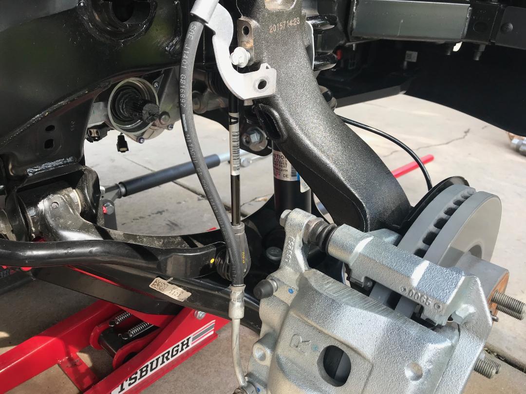

I see you also removed your sway bar link - that really makes things much easier. I went one step further and took off the caliper and rotor so I didn't have all that weight fighting me while I attached the upper ball joint. An extra step, but worth it.
Yeah, pretty easy job with the correct tools and taking the proper steps.

Driver's side went easy, passenger side knuckle came apart. Spent 5hrs trying to get it back together before I said "F it" and went to the dealership. $329 later, the passenger side was done.
If I were to do it again, I'd just take off the axle nut and remove it to give plenty of wiggle room.

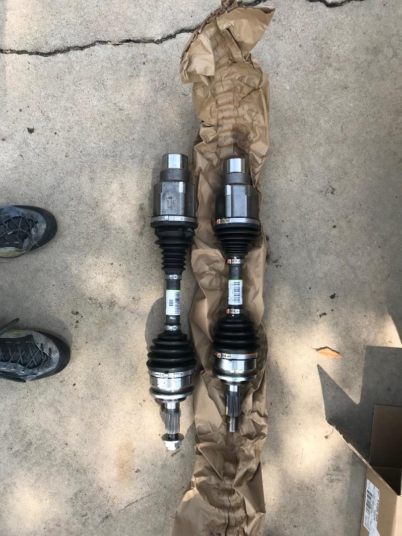

I just did my driverside. Mostly. I thought I had the axle completely free, but it came apart from the engine side. Boot is fine. It's just pulled out. Can I fix that?

You can try. Look up a couple videos. You need to align it and start rotating the rotor. I couldn’t get mine

See this link for a picture: https://www.ranger5g.com/forum/threads/cv-axle-shaft-damaged-after-installing-fox-stage-1-lift.4942/
Apparently those bearings can fall off into the boot when over extended. That is the inner side BTW.
Edit: If there is no clip that broke or fell off, then you might be able to finnagle bearing back on and get it all back together without taking boot off. Maybe even pull axle off the truck as one last ditch effort.
Im starting to think there isnt a housing clip to hold the balls in, because of how easy its sounds to separate.

My boot is fine and all. Feels okay. I'm gonna try and ram it back in and hope for the best I guess.

I just did mine yesterday and as I mentioned in another thread, the primary reason I could not get my axle to pop back into the joint was that the boot had an air tight seal so when the axle was pulled out of the joint and extended away, it created a vacuum effect in the boot which caused the boot to collapse inward. This effect was keeping pressure on the bearings in ways that wouldn't allow them to align to the joint when trying to push it back in. All I did was lift up carefully on the main boot clamp and heard air rush into the boot and it immediately poofed back out to a normal shape. After that, I got it popped back in within 5 minutes of carefully trying.

I'm great. Muscled it in with no problem and been harsh AF on the truck since.

quick question for you guys: i have read that if you remove the cam bolts (bolts attaching the lower control arm to the frame, also, you need to place marks on where the alignment cams are, ) then, there are no issues removing the struts and there is no risk of the axle coming off. there is a video of one member doing this and it seems so much easier and safer. how come no one is trying that methodology? just asking since i am next to do this project. see below:

i did exactly that today. never a concern with the axle. it took me 3 hours. driver side 2 hours, the passenger side was much faster. i am getting an alignment tomorrow and saved myself some $. around here all shops i spoke with wanted $500 plus for the install.
