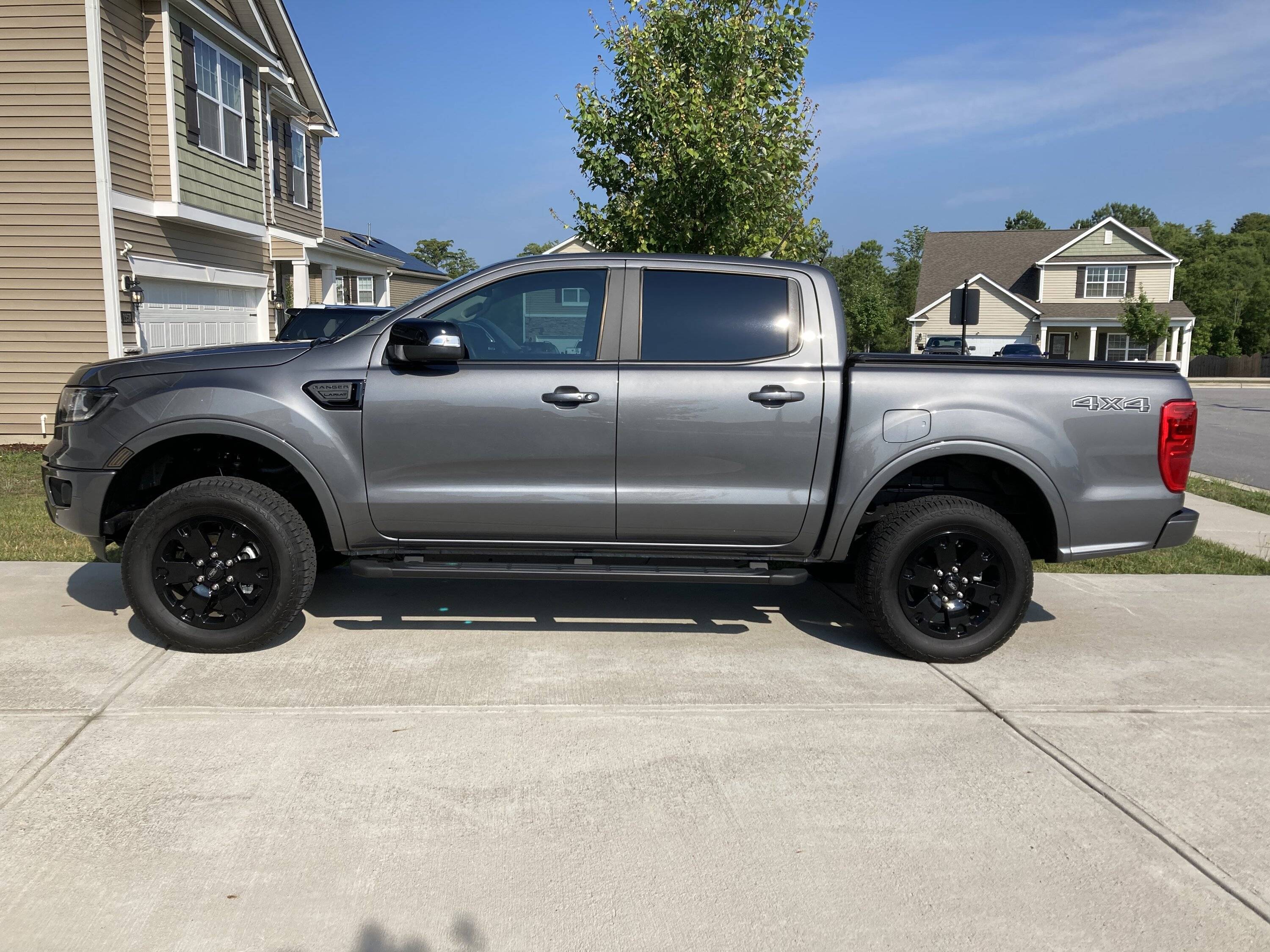

Did the front struts yesterday - was wiped out and haven’t driven a lot yet, so can’t give a solid report. First driving felt very nice though, firm but planted. Diving during braking is gone.
I bought axle nuts from Ford ahead of time to replace the fronts while doing this upgrade, so had no cv joint issues.
The most challenging part was rebuilding the spring assemblies. Didn’t see anyone mention that on here, but it’s no joke compressing the spring enough when adding lift to the strut.
If ever doing this again, I would likely either purchase a more expensive kit that is already assembled or take both assemblies off and bring to a local shop to have them assemble.

Picture from this morning, my driveway has a slight pitch. Stock tires 265/60/18
