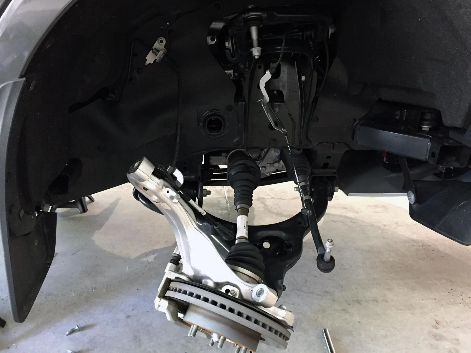

Just did my Fox 2.0 kit, axle nuts come off, see pic.
I see you also removed your sway bar link - that really makes things much easier. I went one step further and took off the caliper and rotor so I didn't have all that weight fighting me while I attached the upper ball joint. An extra step, but worth it.
