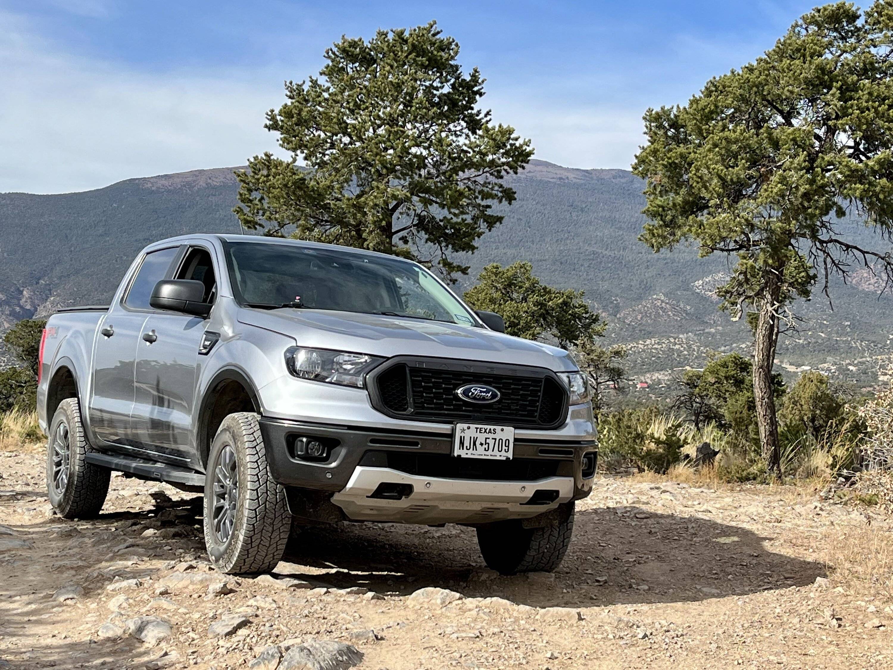

Bilstein 6112 up front set at 0.8" higher than stock. 5100 in the rear. Trashed the FX4 shocks. 1 1/2 years and they ride great. Do not follow video instructions from Stage3. Here is a link to Josh Mills removing the front struts. If you do it like this, then you will not put any stress on your drive shafts.

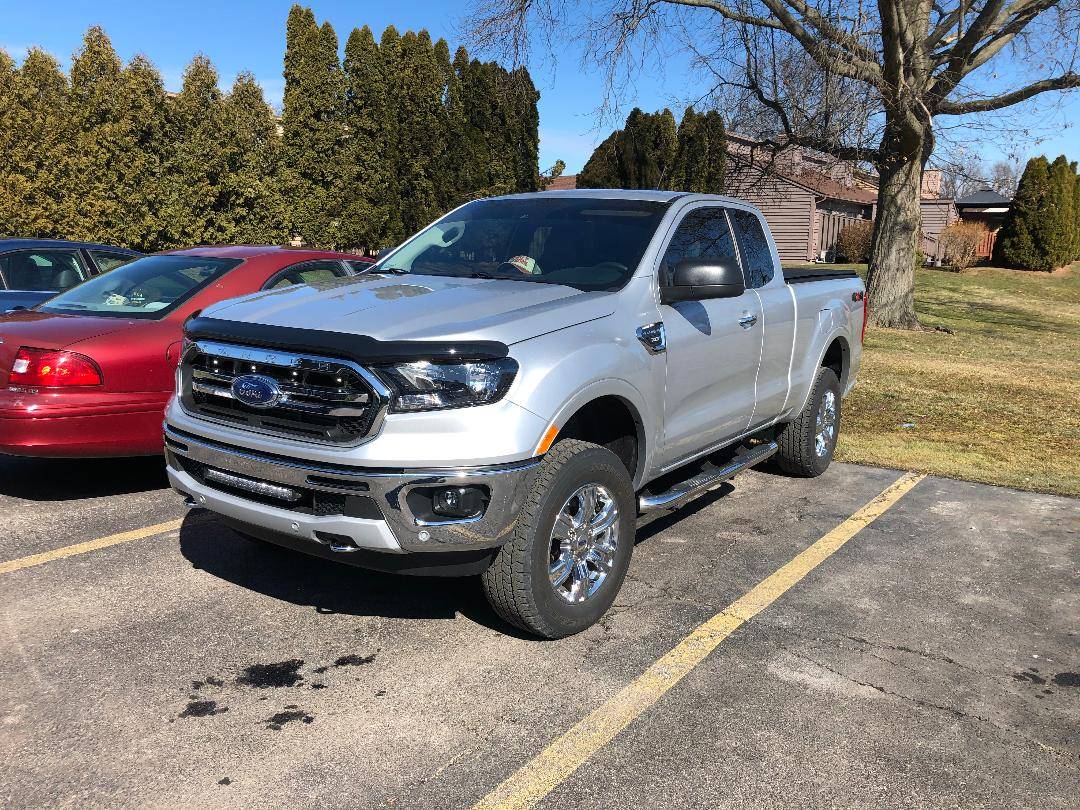

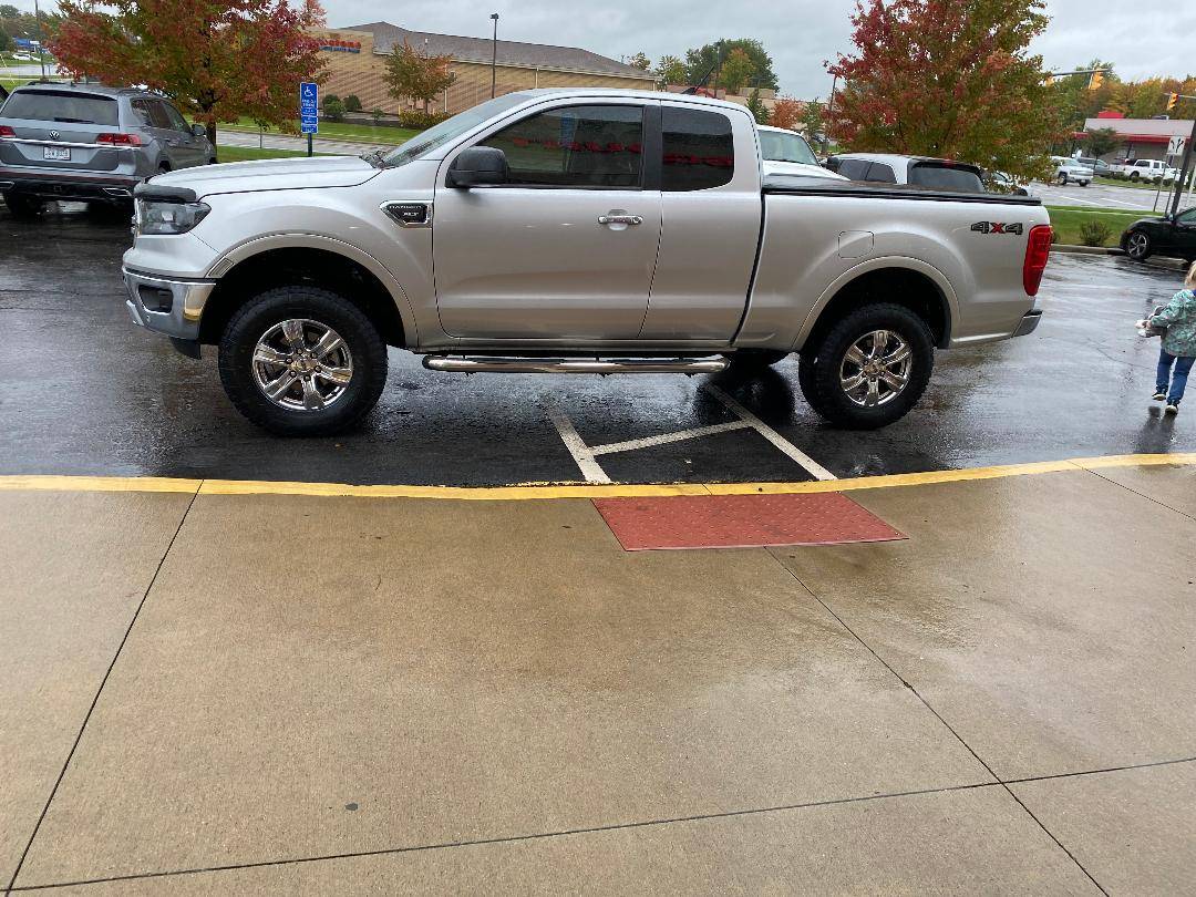

Distance from top of tire (265/70/17 on 17x9 wheels) is right at 7".
Rear is right at 8".
The rear is stock but I remember that it actually came up about 1/4 inch when I installed the Bilsteins.
I'll get a pic later today.
