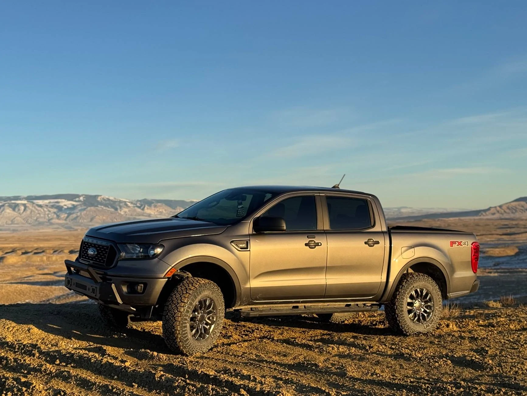

Thanks for the input everyone. Got the 2” RC struts mounted up with the ReadyLift Anti-Intrusion beams and some Kenda Klever R/T 33x10.5” tires. Super happy with the way it turned out! First drive today on my way to work, truck rode smooth and lane assist/auto dimming lights worked as they should. According to my GPS the Speedo was off by about 3mph at 70mph and barely noticeable around town at 25-30mph. Install on struts and crash bars was a bit of a pain, especially when the driver side CV pulled apart, but I managed to get it all back together and so glad to have the truck look halfway decent now!
