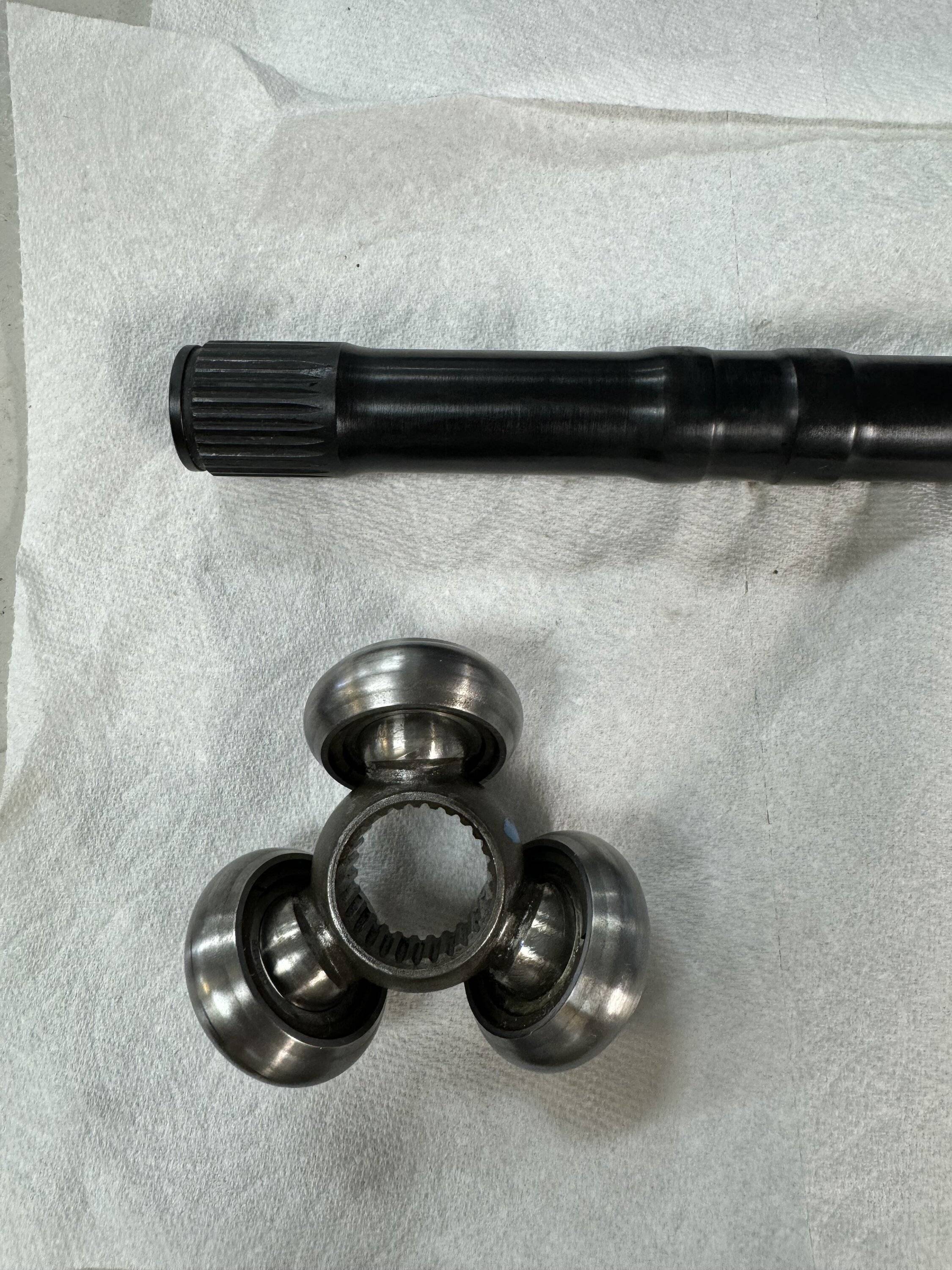

For the peeps that have the Baja kits long travel did your cv axle shaft not fit into the tripod bearing? Or did I get sent the wrong cv shaft. The shaft is too big where even tapping it in won’t work

Are you putting the tripod on the correct side? And the tripod bearing goes in one specific way. I’m guessing you tried flipping it around.

Yup! Did it both ways and still doesn’t make sense how it can even fit. I’m going to email them because my guess is that it goes to a f150

Did you happen to measure the new shaft to see if it was 3” more? If it’s an f150 shaft, it will definitely be longer.

I could measure it but that requires my oem shaft to be stripped 😂. I’ll google the length of the oem shaft. Do you know if they give the exact length of the shaft on Baja kids?

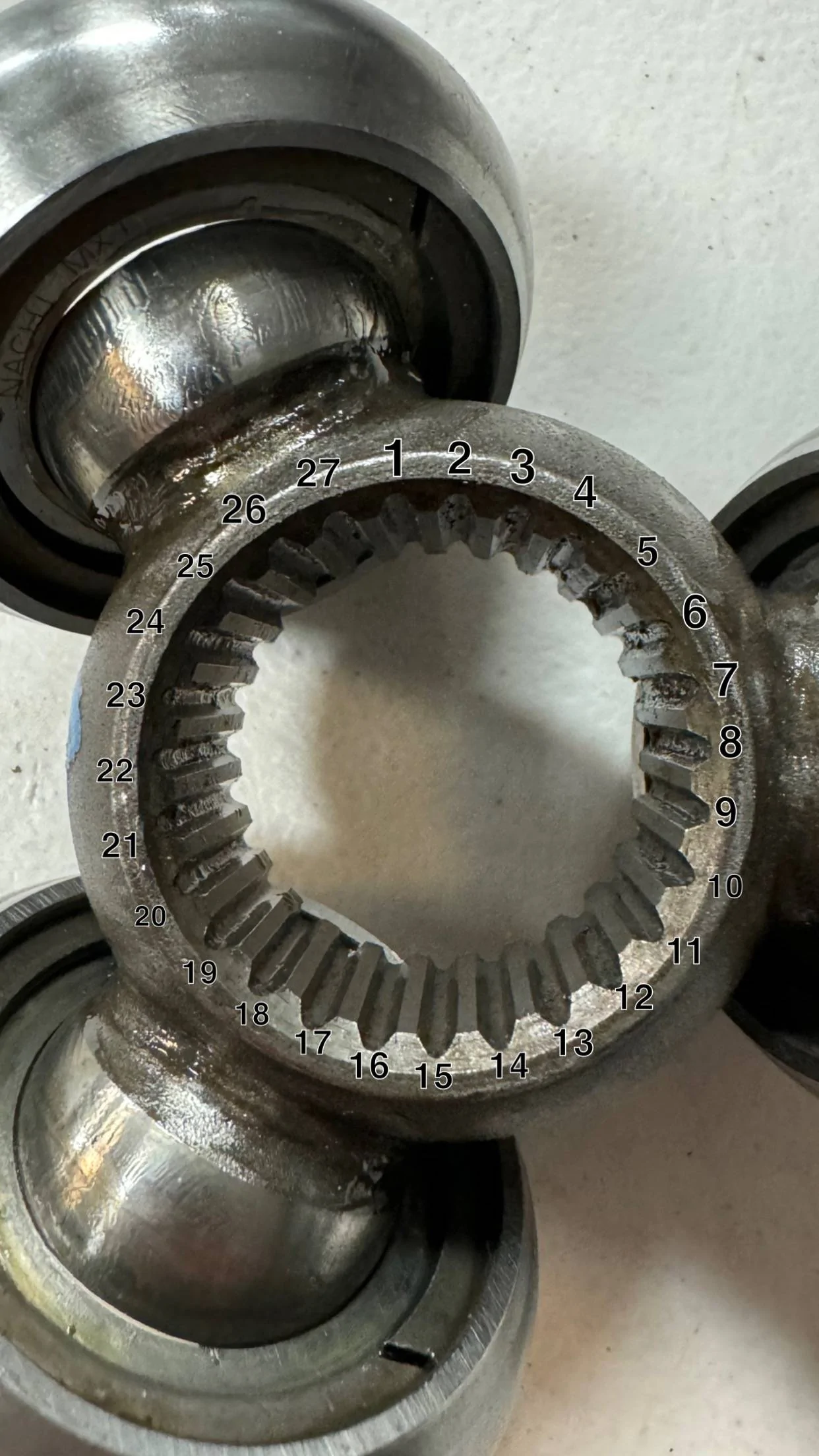

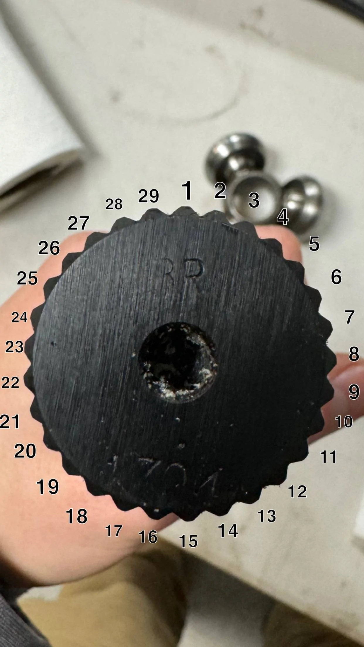

So I did some counting…..
The tripod has 27 grooves
The cv shaft has 29 spindles on both sides
Do I machine press it in? 😂
Going to definitely email them

aww man so they are different, well that’s a bummer. Now ya gotta wait for the correct pair. Hopefully they give ya a little percentage back of what you paid for the inconvenience.

I'm pretty sure the bearing style has the correct spline count for those shafts. I've seen on other post that the tripod and 8 ball bearing cv's are different in that aspect. I'm sure baja kits built the axles for the 8 bearing style cv

I got my new one from Baja kits and they confirmed it was the wrong one

We got it all token care of. They sent the wrong cv shaft
