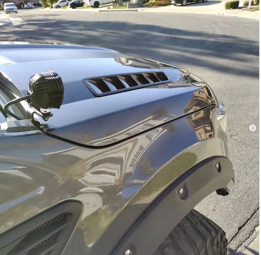

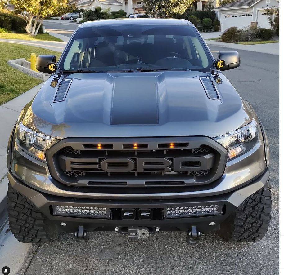

Speaking of cutting holes. I found a ranger on Instagram that installed some 2014 Mustang hood vents on his Ranger and it looked like it should have been there from factory. Insta profile is @robo_mods
I already planned to do this (though I am doing a different install location), I just had not mentioned it yet till I settled on a design... :lipssealed:
My plan was to do the larger Raptor style vents on the raised portions of the hood.
Oh that is nice

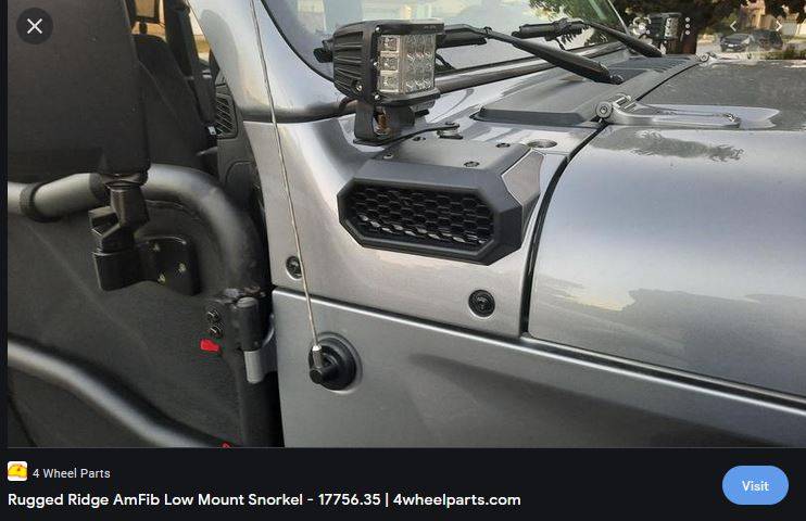

Jeep has a snorkel kit that you can remove the snorkel tube and keep the fresh air bottom section.
That is kinda of a cool design. I like the idea of a snorkel, but HATE the look.
Actually looks great!!!!
Saw this also. First thought was one good rain storm and things are gonna get fried. Open hole right above the main fuse box, probably not the smartest move.
