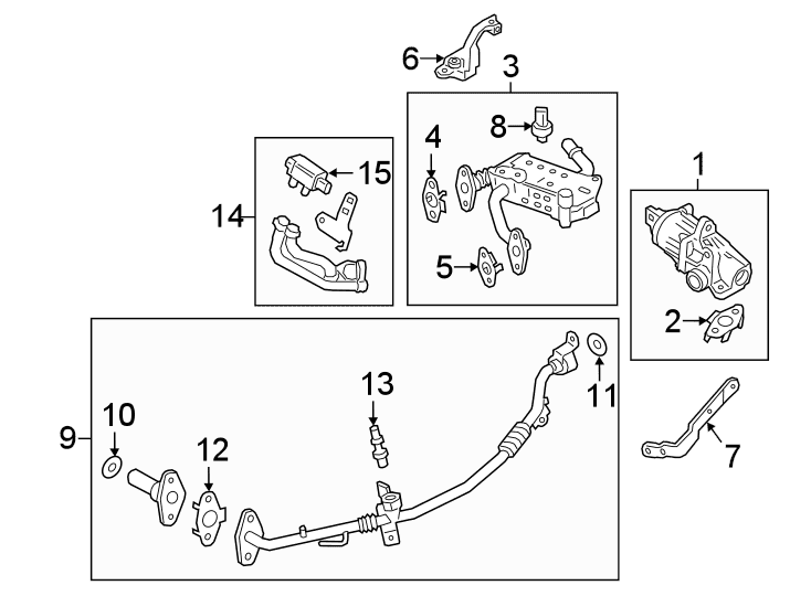

  • Sensor-only - KA1Z-5L200-A (Most diagrams call this "sensor. valve." #14 in attached parts diagram) The sensor itself is not a valve, but it does measure the flow of exhaust from the EGR valve to the intake manifold:
    • This option is cheaper if you don't mind using either worm-style hose clamps or sourcing the correct size oetiker clamps.
  • Sensor with bracket, new hoses, and quick-twist plastic-tabbed clamps for easy installation - LB5Z-9J433-B (Most diagrams call this version "Egr vacuum control" #15 in attached parts diagram):
    • This option is the one that I went with for my truck due to the convenience of the plastic twist-off hose clamp pieces that hold the spring clamps open so that you can install the sensor assembly with one hand. This also ensures that the hoses are fully and properly seated on the EGR tube and that the clamps are seated correctly on the hoses at the ends.
    • If you go with this option, installation is super easy as you just need to press the hoses on the EGR pipes (they are different sizes, so pay attention to the size of the openings on the pipe fittings and the sensor's hoses) and install the bracket bolt.
    • For those that are stiflers for torque like me, the torque specification for the sensor bracket bolt is 97 lb.-in. (97 INCH pounds). The bracket bolt itself is 8 mm.
It is easiest to remove the sensor's hoses if you unbolt the 8 mm bolt first and then swing the old sensor down towards the brake booster. A good headlamp is essential for hands-free light so you can see the clamps and still have both hands to get at them.
Installation is the reverse of the installation with hoses pushed on first, then secure the sensor and tighten down the bolt.

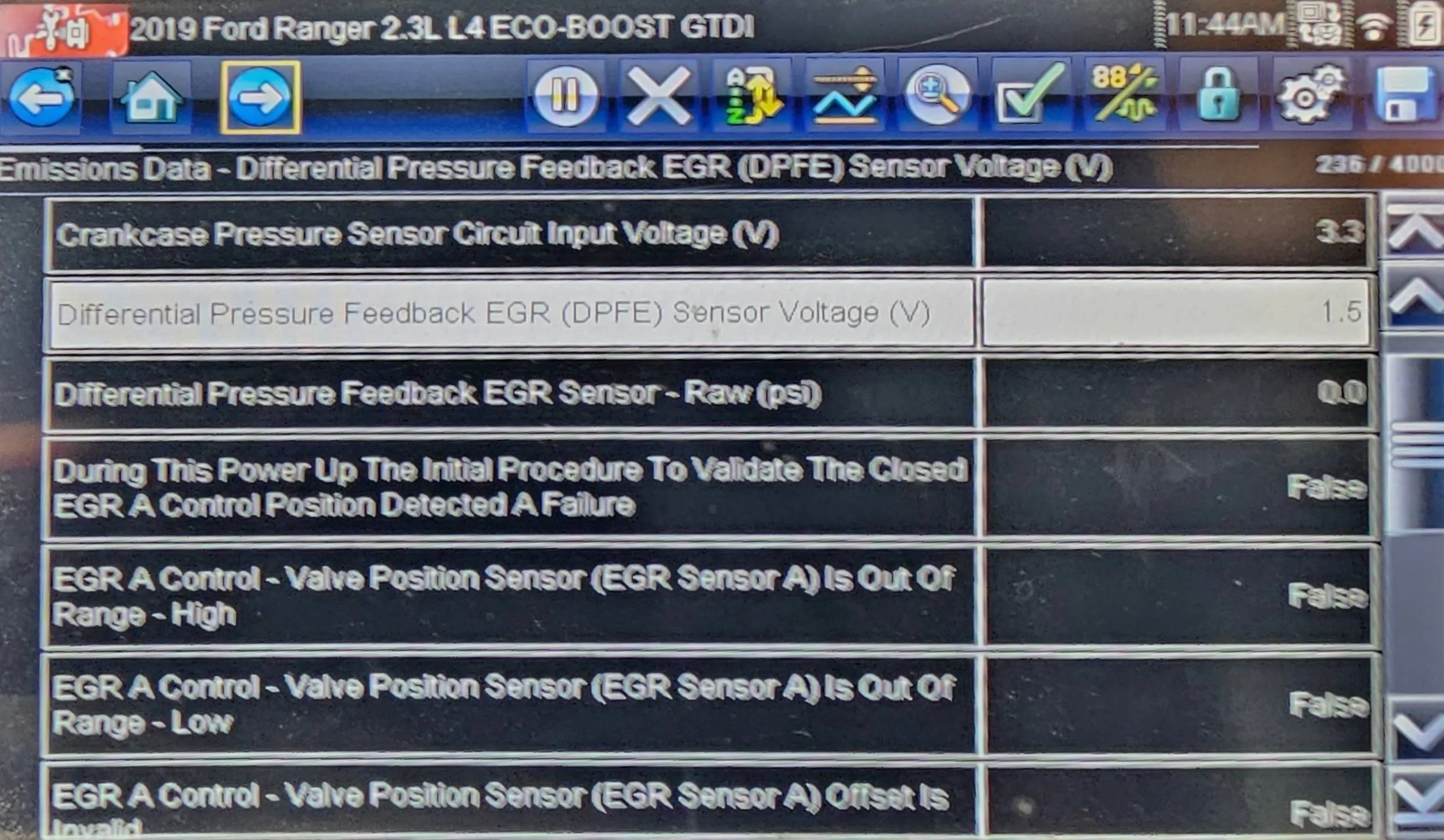

I've attached a picture of the DPFE data PID on the scan tool (Snap-On Solus Edge) after the repair was completed and am pleased to add my name to the list of people who had their issue completely resolved.

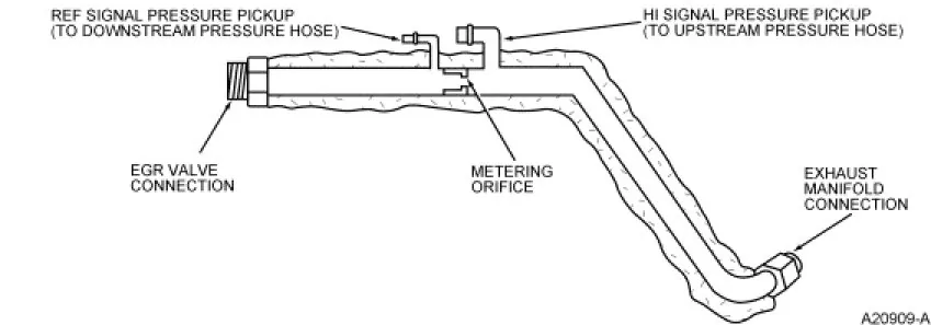

Sensor senses the difference in pressure across a fixed orifice. When the EGR valve is open, there is higher pressure on the EGR valve side of the orifice and lower pressure on intake manifold side. A larger difference in pressure comes from the EGR valve opening. When the valve closes, the pressure difference (the differential) becomes less, and the sensor reports back to the PCM that exhaust gases are no longer flowing.
Just wanted to expand on this:
When the EGR Valve is closed the D/Stream and Upstream pressures are equal across the Orifice Tube.
And when the EGR Valve opens the upstream pressure in the tube decreases (Exhaust Flow), this is what the DPFE sensor is measuring as you now have a pressure release on the downstream side of the tube due to the exhaust flow into the intake manifold.
The upstream pressure is greater than the downstream due to the restriction (Orifice) in the tube.
The pressure difference between the up/down stream is converted into a voltage reference signal and sent to the PCM for EGR valve open/close control via the stepper motor of the EGR valve.
The higher the voltage reference signal to further open the EGR Valve is.
And this is where the sensor registers exhaust flow and more importantly how much exhaust flow, so a misread flow will cause the EGR valve to be commanded open when it should not be open.
To be clear on this, you have a higher pressure on the upstream side of the orifice tube, when the EGR Valve opens, and the added exhaust flow into the Intake Manifold via downstream pressure will increase the Intake Manifold pressure. (Increased manifold pressure = Lower manifold vacuum) Manifold vacuum should be higher at idle and low rpm. This increased pressure and lowered manifold vacuum when at the wrong engine parameters is what causes the bucking/surging, the MAPT sensor now reading the higher intake manifold pressure tries to compensate and adjust fuel delivery the best it can, and this keeps the engine from actually stalling, but only enhances the bucking/surging drivability concern.
Scan Tool Note:
It is good to know that the DPFE PID, is actually viewable from a 3rd party tool, as Forscan and my Autel 906TS will not display that PID
Here is a good pic of the Orifice Tube Assembly for a better understanding of system operation.
The smaller diameter hose is the feed into the intake (Downstream-Ref Signal)
This is what the DPFE sensor hoses connect to

Rather than post a lengthy post on the internals of the DPFE sensor, I found this via Google, now it's an older publication and does not really cover the new generation of the EGR system but the DPFE sensor is broken down and explained. Thought I would share for those that are wanting to gain some knowledge on this small but very important part that is a thorn in many owner's sides.
Note: The Ranger uses a Electric Controlled EGR and the Vacuum Regulator is not installed, so just focus on the DPFE operation (internals) with this document.

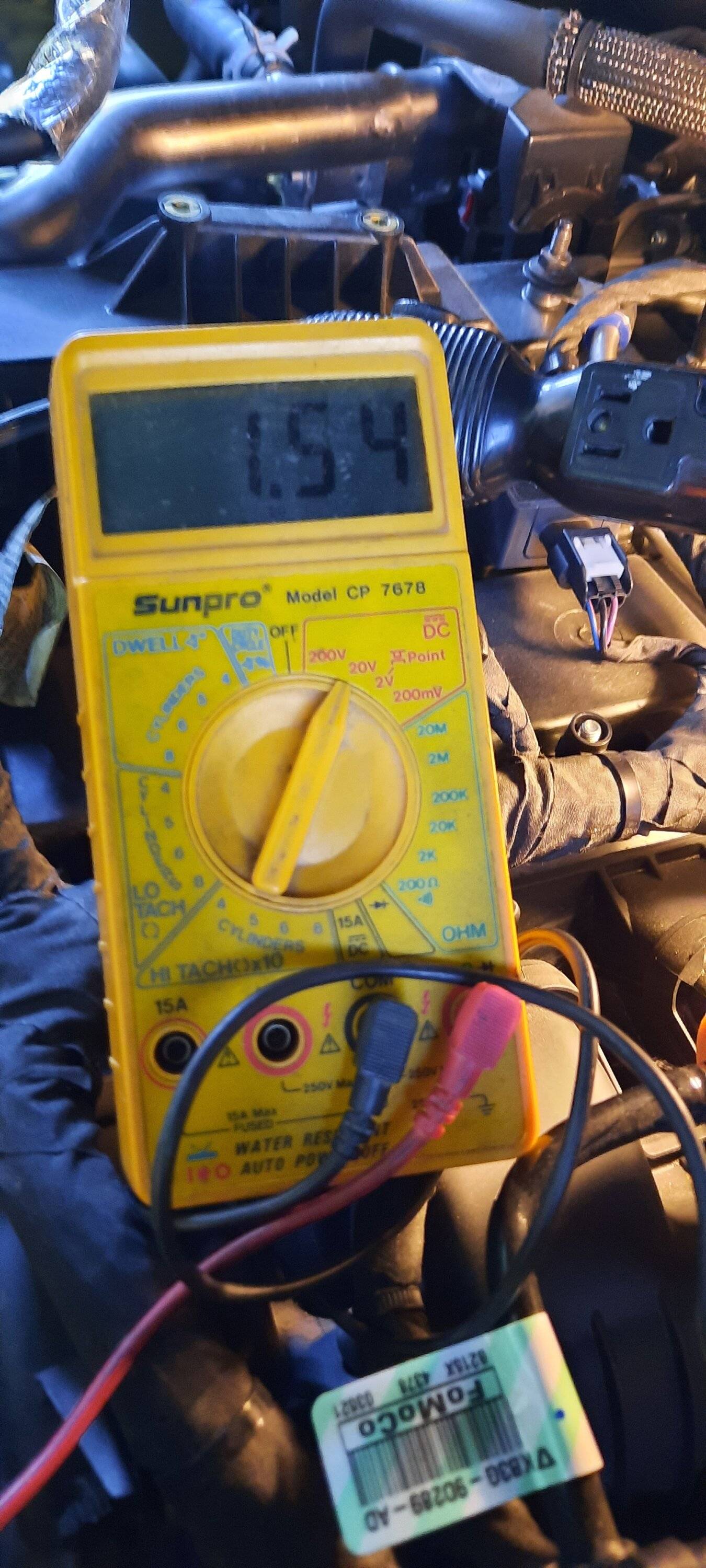

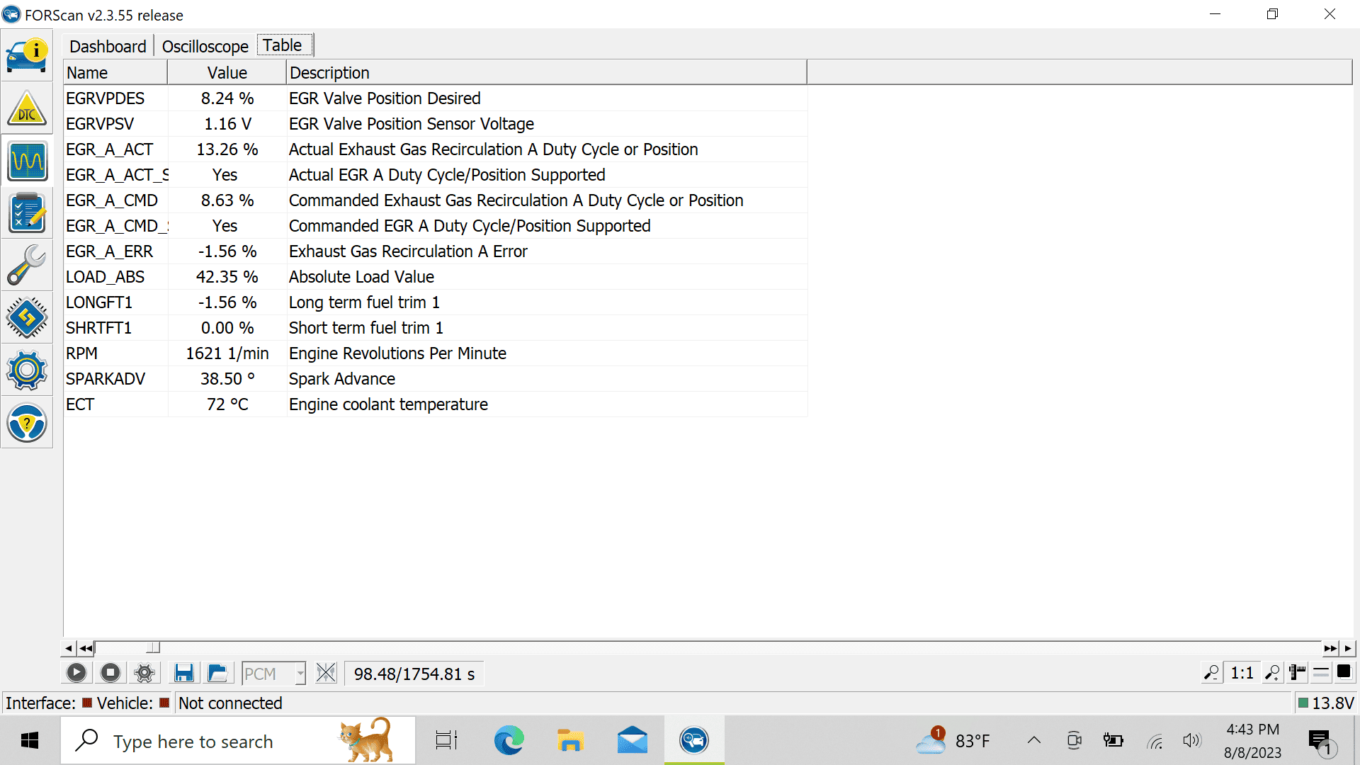

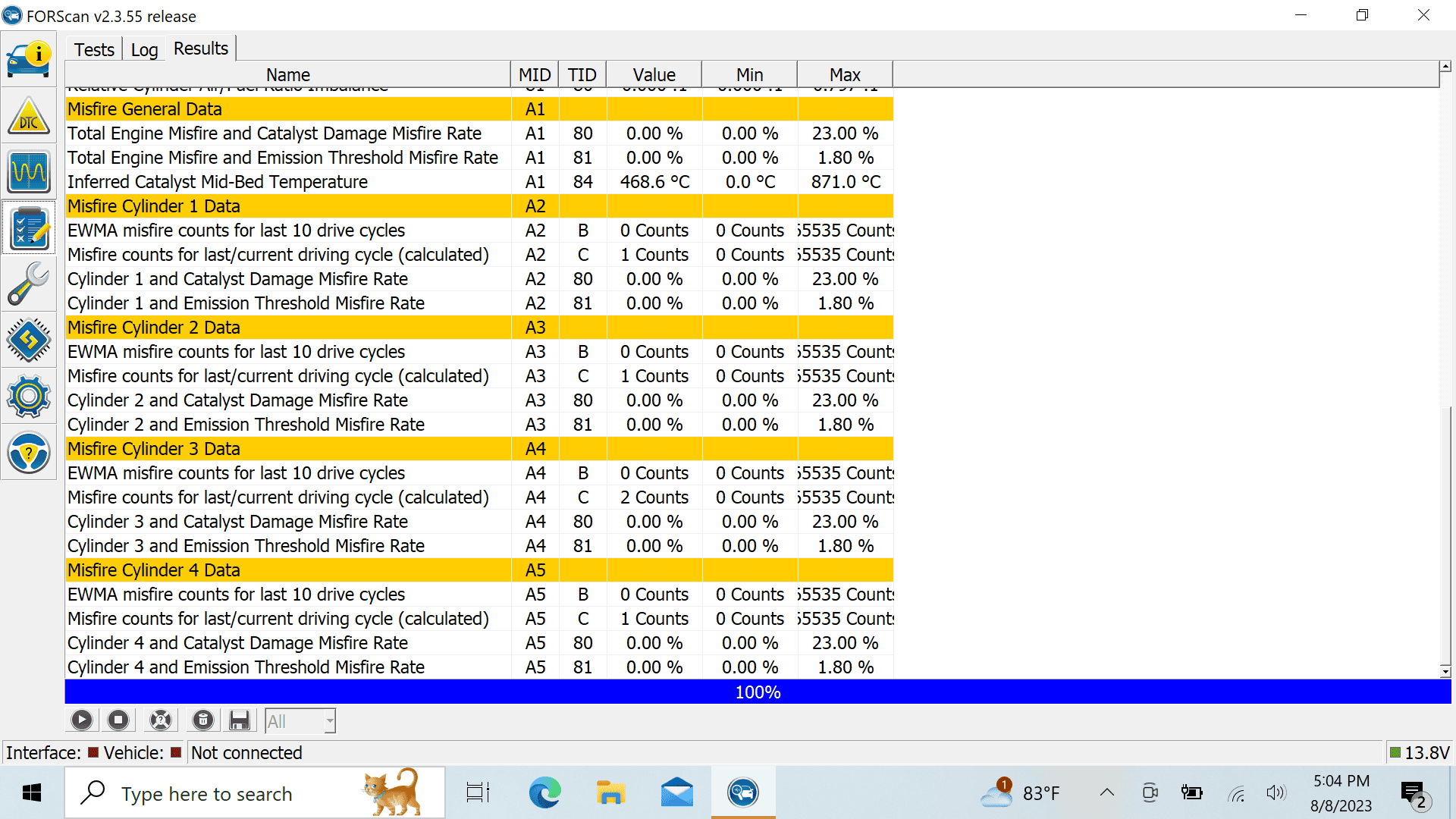

I keep trying to diag. this without just firing the parts cannon at it and keeps coming up inconclusive
:mad:
This is the data from Forscan close as I could get to the timeline of the misfire.
Wish Forscan had the Pids for the DPFE sensor. At least mode 6 data did pick up on the miss.

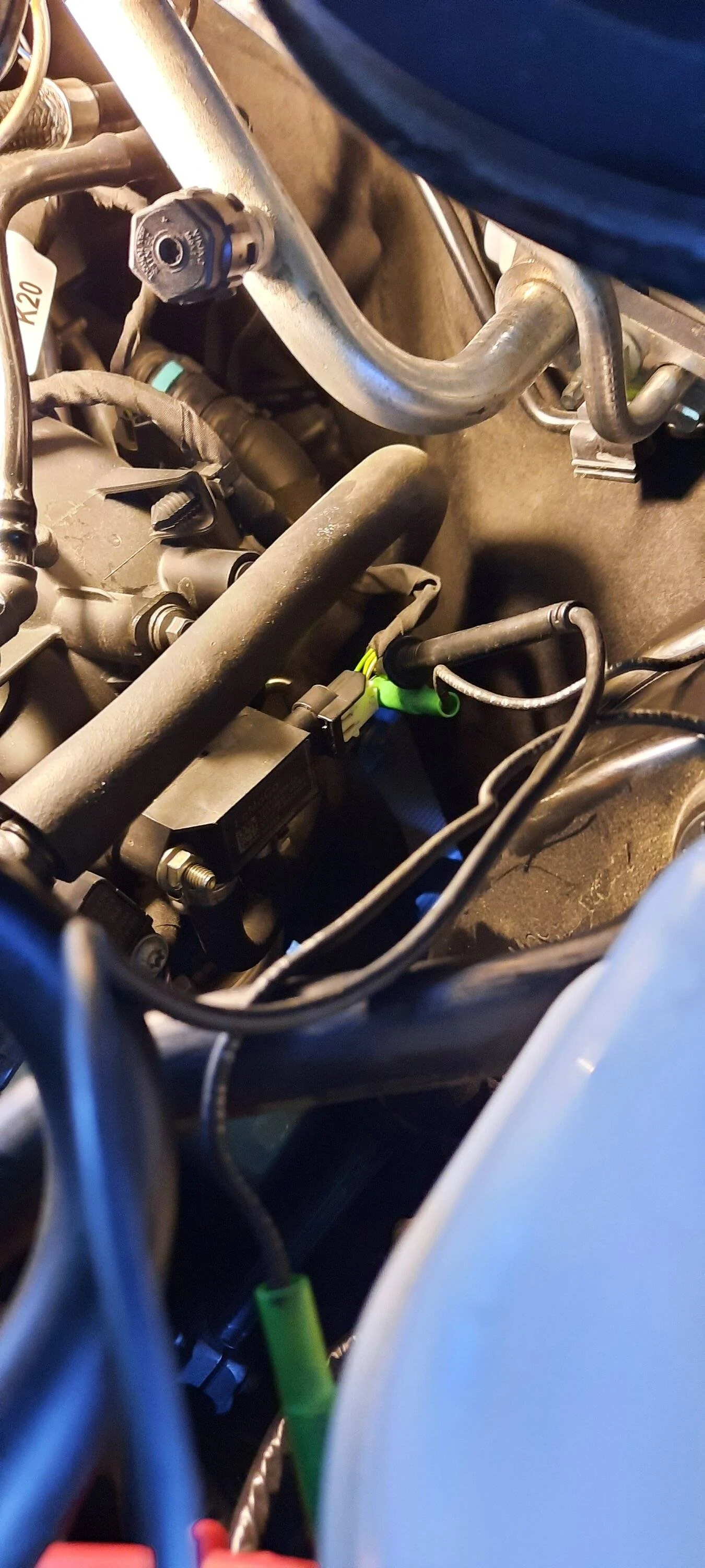

So today I decided to back probe the pins and this is my results.
Would like to be able to diag. this but I'll probably just order the part and hope I'm another satisfied customer of Ranger 5G diagnostics forum:cool:
