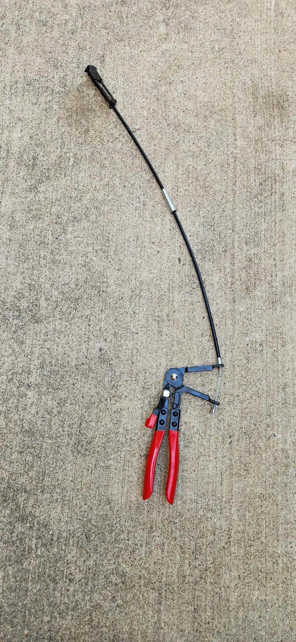

Having a remote clamp remover also helped make short work of that. Looks sort of like someone took a bike brake and made a tool out of it.
But that is probably overkill for this. Needle nose would work once you can get them on the stupid clamp things that are a bit awkward in general. The short one was spun towards the engine. The longer one was facing out.
Cheesy tool thing mentioned above... it helps reach and locks once you have the clamp open.
