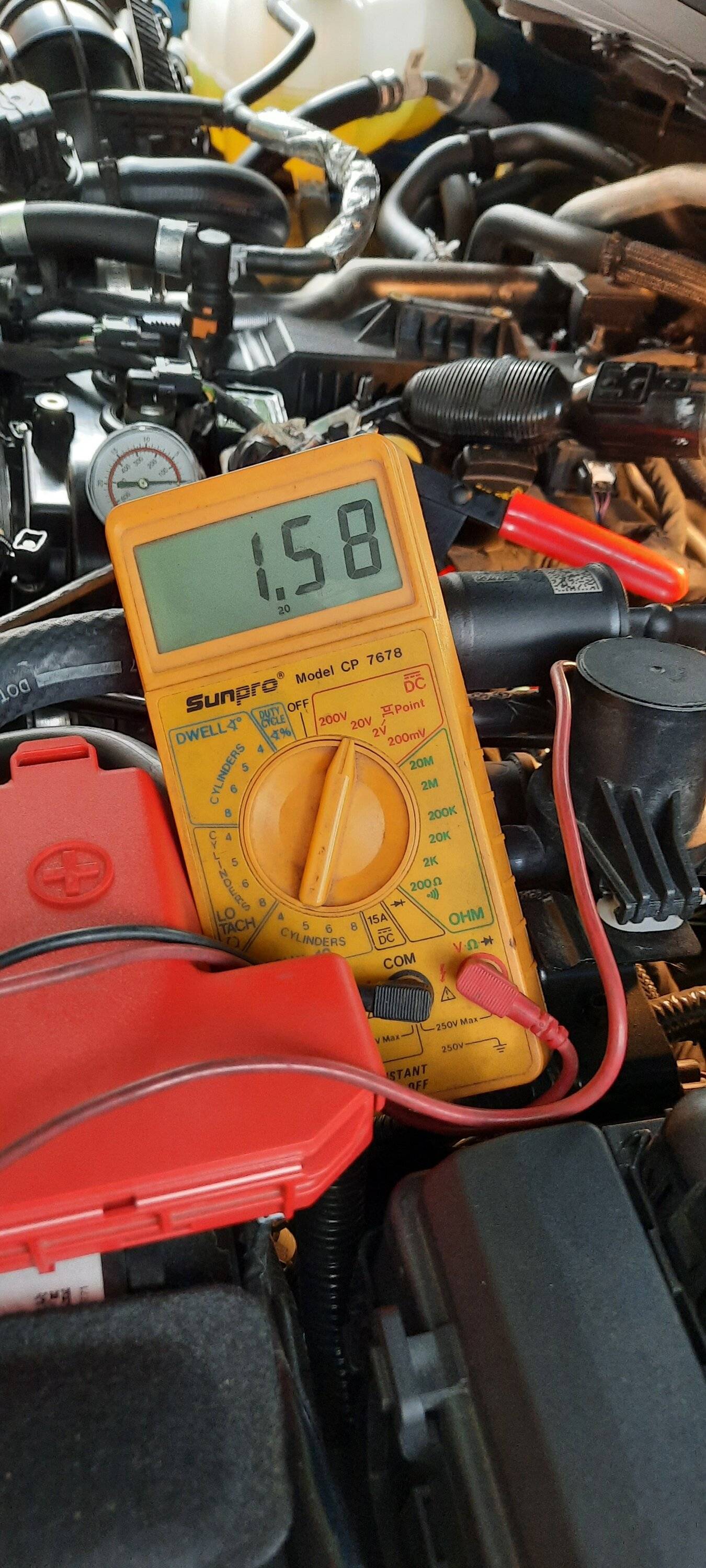

Well instead of letting my old man arms heal up after the last test I decided to beat on them some more today after mens breakfast at church:idea:
Since the engine was warm I decided to run the test that you posted. Looking at the testing parameters above I can't help but think the sensor was showing fault at the 1.54v.
  • The DPFEGR PID voltage must be between 0.25 and 1.3 volts with the ignition ON and no vacuum applied.
  • The DPFEGR PID voltage must increase to greater than 4 volts with the vacuum applied.
  • The DPFEGR PID must drop to less than 1.5 volts in less than 3 seconds when the vacuum is released.
But we need knowledge so on with the test.
Test conditions: engine warm, KOEO
I disconnected the intake side hose at the EGR pipe not the sensor like the test procedure says I don't have a replacement clamp and it really shouldn't make a difference in the test. I then hooked the vacuum pump to the hose.
I then back probed pin1 on the connector and this is what I got...
No vacuum
9 in hg Vacuum
Never got close to 4v on the test The highest reading I got was 2.8v.
When I released the vacuum the reading immediately dropped to 1.56v then resettled at the 1.58v
I know my vacuum seal wasn't the best because it would start to slowly decay after about 3 sec. But I still think the test is valid and my sensor is bad.

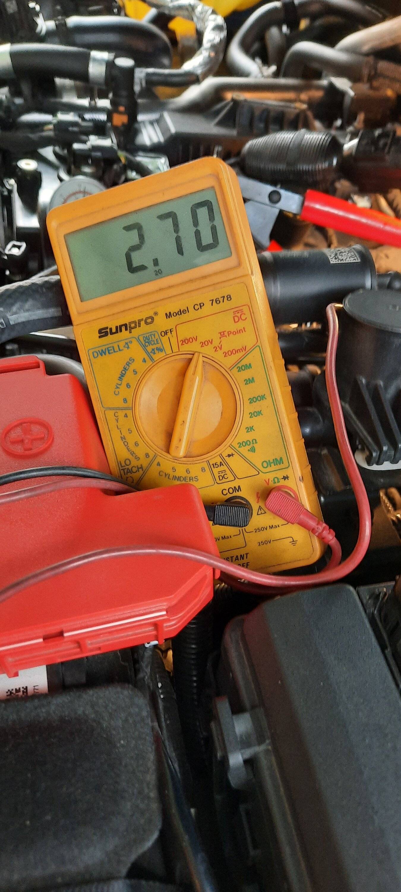

UPDATE: 8/15/2023
I purchased a new DPFE sensor today for 57.77 - 27.00 I had for points, for a total of 35.00. I'll take that deal:). I haven't installed it yet(need clamps) but plugged it in and ran the same checks as the OE sensor. So here it is.
KOEO no Vacuum: 1.52v
KOEO Vacuum : 2.70v
So .06v difference on the no vacuum and thats it. Its looking like this test is inconclusive on why these sensors are failing. Since this engine is inducted and not NA I'm sure the values are different than a NA engine probably why I'm not seeing the 4 volts. The only thing I think I can do now is try KOER, back probe it, and put a load on the engine. I'll do that when I go to install the new one.
Curious what others failed sensors voltages are?

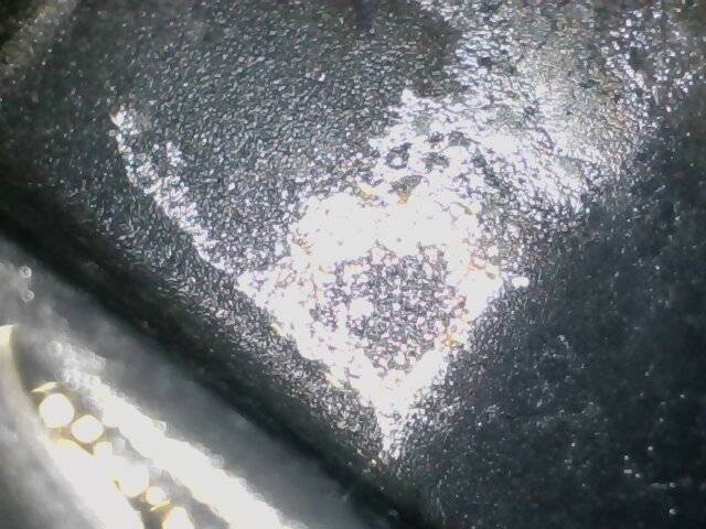

Replaced the sensor today and did a vacuum check after I removed hoses from the OE sensor, and it held vacuum longer than the new one. The new DPFE sensor lost 1in-hg in 10 sec. The old one did not drop at all for 10 sec.
I went ahead and taped the sensor on a clean paper towel and got 3 or 4 drops of water out of the larger port.
After knocking the water out I redid the vacuum test and the decay was the same as the new sensor?
So is the issue just water contamination causing false readings?
Might get some mass air cleaner and spray the ports out and if new sensor starts acting up, swap them out and see.
Went ahead stuck my bore scope in there and didn't see much. Some water still and some kind of deposit probably carbon.
