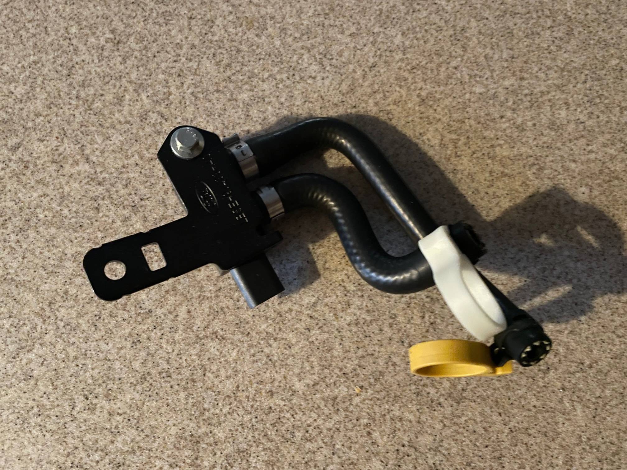

I replaced
LB5Z-9J433-B​
Valve Exhaust Gas Recirculat​
and it mostly resolved my problem (or so I thought), but now it has returned back to pretty much the way it was with the bucking and feeling like it's "missing' between 15-30 MPH, especially in the morning when it's not warmed up. Is the part above the valve or sensor, and is there another part I could / should have replaced. Sorry, I'm confused at this point, especially since the part above has not seemed to resolve my problem. I have a very early 2019 (purchased in Jan 2019) so maybe I just need the PCM reset?
Mines been the same way. The sensor reduces the occurances significantly, but doesn't completely eliminate them. Always comes back. Seems to be worse when it's humid or wet out. Did you replace just the sensor or the sensor and the 2 hoses?

Yes, the part comes with the sensor, two hoses, and two hose clamps that have plastic rings to aid in installation. The rings expand the hose clamps until you've installed it and ready to pull them out to clamp onto the hose.
Thanks for the info, my Ranger is not bucking yet but I ordered the part anyways. I don't recall a plastic ring but have to double check the box.
26,220
131,993
I didn't need one either but like you ordered one to have it ready and I think we both ordered ours around the same time. Mine were facing down when you opened the box so if you didn't take the whole part out you wouldn't have seen them. It's nice that they added these and should make it a quick 10 minute job.
Yes. Mine came with the ring same as yours, might have to ask you later which hose goes to where, when it's time to install.

Just wanted to add to the list that the EGR Valve (LB5Z-9J433-B) completely fixed my problem. I had my truck (2019 Ranger XLT) into the dealership 3 times and they couldn't figure it out. They even installed a new torque converter under warranty. It doesn't help much that no one there took the time to try to understand what my problem was or replicate it.
Ordered the EGR Valve, installed in 15 minutes, and my problems magically disappeared. I highly recommend using small 4.5 inch channel lock pliers to remove the old hoses. Made the job super easy for me.
My problems for the record were: big clunks into gear on cold starts, harsh bucking between 20 and 60mph at low rpms with my foot barely on the gas. Thank you to everyone here for your help!
