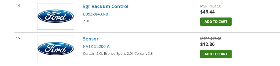

This has been said a few time here on this thread but there seems to be much confusion. Below are the 2 "different" part numbers in question. Number 14 here Includes Number 15. In most all cases all a person probably needs is Number 15 (KA1Z-5L00-A). The more expensive one just comes with hoses and a clip. Our trucks aren't old enough to need hoses replaced so save yourself some dough. These are back in stock as well here in Jan 2023.

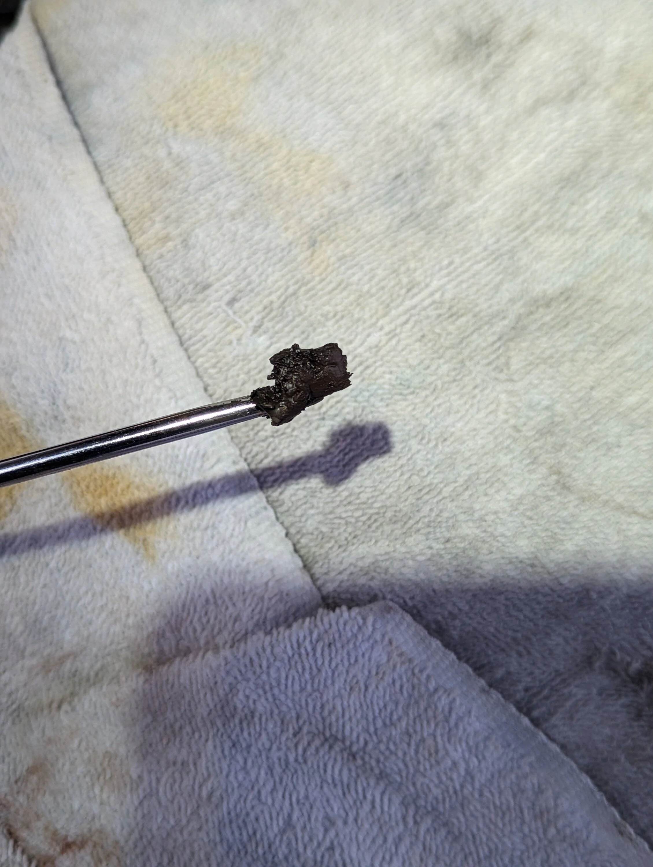

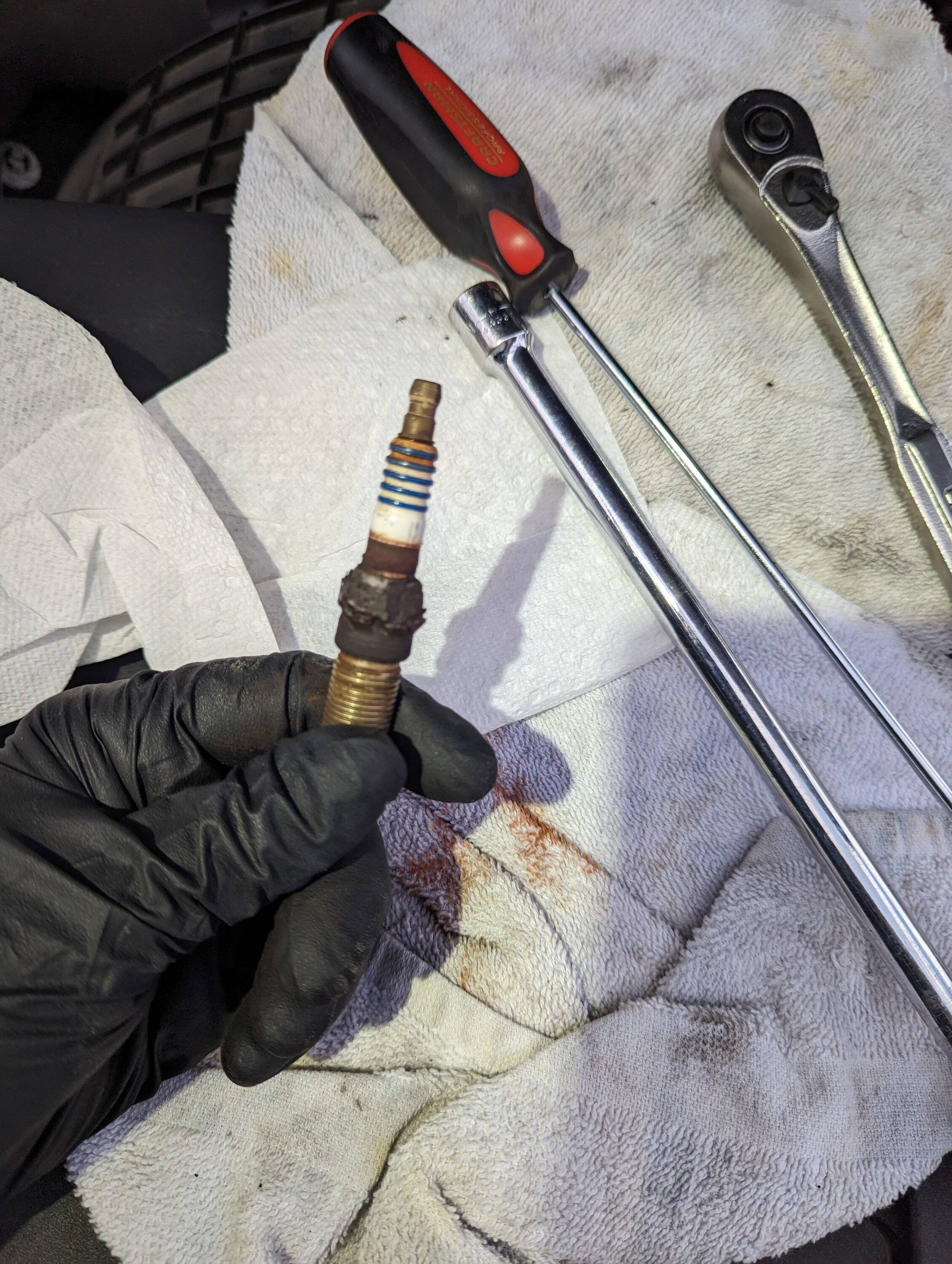

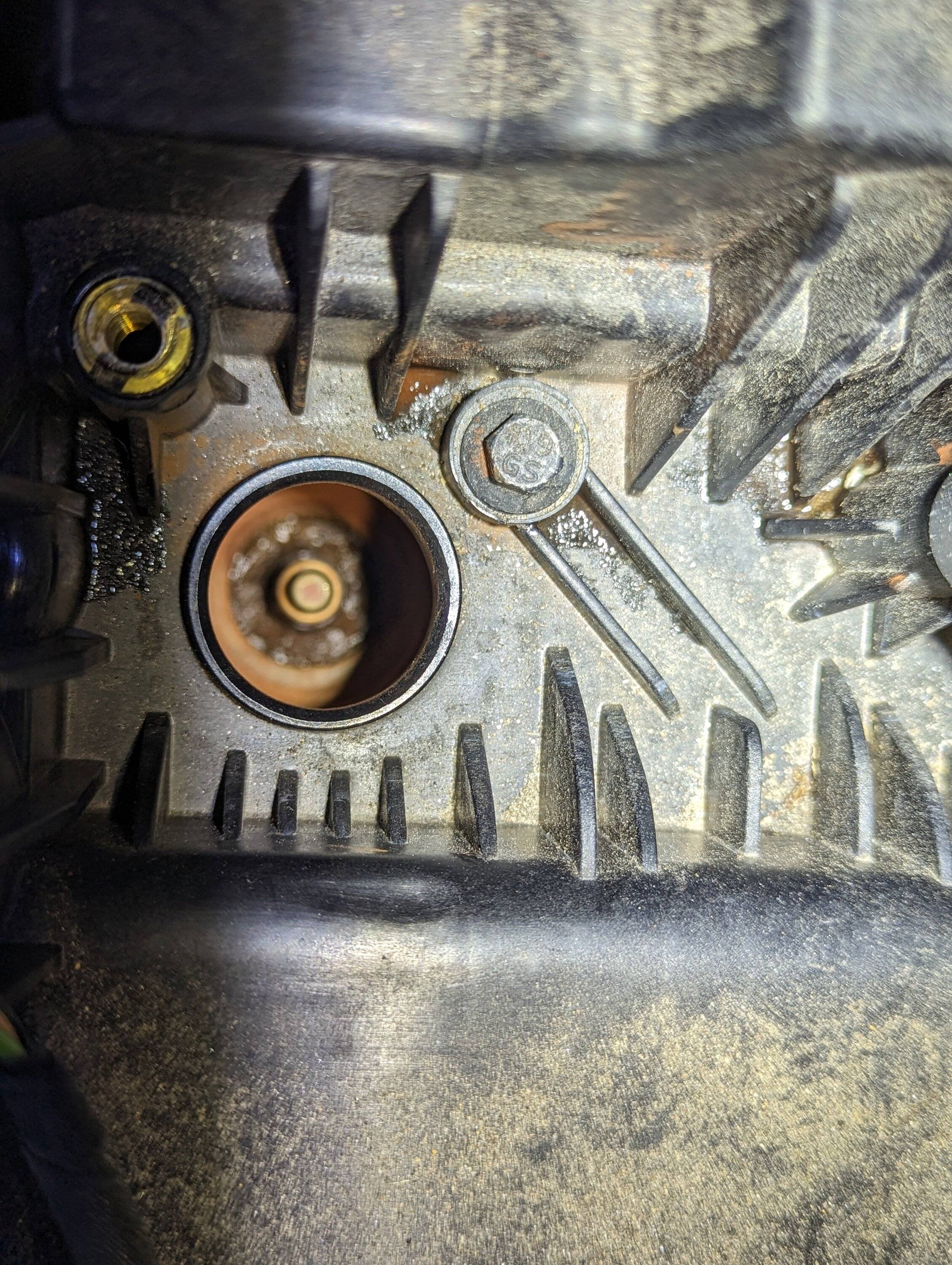

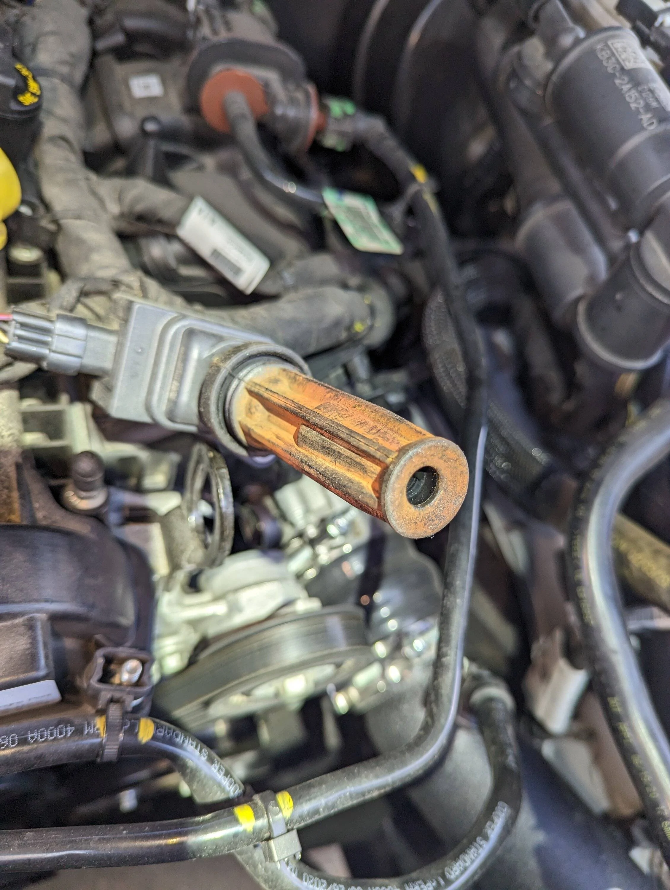

Within the last week my 2020 Ranger has stuttered and lost power while trying to accelerate in 10th gear.
Both times the CEL flashed for about 10 seconds, then went out and the problem disappeared.
HUH!?
Today it did it again on my way home from work, so when I got home I used my n-Gauge tuner display to look for any old CEL codes.
Ah-Ha!
Two - 'P0301' codes = Cylinder #1 misfire.
So I pulled the #1 COP and found a miniature bathtub full of rusty water along with a submerged spark plug!
WTF!?
After soaking up all the water with paper towels there was a layer of rusty, gunky sludge in the bottom of the spark plug well.
I vacuumed all the crap up, pulled the sparkplug and cleaned it, then cleaned the COP with silicone spray.
Runs great now.
But....I have NO IDEA how all that gunky crap got into the #1 Cylinder's sparkplug well.
I do NOT wash or spray the engine compartment.
I never run it through automated car washes either.
#1 COP was tight and the boot looked to be snug.
#2,#3,& #4 were all perfectly clean and dry.
