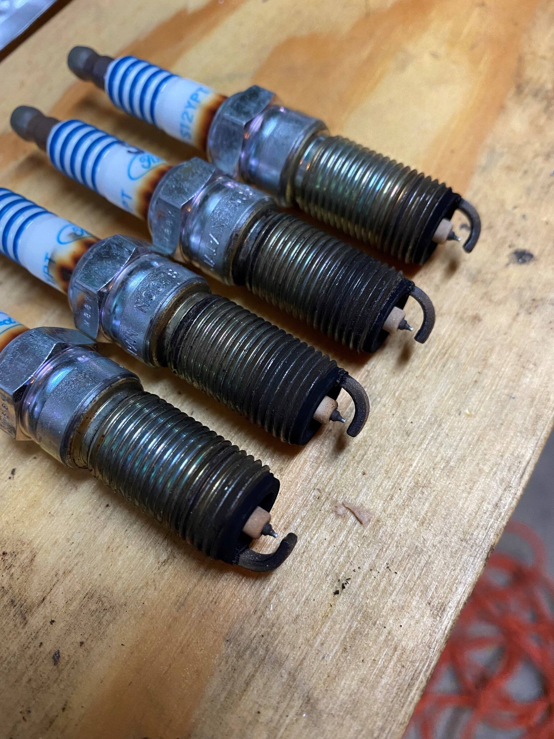

Quick update, I changed out the spark plugs myself with new Motorcraft ones (Part #: SP-578) and it runs marginally better (I think?), but it definitely didn't solve the issue. Next is definitely the EGR pressure sensor after the holidays. The pic below is of my old spark plugs, they don't look great but they also don't look horrible like the service rep was making it out to be.
I also did some digging to see what is and isn't covered by powertrain warranty as I'm at 46k miles. As it turns out, emissions equipment besides the catalytic converter, electronics emissions control unit, and onboard emissions diagnostic devices are NOT warrantied past bumper-to-bumper warranty. So, the EGR pressure sensor would not be covered by powertrain warranty and if you've exceed 36k miles/3 years, don't take it to the dealer if you have some DIY capabilities. Dealer wanted $400 just for spark plugs, don't want to know what they would charge for the EGR sensor.
Finally, I can personally vouch that Motorcraft spark plugs are going to be your best option. I figured I would try something different, so I got Bosch spark plugs. Wrong decision. Made the engine run like crap, misfired everywhere, so I immediately got some Motorcraft ones at O'Reilly. Autozone was nice enough to let me return the Bosch ones, but just take my word for it and avoid the hassle.
And when changing your spark plugs, it is much easier to unclip the coil from the harness for cylinder #4. The high pressure fuel line (I think) is in a bad spot right above the spark plug hole so it requires some finagling to get the coil and boot out; much easier when it's disconnected from the harness and it took me longer than I care to admit that I realized I had that option, lol.
