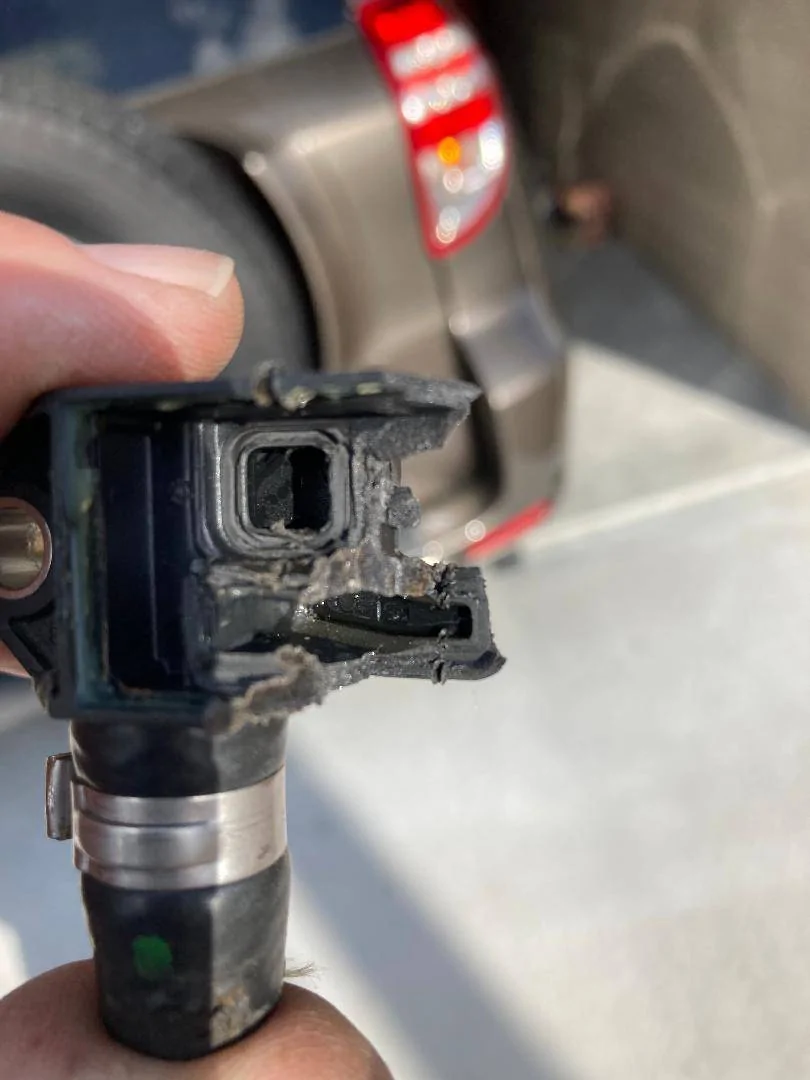

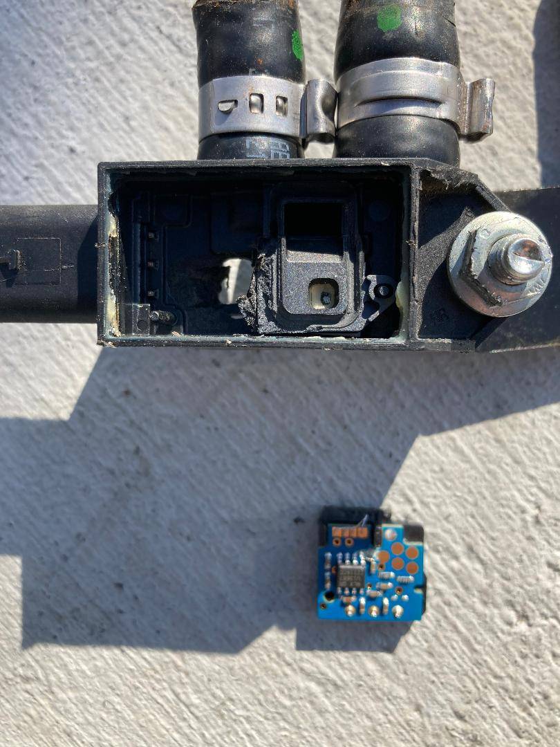

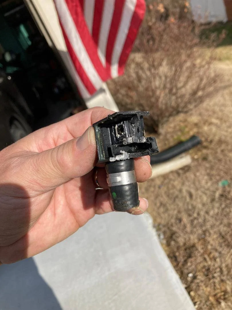

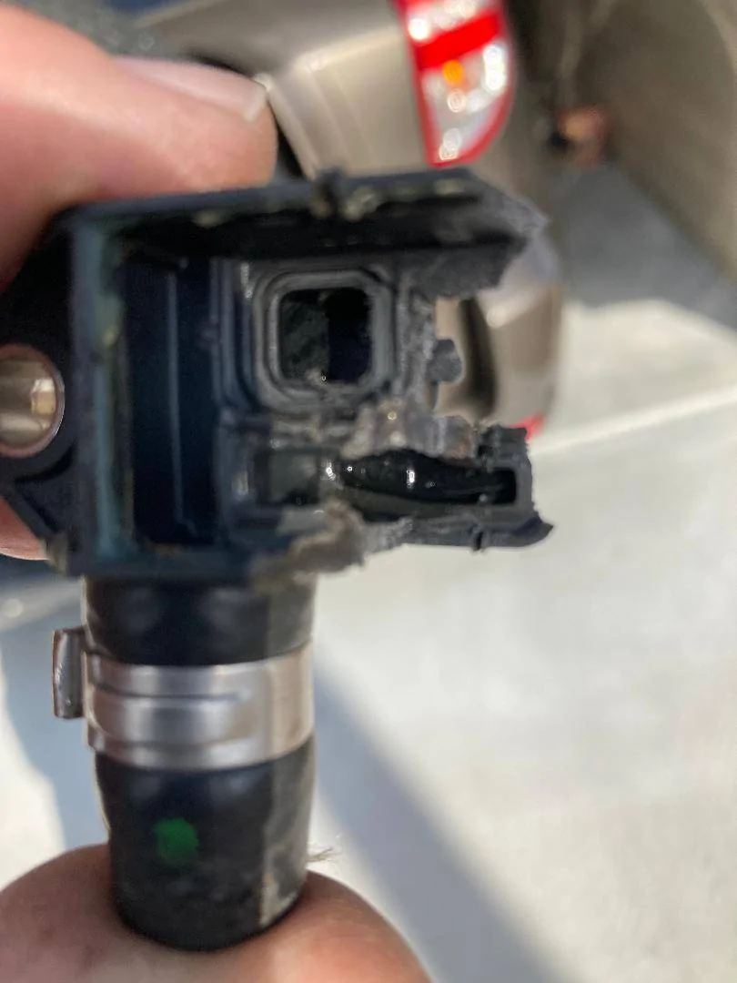

I replaced my sensor today. Wasn't bad at all, 15 minutes literally and a few scratches later, it's done. I cut my old one in half and there was definitely moisture in the casing. There didn't seem to be any on the little electronic chip inside, to the naked eye, but I assume no moisture at all should be inside anywhere.
