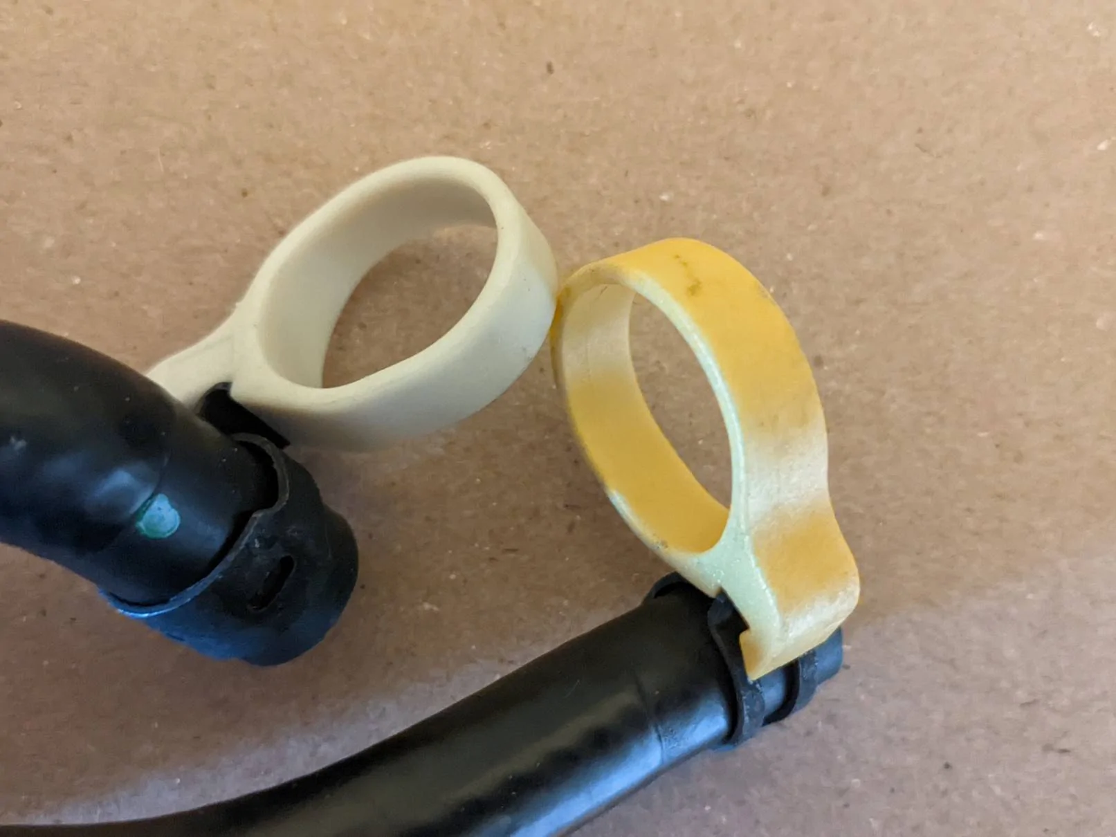

My 2019 with 29000km has this issue and my new EGR valve is here.
I have a stupid question though before I put it on: These hose clamps with the yellow/white plastic loop tabs? Are you supposed to remove the plastic thing to allow the clamp to fully tension or are you supposed to just leave it on there.
I have a stupid question though before I put it on: These hose clamps with the yellow/white plastic loop tabs? Are you supposed to remove the plastic thing to allow the clamp to fully tension or are you supposed to just leave it on there. Obviously the OEM left theirs on, but just askin, maybe thats why the valves are all screwed up because the hoses arent tight?
These loops keep the hose clamps open. Once fitted on the steel pipes of your truck, twist these loops off and the hose clamps, clamp, securing the hose.
Yes, remove after installation.
Looks to me like they should come off. I first thought they locked the clamps in place.
Update:
Install of the new part is complete. (LB5Z-9J433-B)
Truck drives nice, seems way smoother. Im happy. The install for a non mechanic wasnt bad. Access to the old clamps is the hardest part, but once I got the smaller of the two off the rest was a breeze.
Yes thanks to the posters who mentioned the yellow and white tabs come off once installed. Thats actually a pretty slick design! Twist and they are clamped on. Easier then I expected. Ill report back if I have any new bucking.
