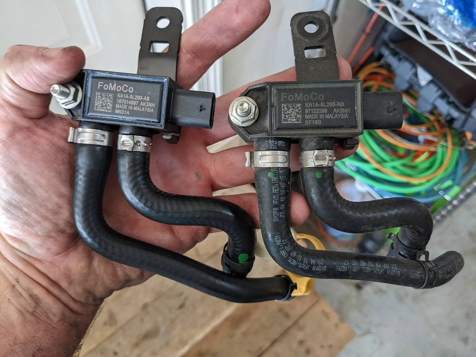

How the hell is everyone getting this off?????
Use some type of pliers to open the clamps, move them up the hose so they’re not re-clamped on the metal tube. Or cut the clamp off with a dremel tool.
Grab the hose with pliers and twist the hose to “unstick” it from the metal tube. Should then pull off easily.
Took me 20 minutes maybe to replace.

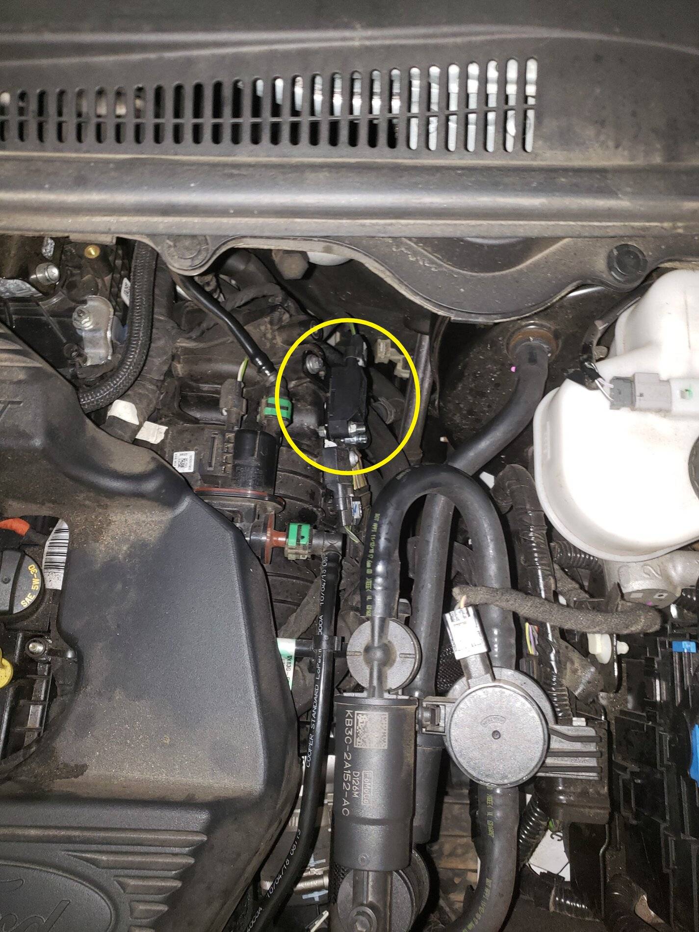

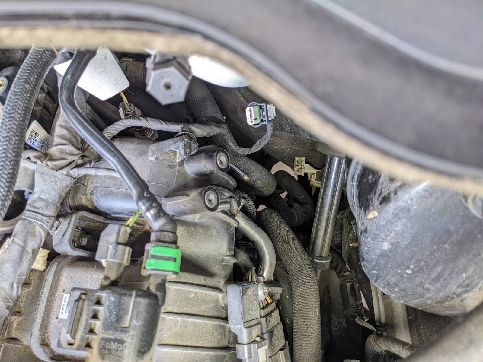

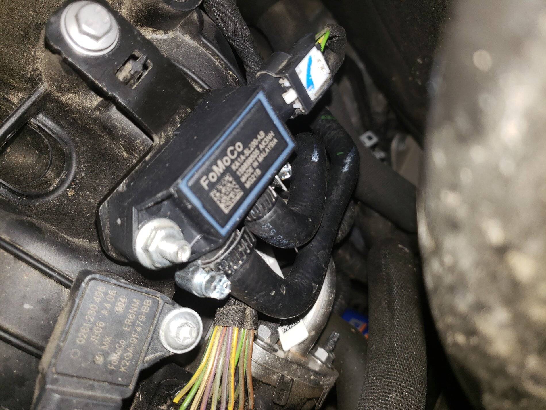

Hope this is helpful
I have been battling this light-throttle bucking/surging thing for about a year. It started off very subtle. It has gotten more regular lately and finally started throwing a code P139C. Found this thread through my searching of my problem and ordered LB5Z-9J433-B based on what you all were saying and the fact that with my truck having 46k miles on it, they couldn't guarantee the diagnostic and/or fix would be free of charge. 5-10 minute job to replace it on my own. Felt no bucking or surging on the way into work this morning. I will update if anything changes. Thanks all.
Some pics to complement the ones I quoted to help others with the replacement (you can see the two tubes the hoses connect to in the pic with it removed)...super easy job:
