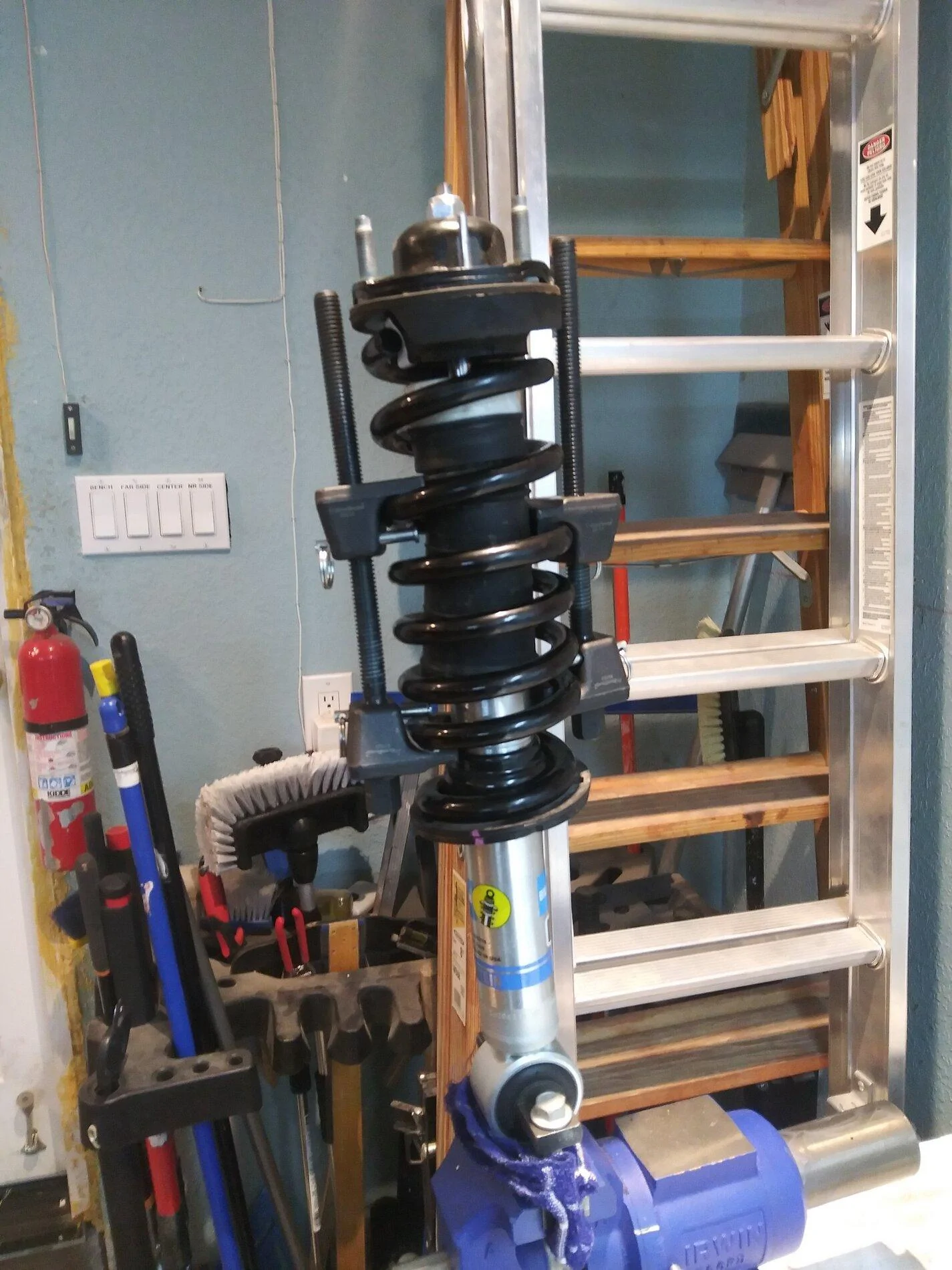

Well, got them installed, after they arrived after work. 4.5 hours. and i have a good supply of tools and 30 yrs wrenching. Yes you can clock the springs after they are installed, at least on the stock setting.
As Porpoise was saying, the rebound damping on the FX strut was vituruly non existtant. I compressed the Bilsteins, and rebound damping was nice and slow, The FX shocks/struts just basically flew back open.
I'm optimistic.
(I feel so bad about the FX shocks, i won't even sell them. They have a date with the dump.)
When I get the fronts, I'll get a local shop to put mine in and align everything.
For a driveway mechanic, the rears should be pretty straightforward right?

I'm sorry, i did not. Ride height is same as it was stock though, i measured that before.
I think if i had to use a ratchet i would of been driving to the tire store. I tried to turn them further with a ratchet after they were compressed with the drill, and don't see how you could compress the spring further by hand. I was just able to get the spring compressed enough for the lowest setting, which is fine, because that's what i wanted, softest ride. you>> :muscle:
haha! My son and I took turns compressing them and he’s a A Tech at a Chevy dealer and he kept telling me “this is so stupid doing it this way” hahah!
glad you’re liking the ride! It’s a huge improvement!
