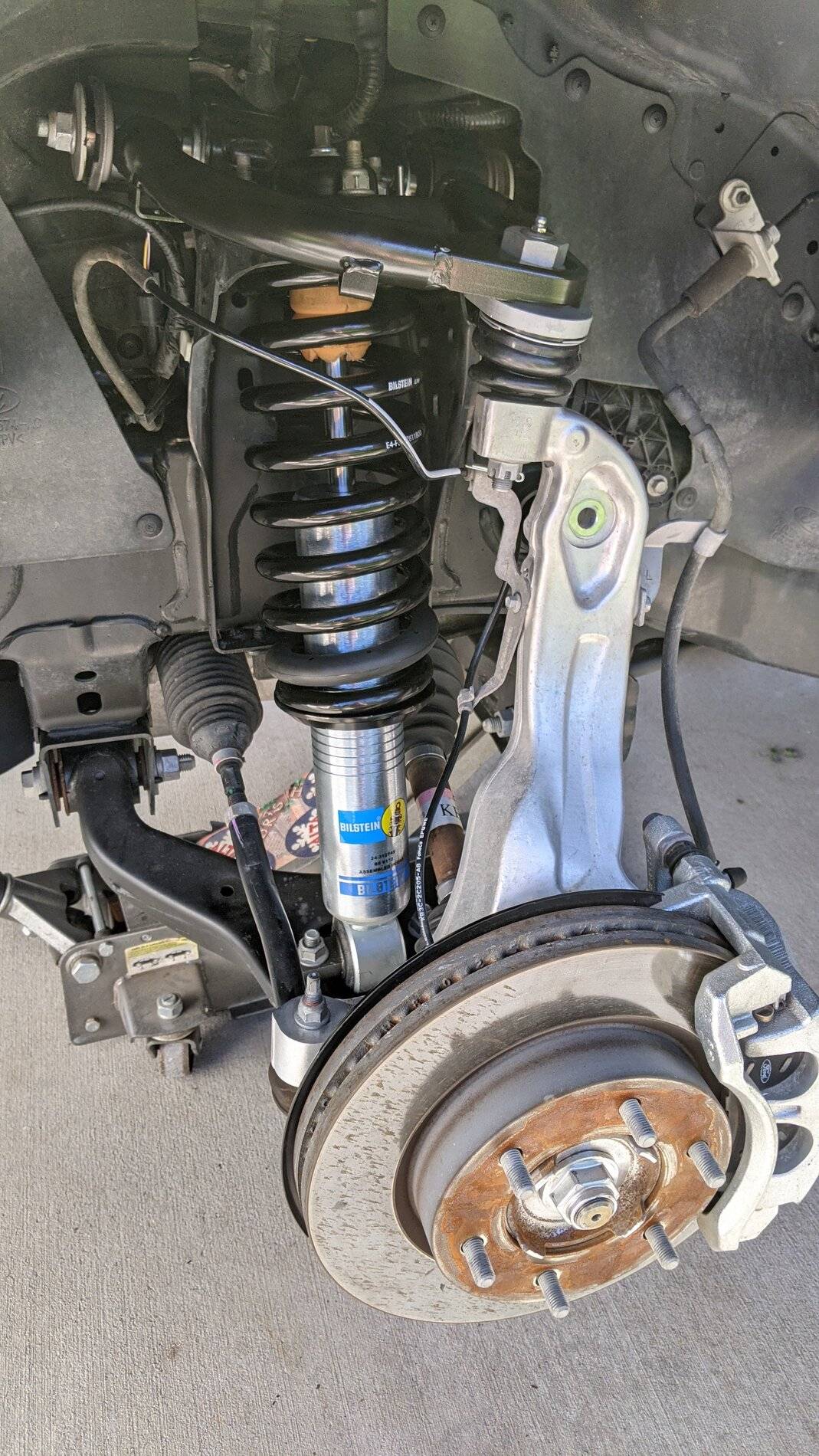

Wasatch
May 29, 2020
63
148
UT
Ranger Supercab
Install completed.
Went 6112's on the top notch, gave around 2.5-2.75'' of front end lift. It will probably settle to 2.5''.
Coming from a Toyota background, the install process was a little different. a few install notes:
-Undoing the 34mm UCA nut is a MUST! I couldn't imagine not having the CV free. A lot of folks complain their CV is 'stuck' or wont come free.... Undo the nut and give it some whacks with a brass punch and hammer so you don't scratch it.
-Mark first, then loosen your LCA cam bolts, and lower the LCA to remove the old and fit the new strut in place. My alignment tabs did not move at all in this process, and tightened them back up when the tires are back on the ground.
-I could not get the lower strut bolts to align at first, so I stuck 2 screwdrivers in the holes a guides and jacked up with LCA. once the strut had some pressure on it, I was able to feed the bolts through. You'll notice I installed mine upside down as the CV was blocking me from putting them through top-down.
-I also installed SPC UCA's. I've had them on every truck I've owned. They're super durable and can take a beating (and also offer 80 degrees of ball joint range). install was very easy. I did them last once the new struts were in place.

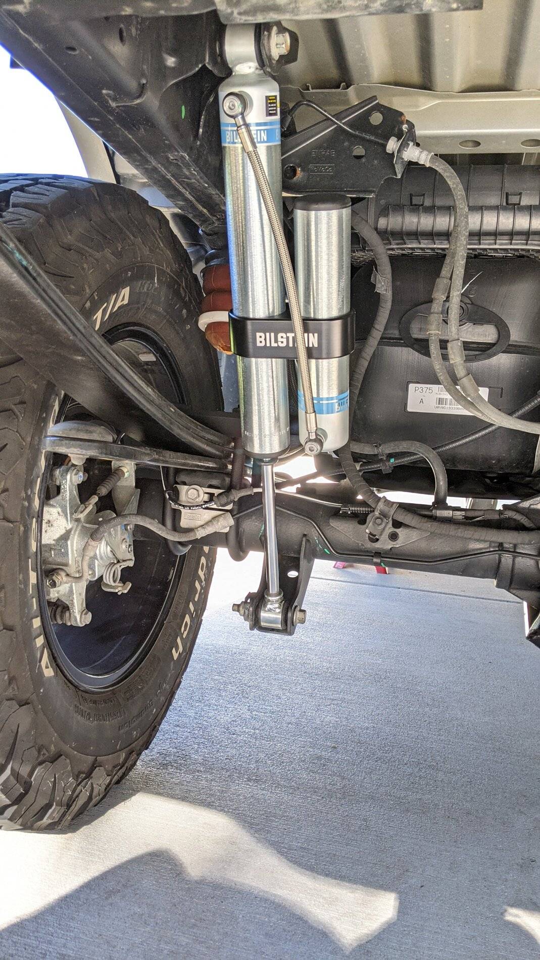

Rear I have an AAL and 5160:
Once I get a few miles on it, I'll report back with some feedback.

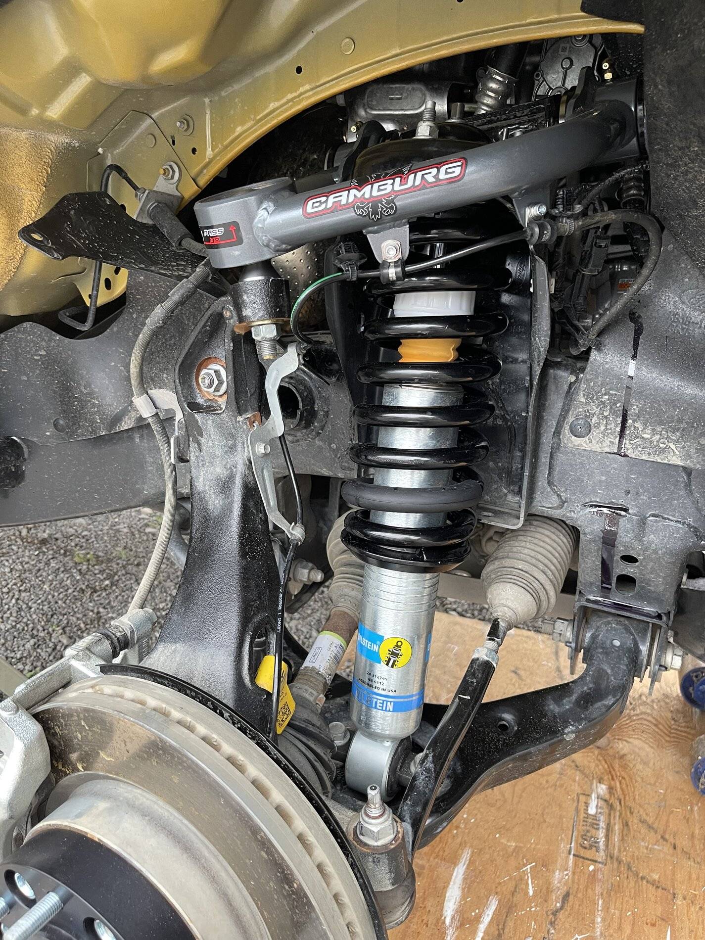

Just installed mine but with Camberg since I have the cast spindles.
