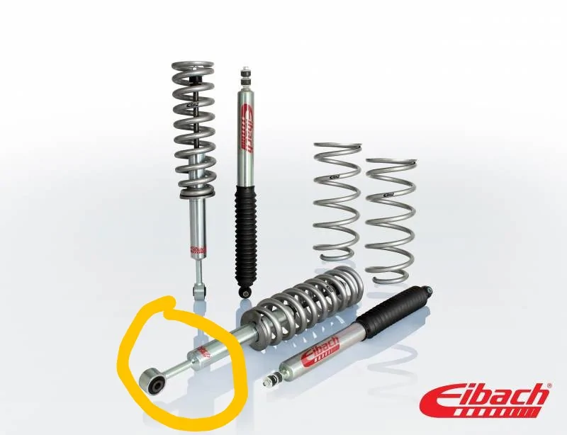

Eibach builds the longer strut. I've circled how they do it - basically by extending the shock body. It adds around 3" to the ride height. I see no difference between this and adding a spacer at the top of the strut. In fact, I think a spacer may be stronger than the rod on the Eibach. The Eibach kit seems pretty reasonably priced, too.
This makes the Eibach look like a more performance and cost effective choice for us street folk.

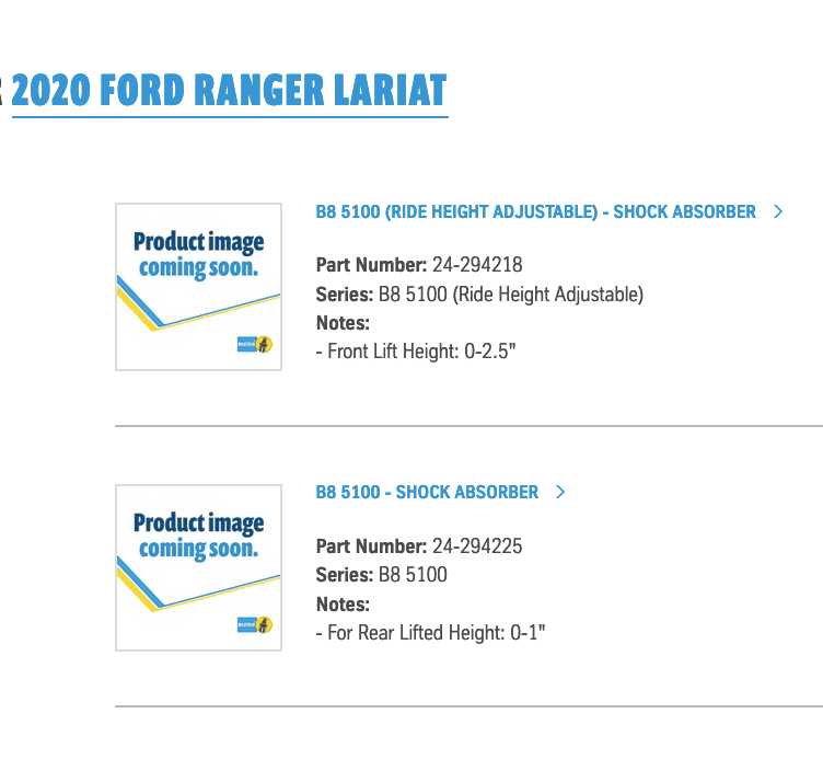

The Bilstein 5100 for the Ranger has adjustable ride-height.
I don't think you need spacers.
Here's the description from their website:
"Bilstein B8 5100 (Ride Height Adjustable) shock absorbers are designed for trucks and SUVs with a front OE coilover style suspension. Multiple snap-ring grooves in the body allow for different spring seat positions, providing 0-2.75 inches of front lift with OE springs (depending on application). The monotube shock absorbers feature a 46mm digressive piston a with self-adjusting deflective disc valve setting. Bilstein B8 5100 (Ride Height Adjustable) shock absorbers provide increased wheel travel and improved handling. Utilizing a B8 5100 (Ride Height Adjustable) shock absorber is the easiest way to level out your vehicle."
