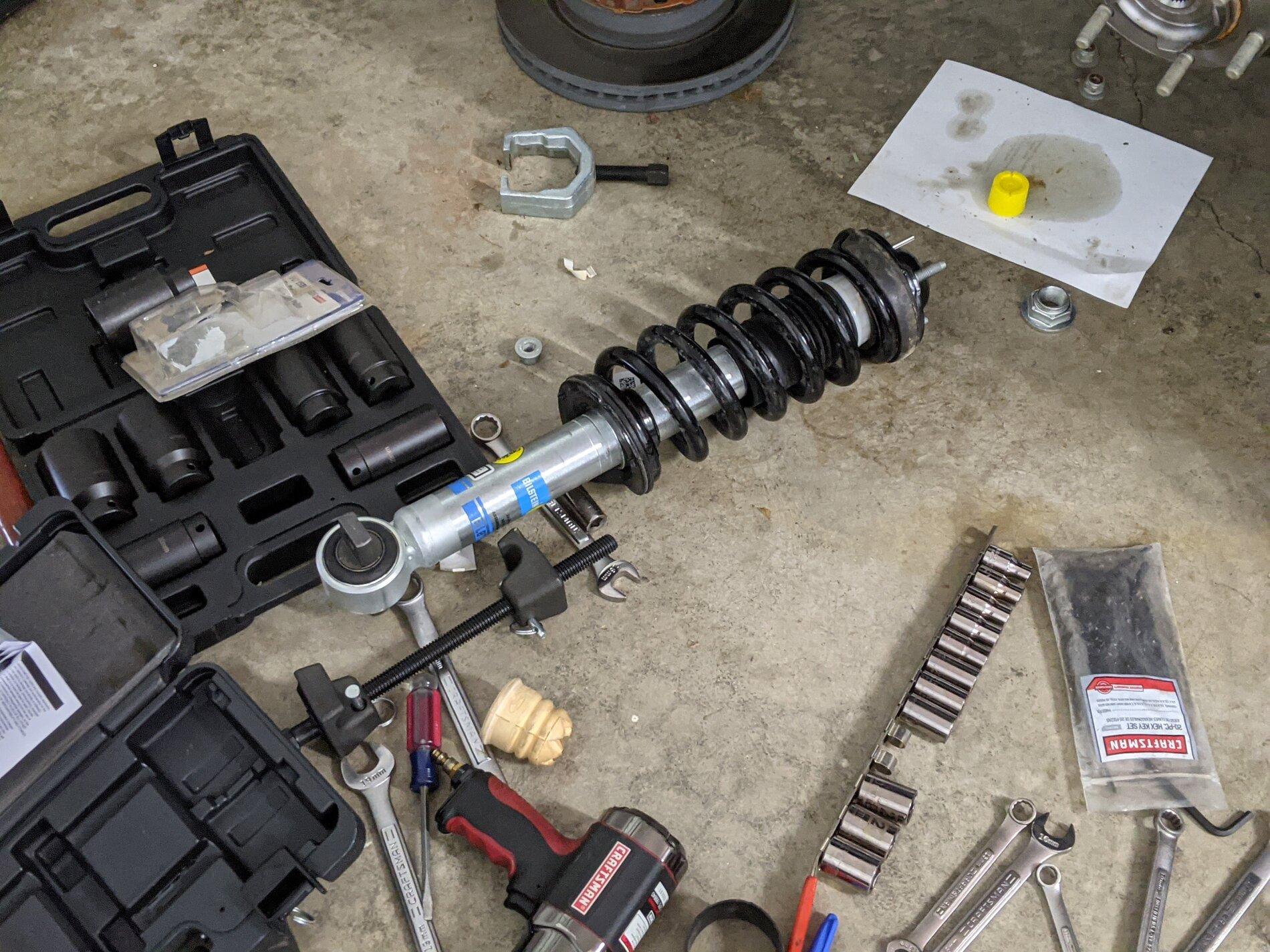

Not really. When I put the leveling kit in it only took me a little over 1.5 hours using hand tools and an electric impact. The hardest part and what took the longest was reinstalling the strut assemblies by myself. Wasn't the easiest thing to get them reinserted and lined up without a second set of hands.
And if you want to talk a lot to do, try replacing the front struts on a 2008 VW GTI. The Ranger is a cake walk by comparison.
Yikes is referring to having to "build" the front struts which requires a spring compressor and careful attention. Not the same as installing a spacer style level kit, you didn't have to break down your struts.
True, but it only takes a few extra minutes to pop a strut/spring assembly apart with the tool and swap it over to the new strut. The tool can be rented at nearly every local parts house for free or very cheaply.
Yup not that hard.
In my case the crazy ball joints were more of an issue than the spring compressor
