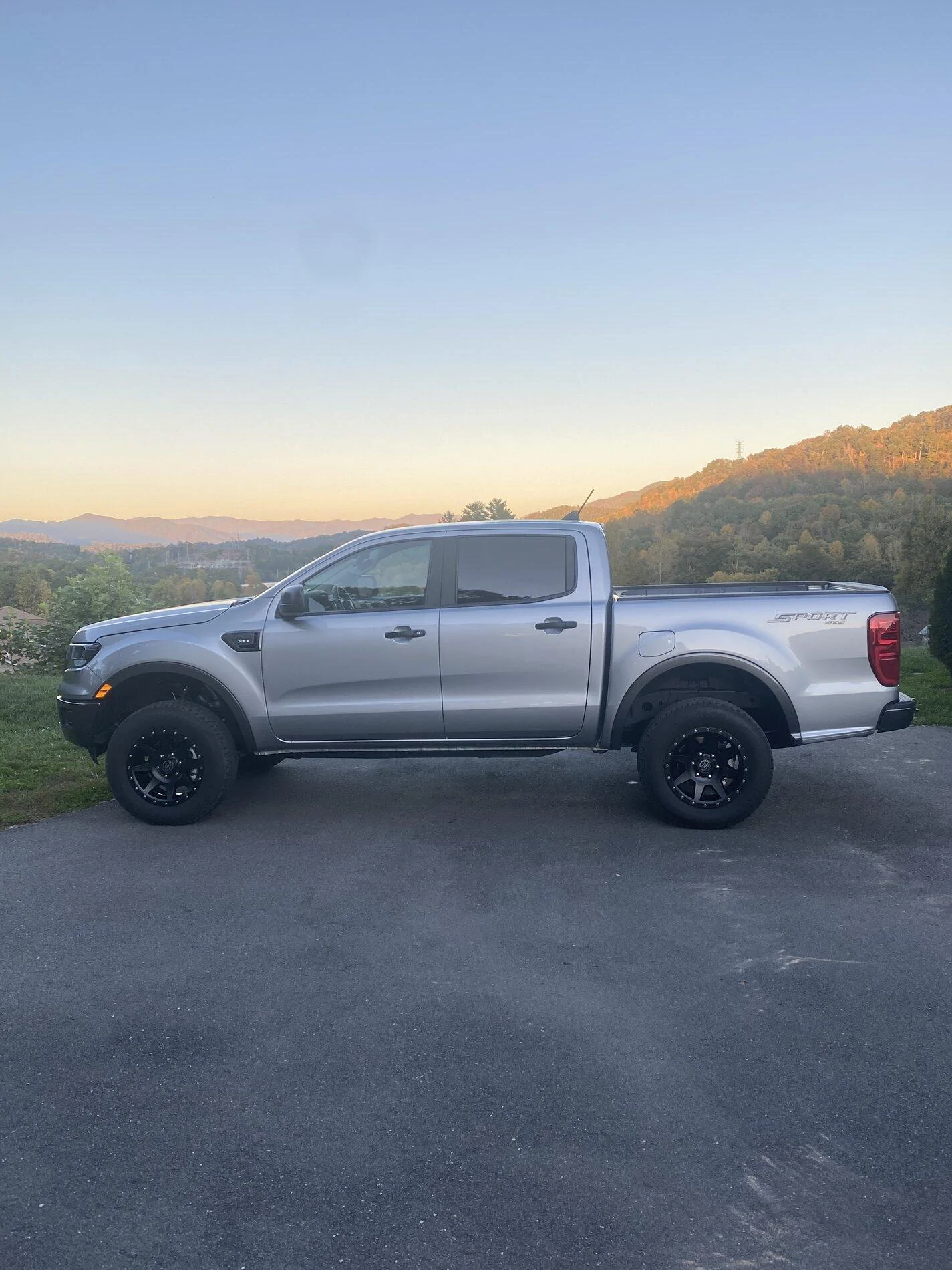

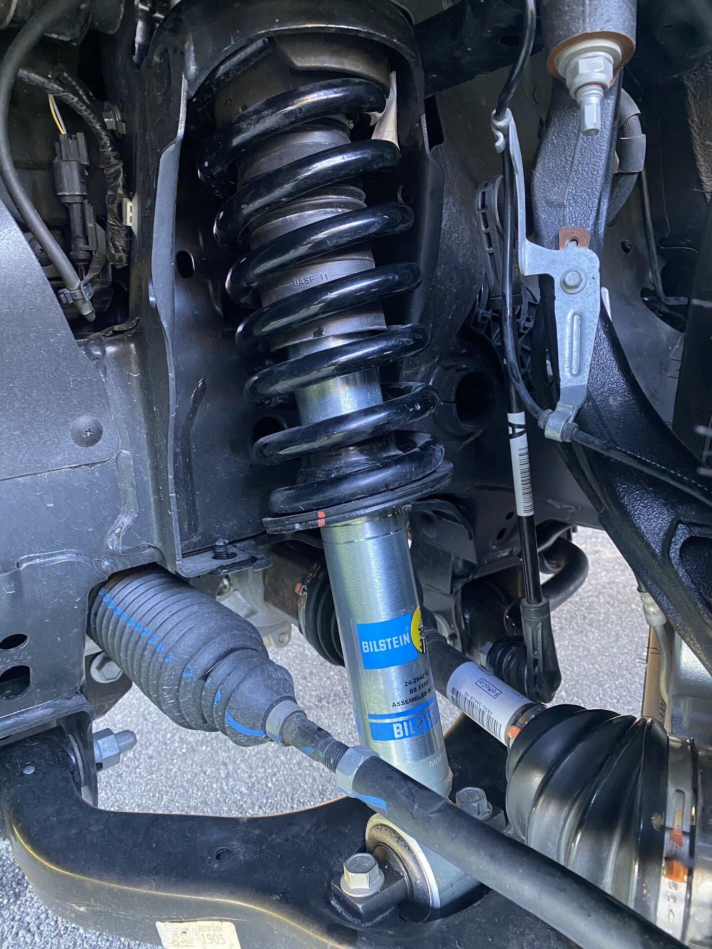

Just so Iā€™m understanding this kit with stock springs will give me a coil over like level lift? With needing spacers?
I set my front Bilstein 5100 to the third slot up (1.2) , it gave me 1.5 front lift according to before and after measurements, also reusing factory coils, just the right amount of leveling and the ride is far superior, also the shop charged me for 3 labor hrs at $80 hr in NC.
Looks perfect to me.
exactly what I was thinking, although I will be going to the full 2.5ā€. Yours looks really good Iā€™m planning on changing out the crash bars and going with 285/70/17 wild peaks with the lift.
