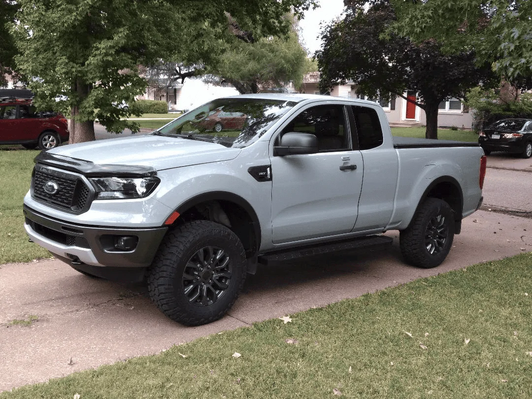

gonna have the bilstein front struts installed this coming week, and had a question so posing it here rather than starting a new thread or searching forever. i would like to go at the highest setting to to give me the max ~2.5 inches of lift. will any potential problems, in terms of stress to any suspension components, arise if i do nothing else to the front suspension, or should i just go with ~1.8 and call it a day. be gentle on me as i know little to nothing about suspensions in general. any offroad i do will be mild, just mainly doing it for aesthetic purposes. thanks

I went with 1.8 to avoid stressing the front half shafts. I figured since ford offered a 2" lift up to 2" probably doesn't stress things much. Lots of guys on here run 2.5 an 3. You might want to get the upper control arms to aid alignment.

went with the 1.8" setting up front. have about 1" of rake. dont mind a little rake, just not the 2.5-3" of it these trucks come with. love the stance and the ride. pretty big hit in the wallet with parts and labor but only gonna hurt once.
