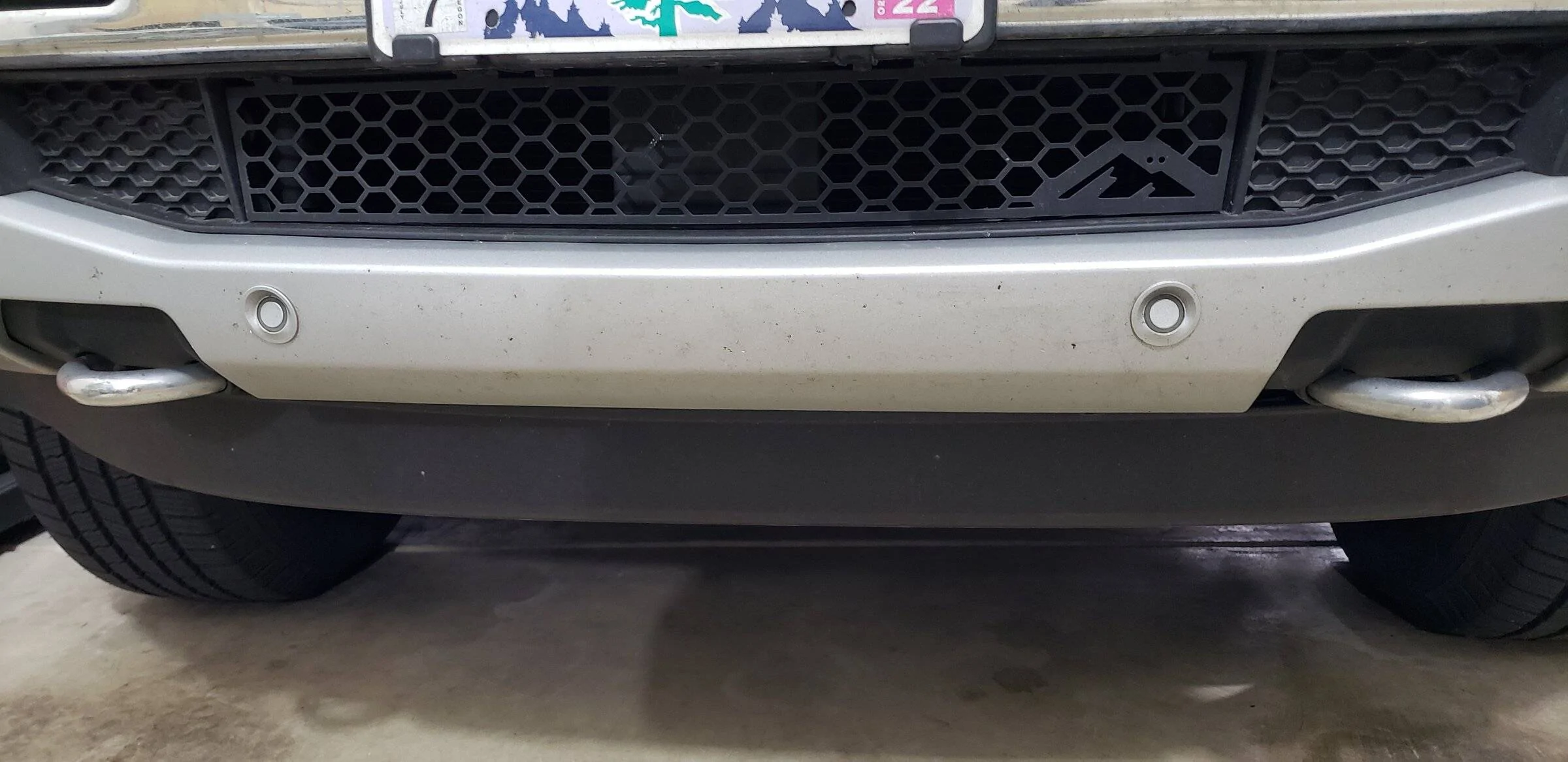

I decided to do this myself, and used the directions from the Ford "Fox Off-road leveling kit."
On a related note, I have since installed one of those grill kits, and it has had no effect on the ACC as well.
Hope this helps.
Yeah I just installed the ‘Merica lower grille guard and no effect on ACC and installed in about 4 minutes.
