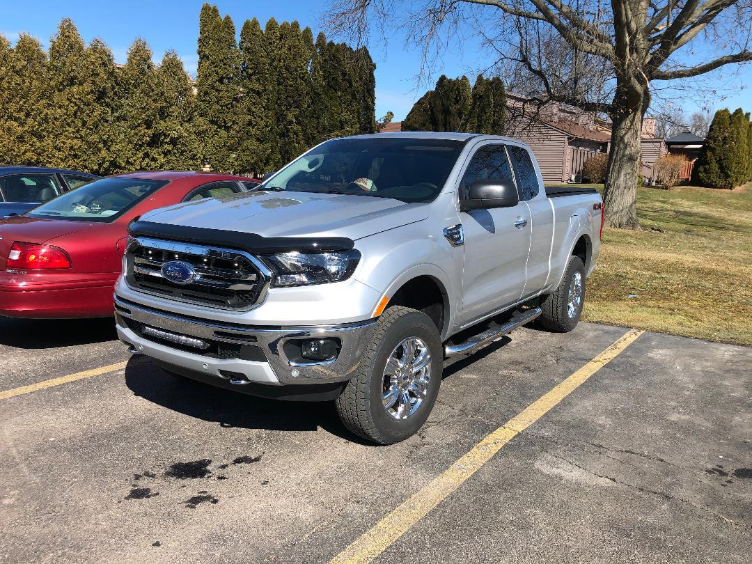

Have any pics on level ground? I'm almost certain to go with the ~1.8" setting.

I wish there was a 2" option but this is close enough.

That looks good! I still want to maintain a tad bit of rake.
