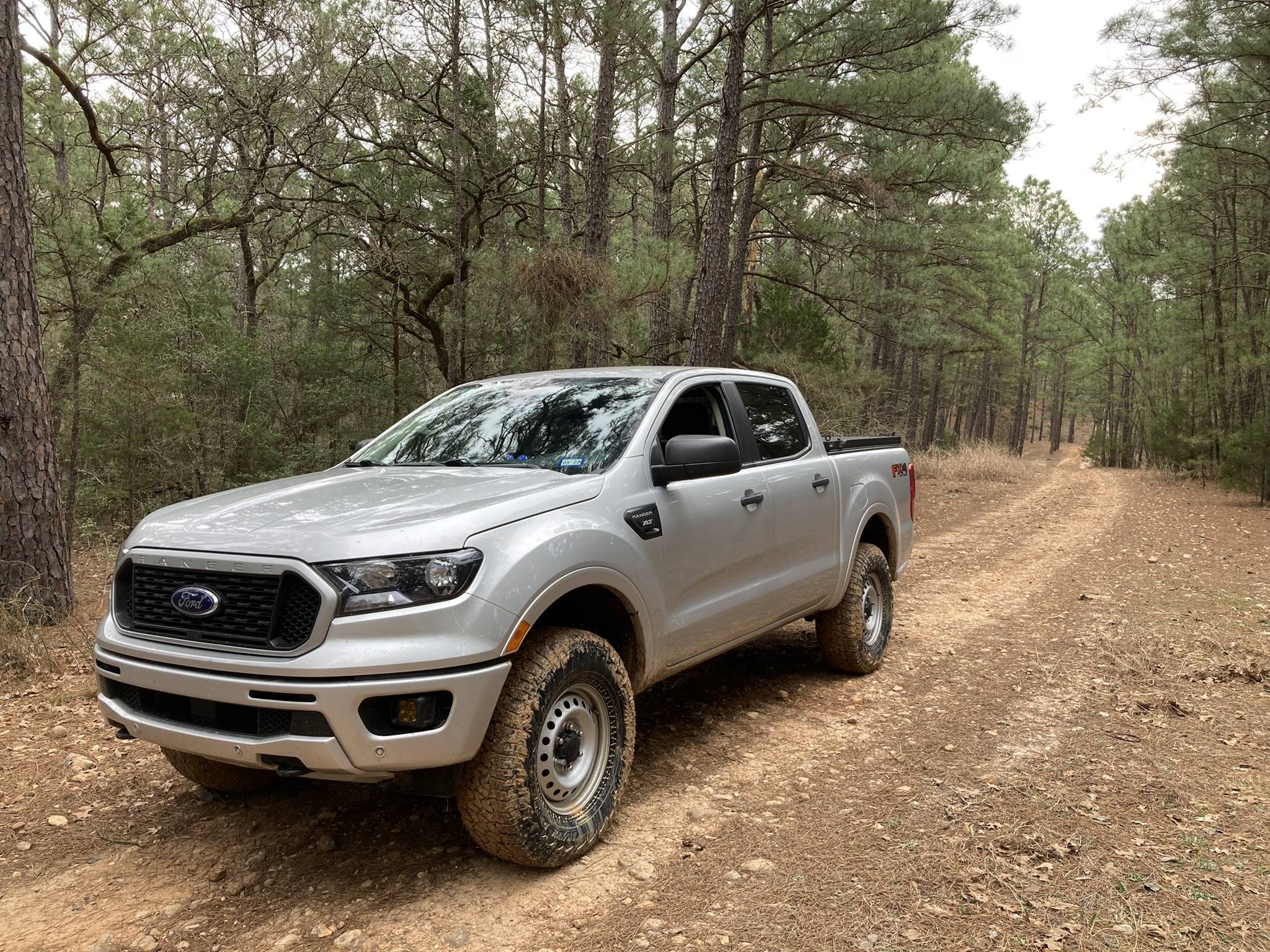

Confirming 265/75/16 wildpeak fit on stock wheels, crash bars in tact etc etc. Eventually lifted ~1.5 but I had no rubbing at stock height
Looks great, thanks.

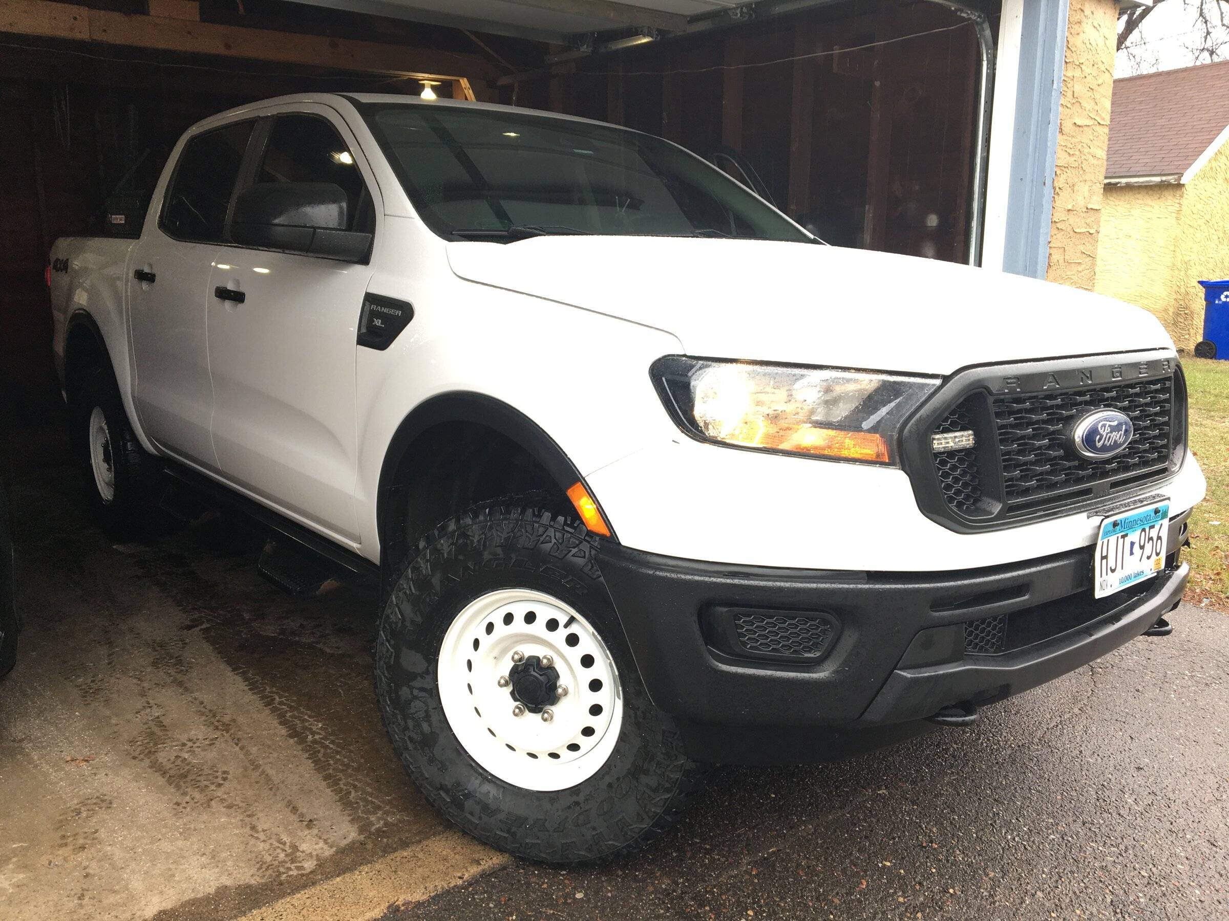

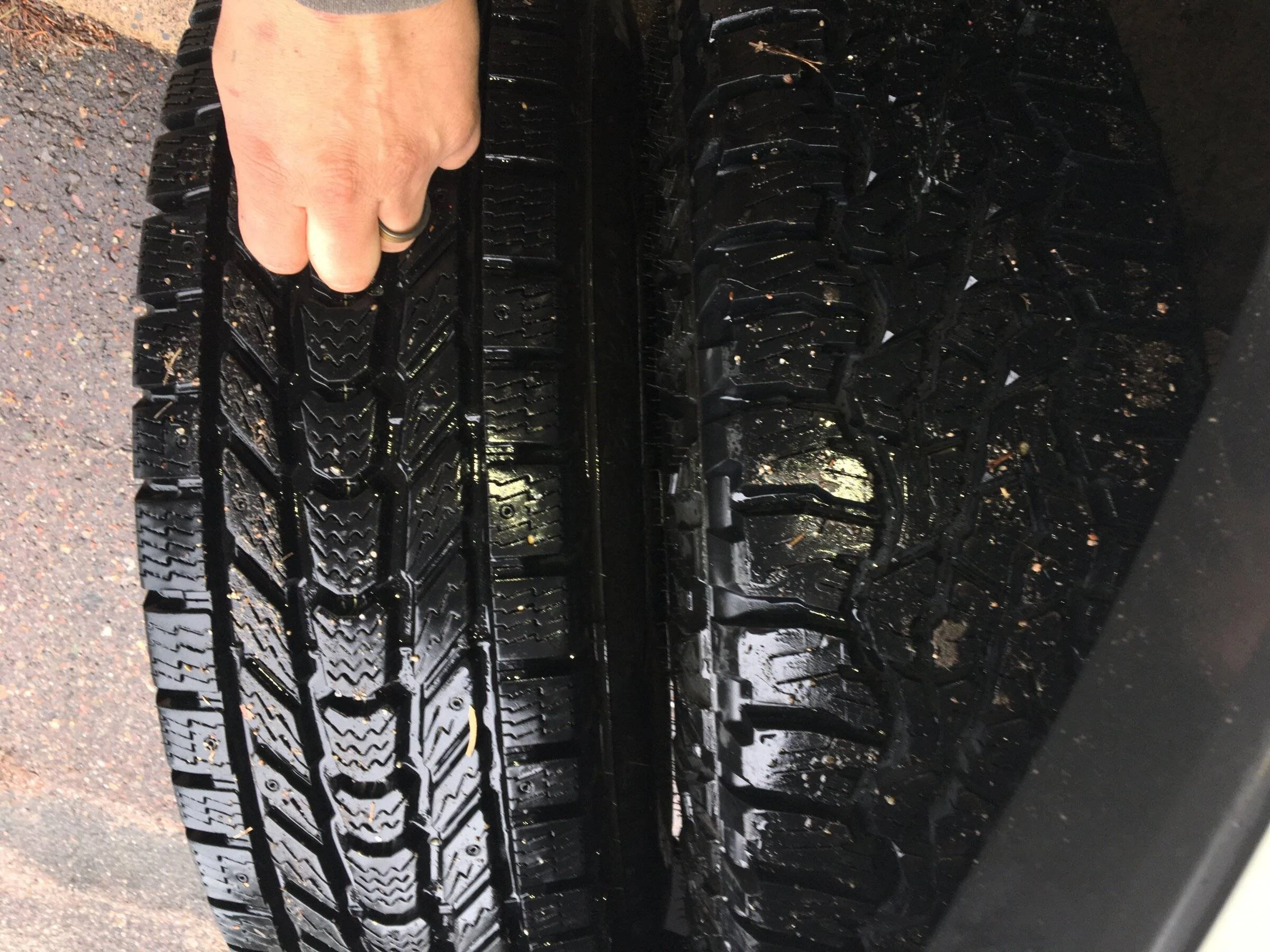

265/75r16 Goodyear ultra terrain, load range SL. Pictured next to my winter 235/85r16 Firestone winterforce.
