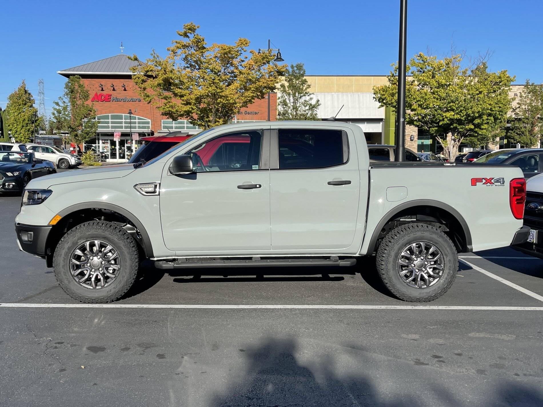

I’ve lurked here for what seems forever before deciding to pull the trigger on 265/70/17 Goodyear Ultraterrains. Almost did the KO2s again but I thought I’d try these this time because theoretically they handle rain better, and that might be a good thing here in in the Portland Oregon area. We will see. No lift - stock suspension, stock wheels, no rubbing.

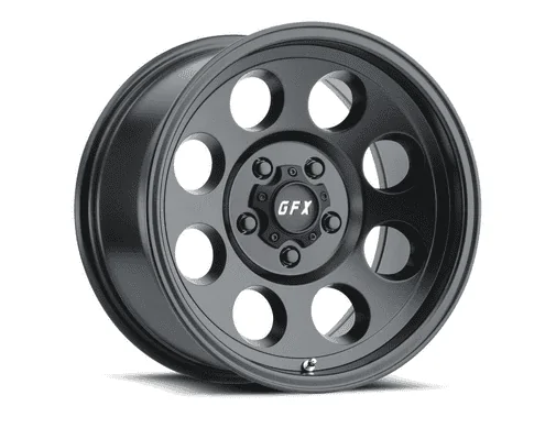

After seeing your post, I just pulled the trigger on the same set of tires. Going to have them mounted on Voxx GFX wheels. Will post pictures later.

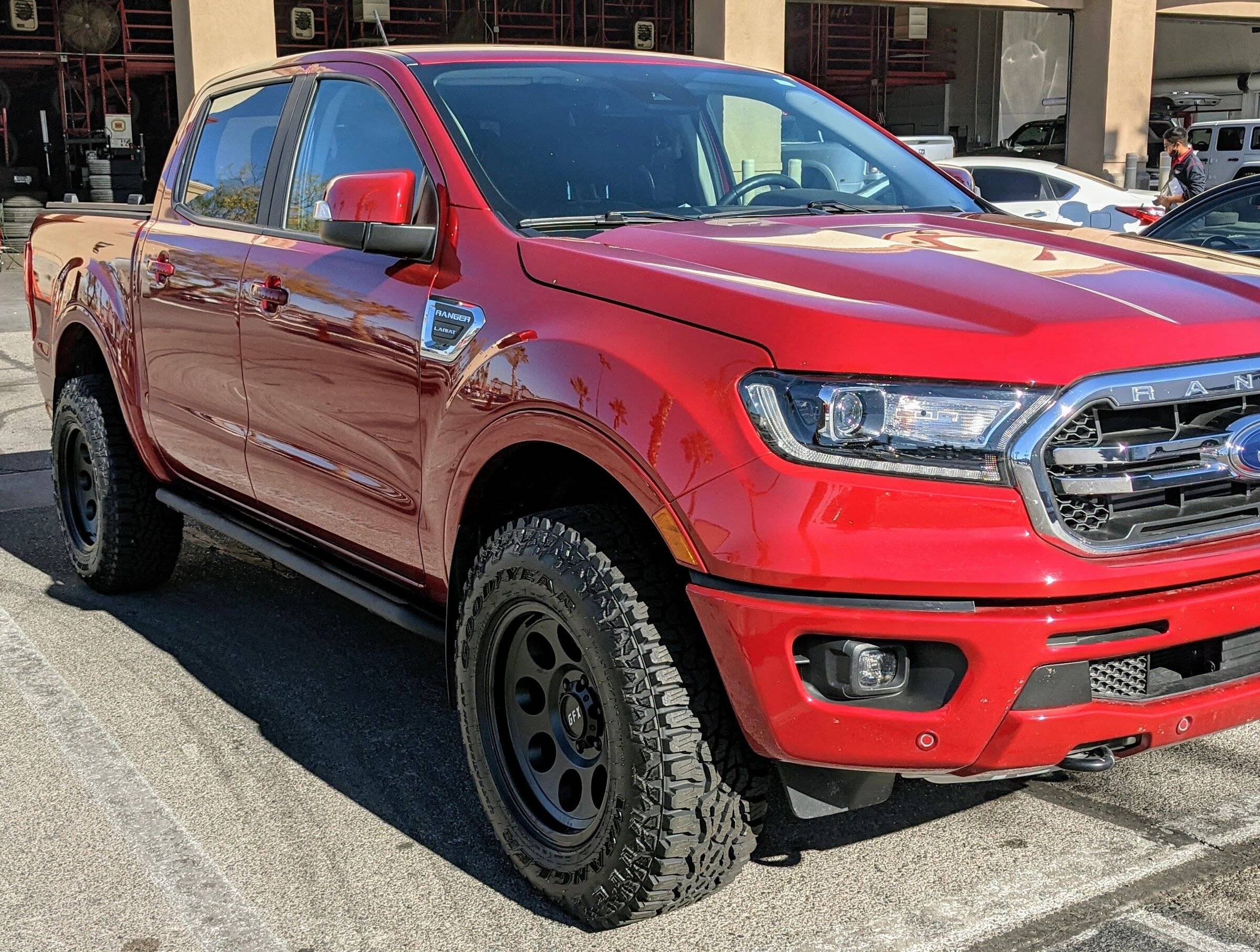

Update: just had the 265/70/17's installed and they are rubbing both left and right lock. Any suggestions? They look great by the way.
265/70’s don’t rub without some other variable. If you’re not running spacers, it is almost certainly your new wheels. What’s the offset?
Rubbing on crash bars? Some play in the front crash bars. Remove plastic cover and loosen bolts to slide forward. If that is not enough likely need to delete or replace them with lower profile.
The new wheels have a negative offset, not sure how much. That's most likely the issue.

Rubbing both front and back. Looks like I'm going down the crash bar modification rabbit hole I was hoping to avoid.

Yeah that negative offset is a big change from stock and will definitely cause clearance issues.

Just got off the phone with Discount Tire. The new wheels are 0 offset. According to their fitment guide need at least negative 36. Don't know where their fitment guide was when I ordered the wheels from them, but as always they are going to make it right.
Stock is +55. Won’t going more negative make the rubbing worse?
Those look sharp!!
