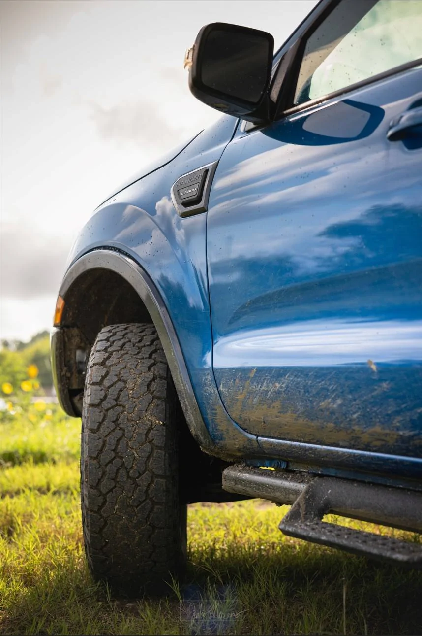

I just installed 275/65/18 Studded Cooper Snow Claw on my bonestock 4x4 Lariat. No issues or rubbing anywhere. Good to go.

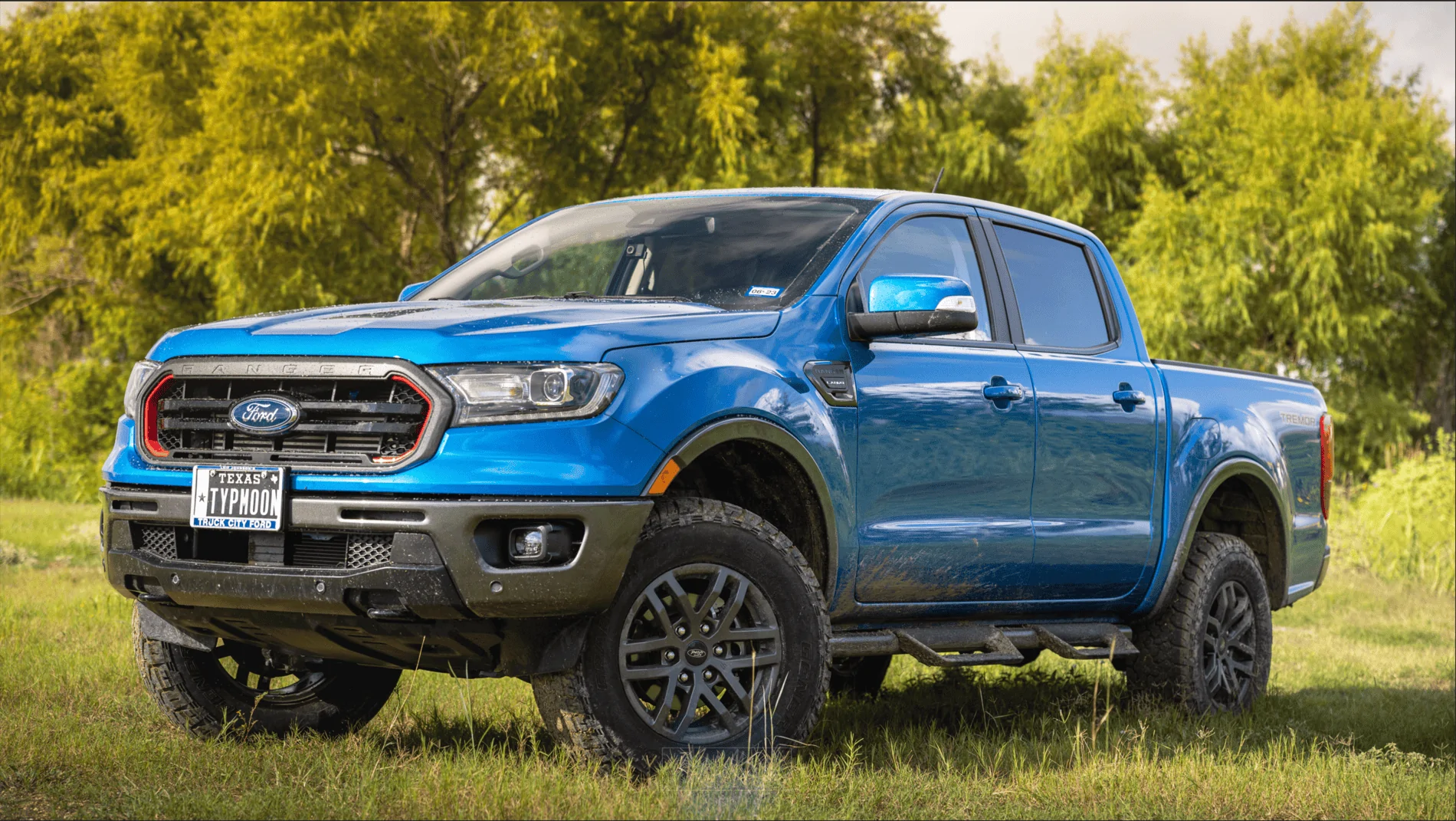

A taller tire would look better no doubt, however maintaining the performance of the motor is more important to me so these are only 31” tall.
[/QUO
Looks great. That's the size I want & I don't want to modify the suspension.

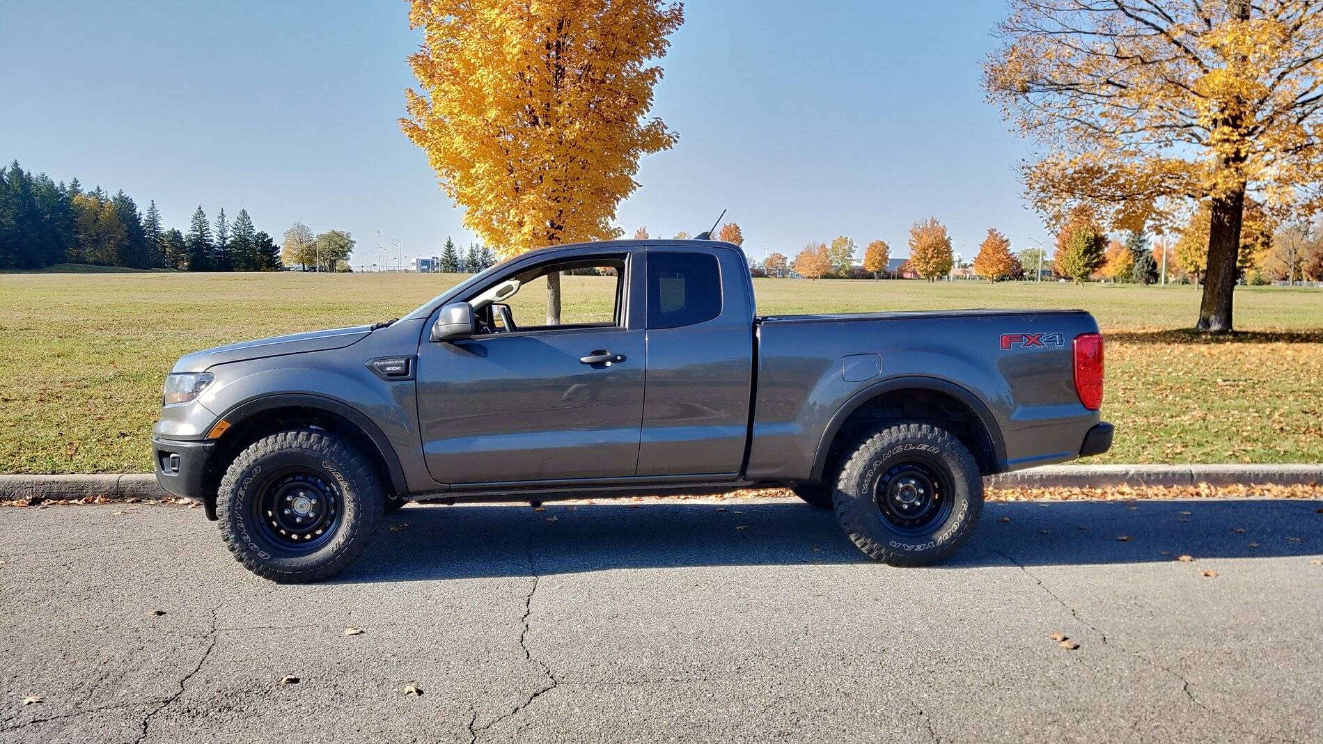

Finally got rid of the “car” tires that came on the truck. Stock tires lasted 1 year and 1 month to the day with 43,000 miles. 265/75/17 Discoverer AT3 4S make it look way more like a truck. Just a little added side wall and the tread pattern look way better!!

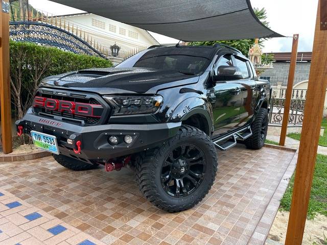

I just sold this amazing truck because i used to worry for absolutely no reason at all that the suspension/wheels/Tires were going to fail at speed (Like 70+ mph) so I sold it
I am waiting for the next Gen Ranger Wildtrack that should be available in Thailand in April/May this year...........I will definitely add a few bits and bobs including Fuel Wheels and new tires but I wont do anything with the suspension...........Im thinking 265/55/r20
The new ranger from what I have seen on the web looks pretty cool...........like this but hopefully in light blue

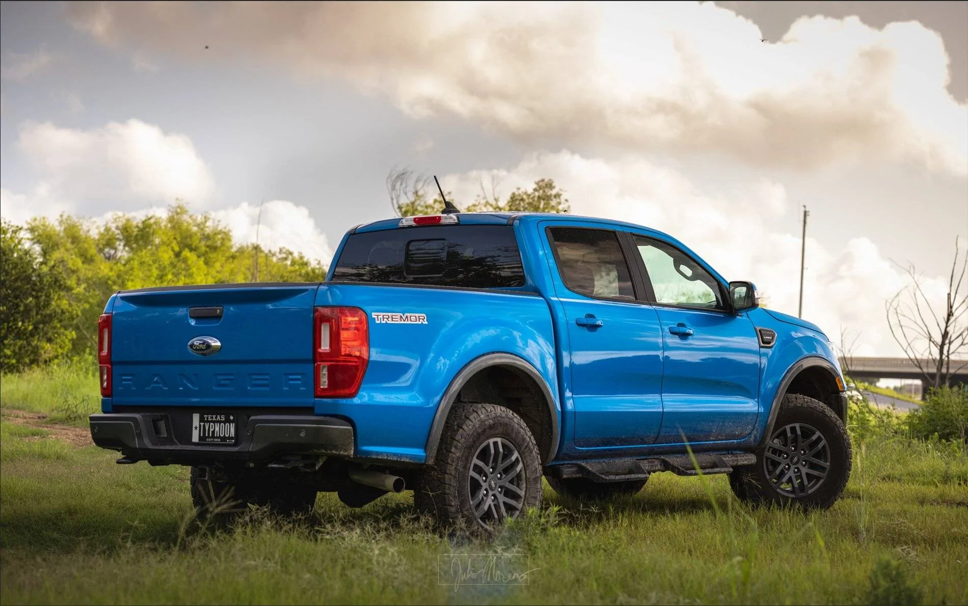

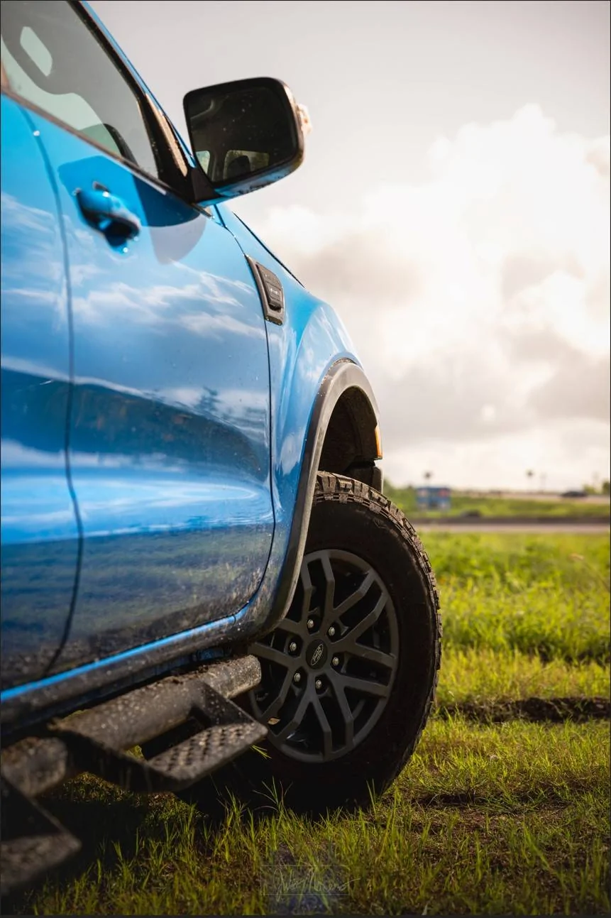

Ford Raptor Adventures on Instagram put 285/70/17 KO2 on his stock Tremor. Not sure if he deleted the crash bars or not but he is fine at stock height. Awesome video clips on his IG too.
