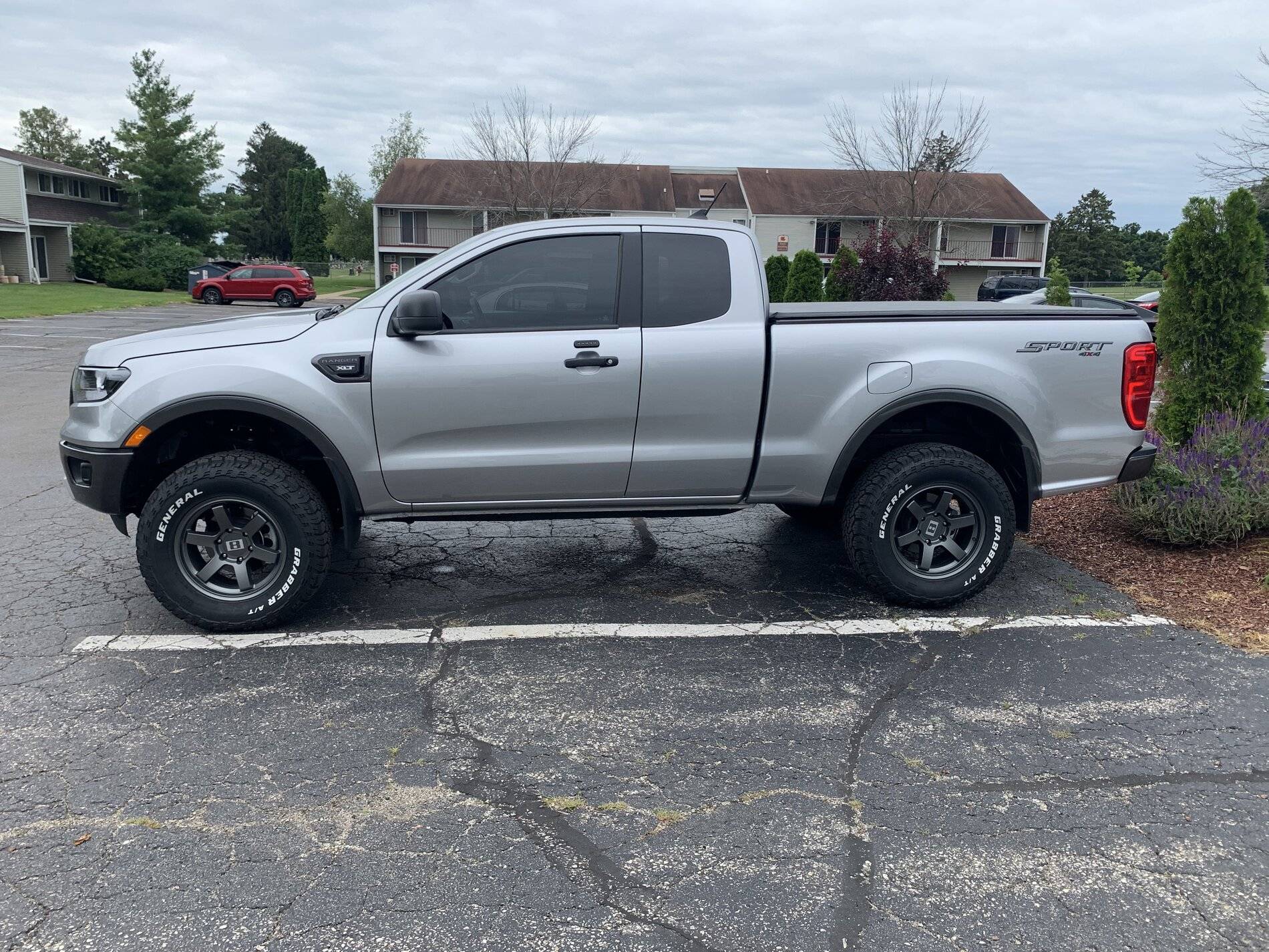

2.5 inch level and 1inch rear blocks. 265/70r17 general grabbers on 17x8 0mm off set. Once suspension settled it rubs ever si slightly in reverse at full lock. Would like to remove the crash bars are replace with high clearance ones and run a 285/70r17 in the future.
