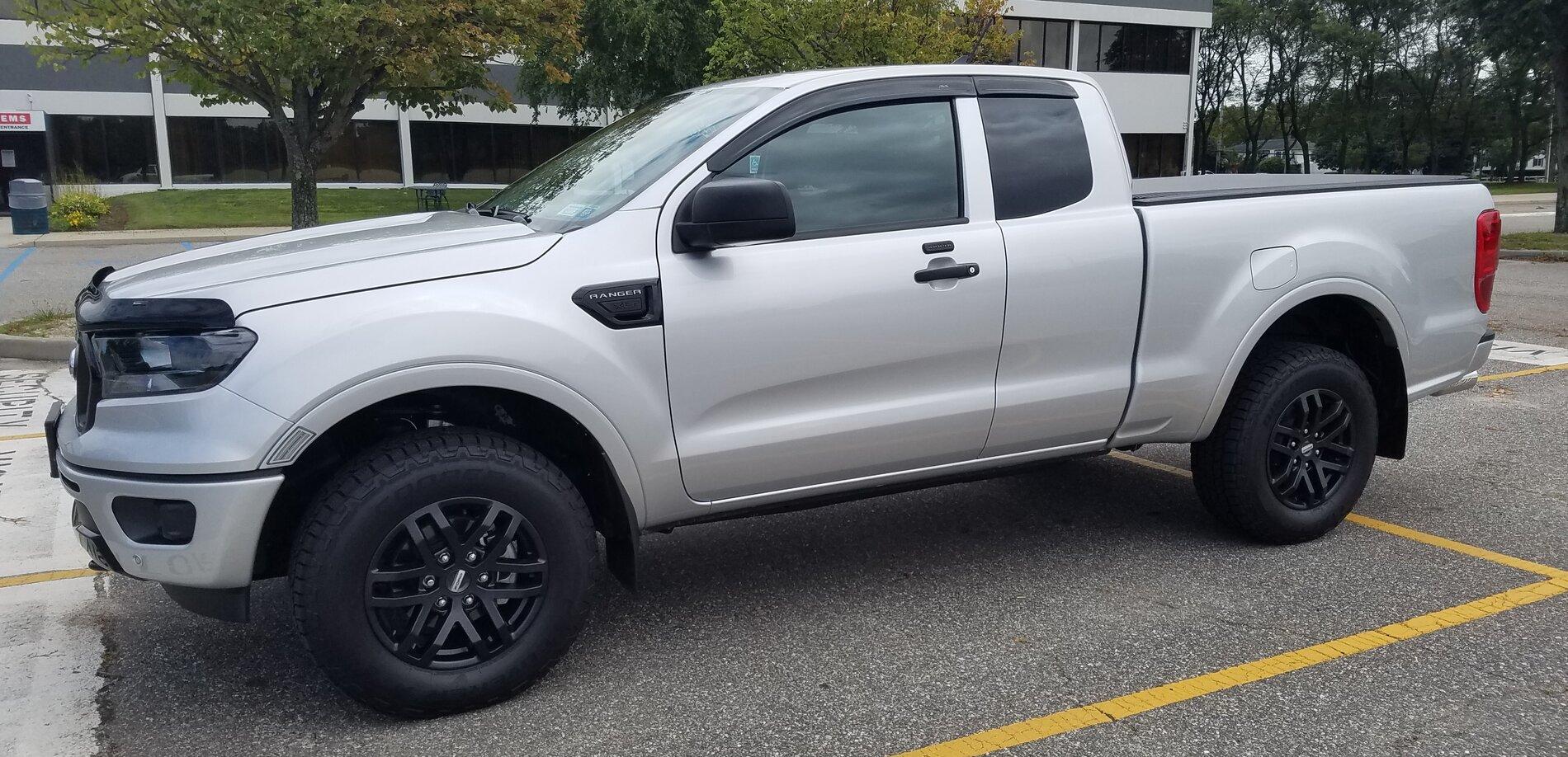

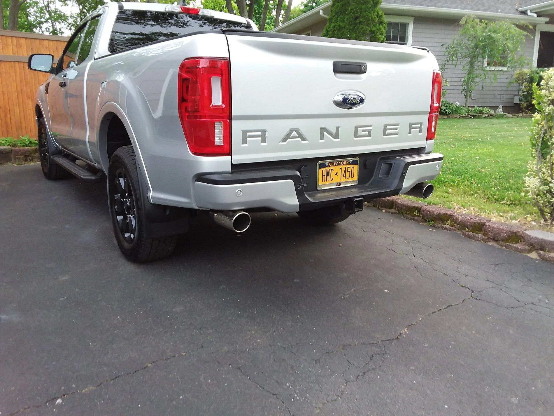

A taller tire would look better no doubt, however maintaining the performance of the motor is more important to me so these are only 31” tall.
I have exactly the same truck :)
Looks great. No rubbing at full lock? Nothing?

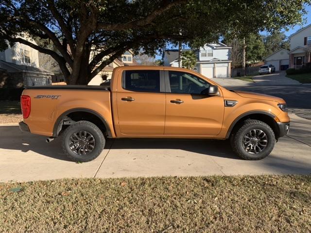

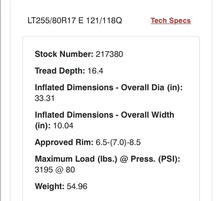

I’m running Nitto Ridge Grapplers 255/80r17 on factory STX rims. Just over 33” tall with zero rub full lock driving forward or backwards.
