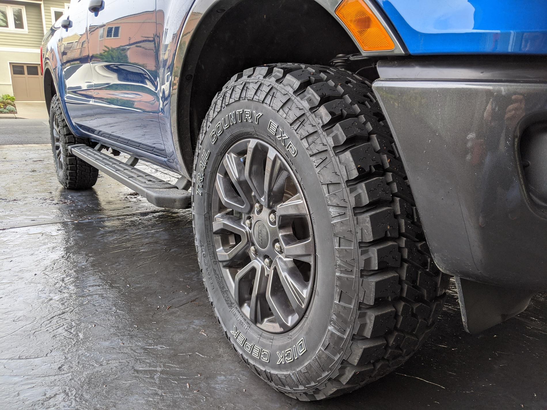

Your truck looks really good! I think that the tires and level kit makes a huge difference in the overall stance and ride. I have the Nitto Ridge Grapplers in that same size along with a 2.5" RC Level and have no rubbing issues. I still can't find the right wheels so I'm just using the stock sport wheels for now.
To bump your older post... You are running these tires and leveling kit with NO rub issues WITHOUT any crash bar mods?
26,371
132,883
Correct,I never modded the crash bars and no wheel spacers. I have over 2000 miles on them now with plenty off of roading and no rubbing issues at all.
