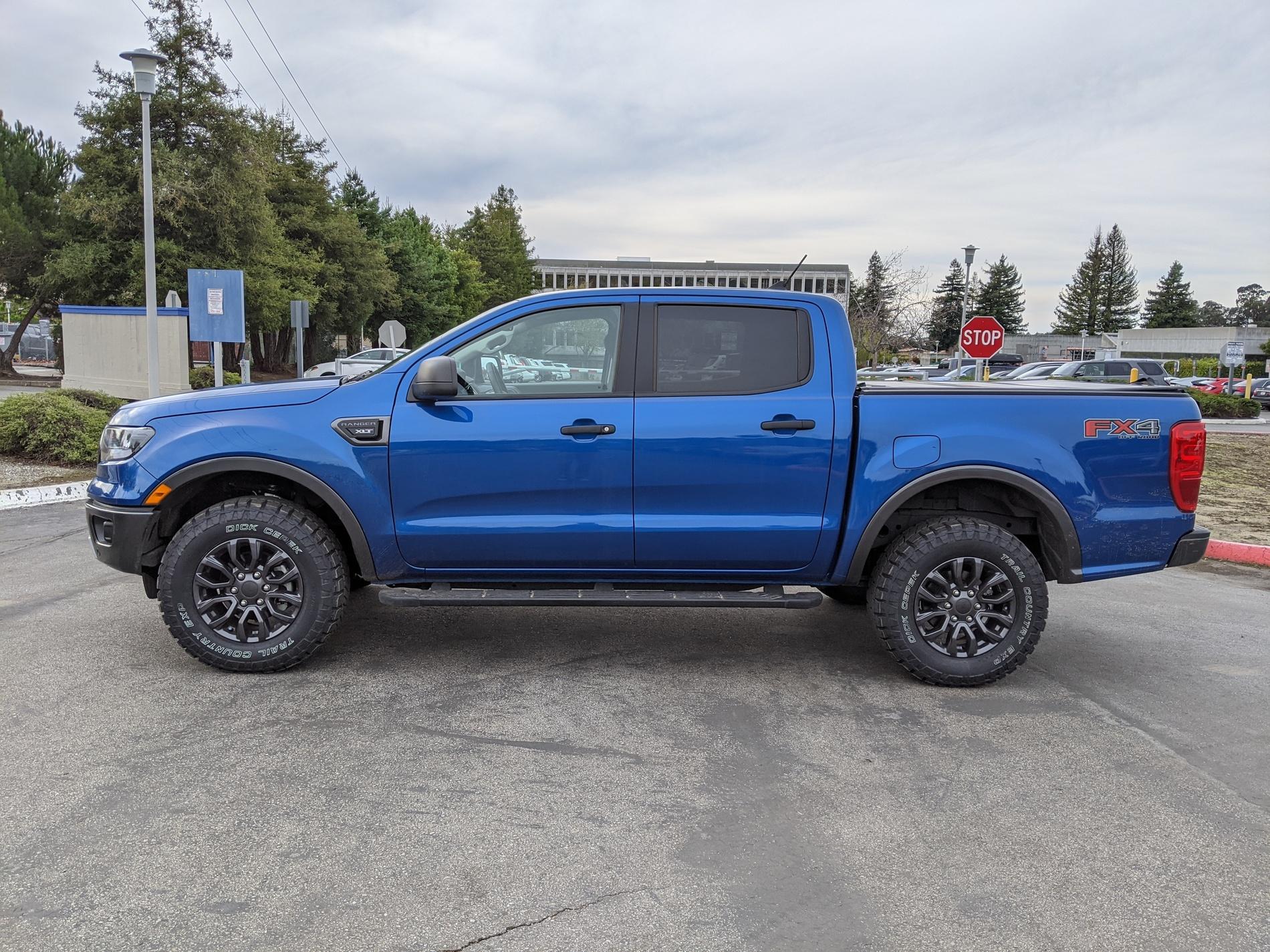

I installed some 265/70/17s with no mods, and no rubbing that I can tell in everyday use. I haven't put the truck through chassis-twisting trails yet, though. These are Dick Cepek Trail Country EXPs.

Hm, my xlt with a 21/2 inch fabtech level kit would not accept Les Schwab back country 265/70/17 Mt's without removing the front beams, the tread would not go past the crash beams and the beams go up inside the cleats of the tire making it impossible to run them, the cleats are 19/32 were as the back country AT's are only 15/32 , so that must be why the Dick Cepek Trail Countries must work; they are AT's right?
Geometries change once a lift is introduced - my truck runs the stock FX4 suspension. These tires are described by D/C as a hybrid between an A/T and an M/T, with a calculated circumference of 31.9", and tread depth of 18.5/32... not so different from your 19/32 tread-depth M/Ts. These tires are relatively quiet due to the closely-spaced center blocks, but retain aggressive shoulder blocks for trail-running and grip.

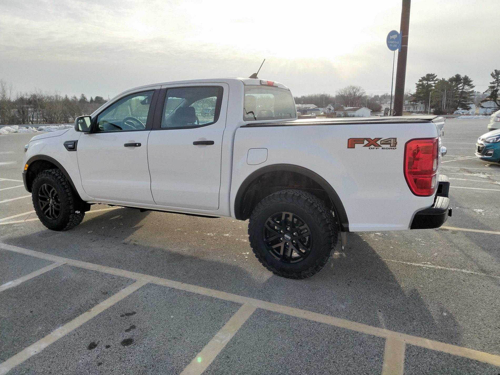

I've been looking through this thread and it seems like 265 70 17 is the biggest tire on stock rims and stock height. Is this only for Fx4 or does this include non Fx4 models?
255/75 r17 fits stock wheels and suspension with crash bars in place. It’s about .5 inch larger diameter than 265/70 r 17 tires.

255 is a section width, not a tread width, it's 10mm narrower in the widest part of the tire than 265 section width tires. the tread of any given 255 section width tire varies depend on the tire design. These GY Duratracs have a 7.5 wide inch tread. BFG TAKO2 of the same size (255/75 R17) have a 8.1 inch wide tread. This is not what you notice.
Notably: The extra diameter slows acceleration somewhat, and depending on the tire, your results will vary. I chose an SL (standard load) tire that weighs only 40 lbs even though it's 32" in diameter.
