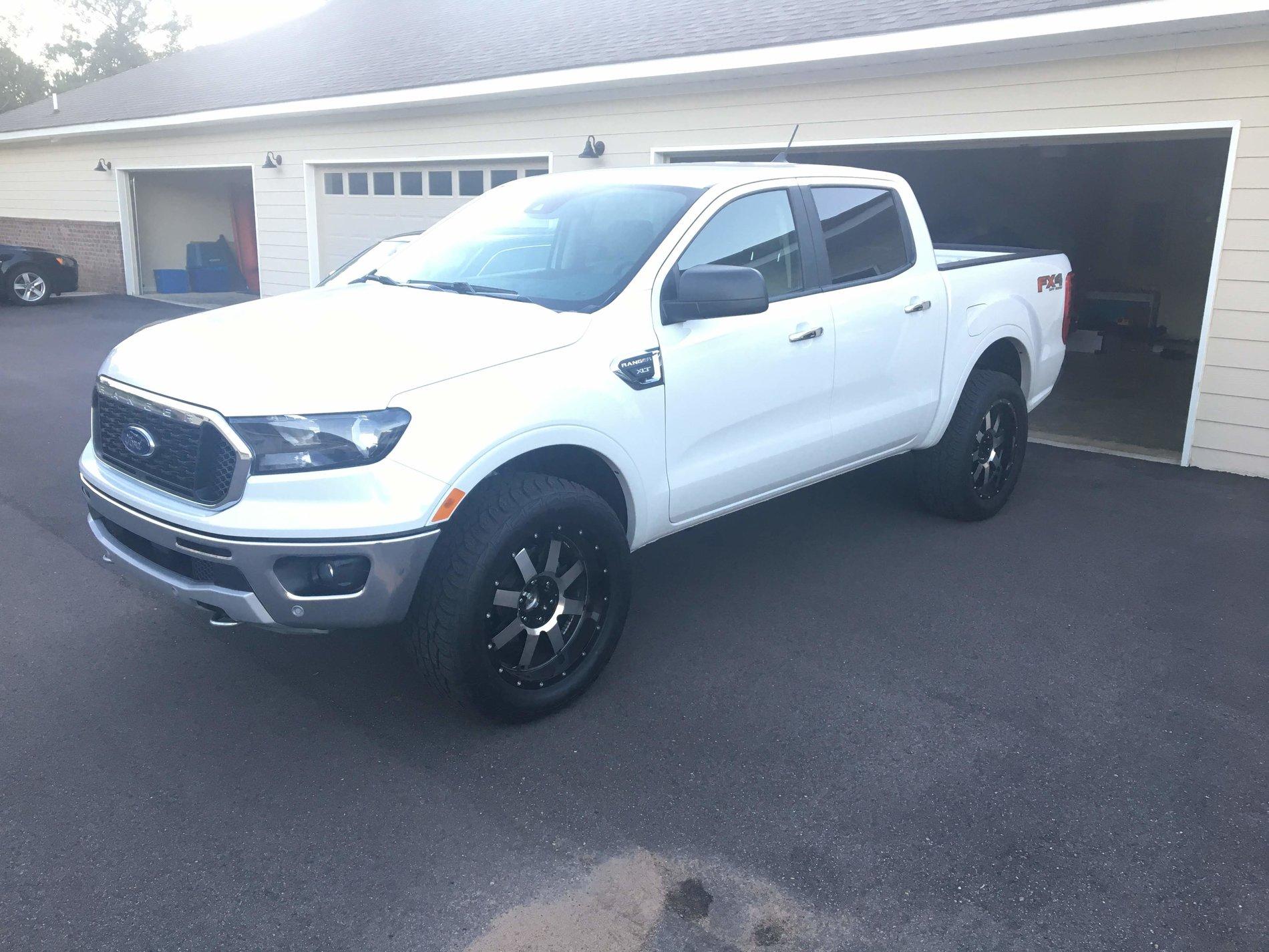

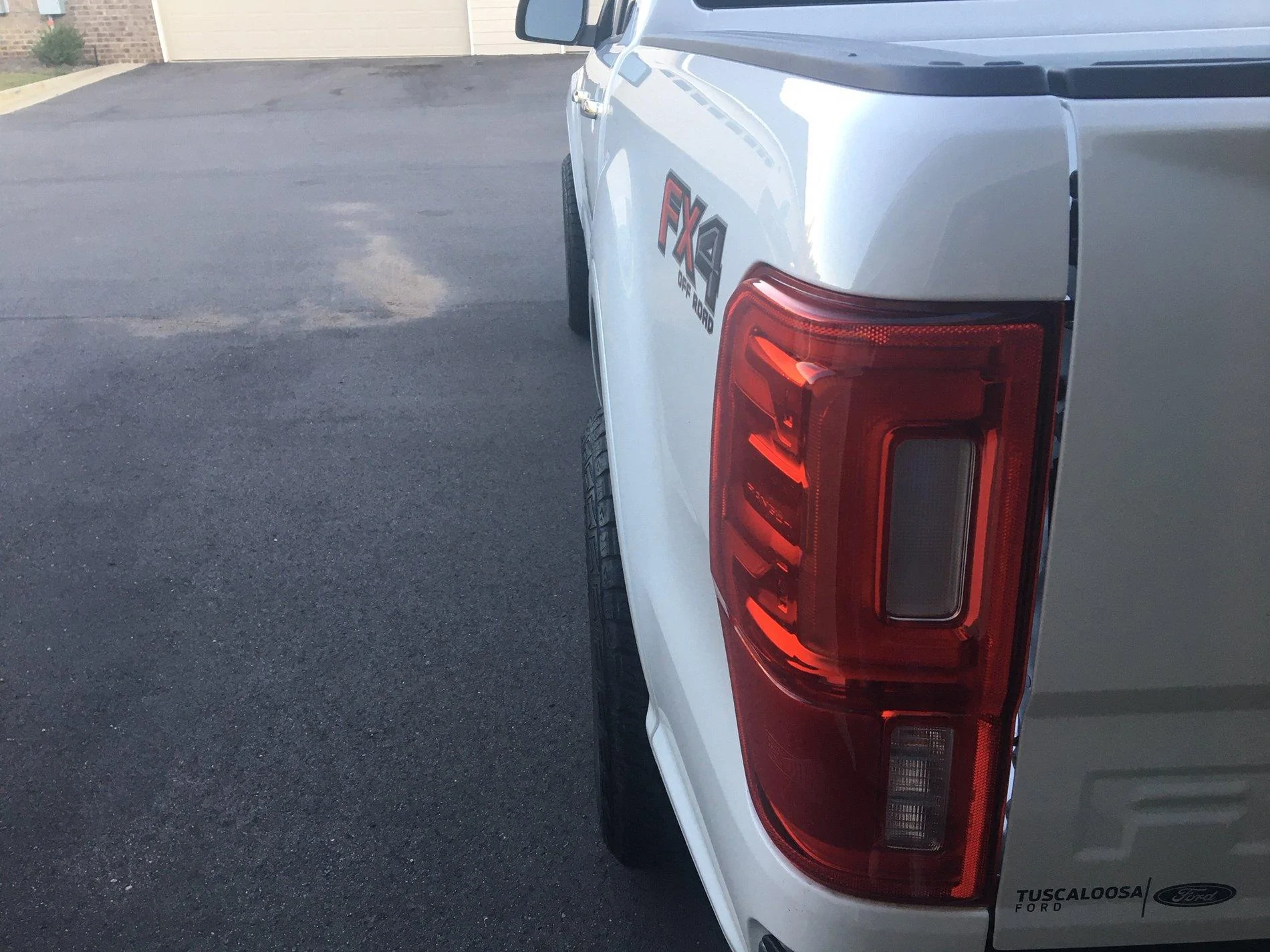

since yesterday i have my old Tacoma wheels on. No lift, crash bars removed, no rubbing
9x20 ET18 with 285/55

After 300miles with this tire/wheel combo, a little rubbing inside the fender, but only during braking and a certin wheel angle

I'm glad you posted this. I was wondering if anyone tried it yet (Tacoma/4runner) rims on our trucks. I think the Tacomas have a stock offset of 35mm, so that would make it perfect (out about an inch or so). With the 18mm offset, how much does the tire stick out from the fender? Thanks!

It sticks little bit less than a 1/2inch out. I used hub centric rings to center the wheels because Toyota / Ranger have an different center hole. I will get this week my 3" leveling, after them I can maybe use my 1,25 spacer as well, currently no way
