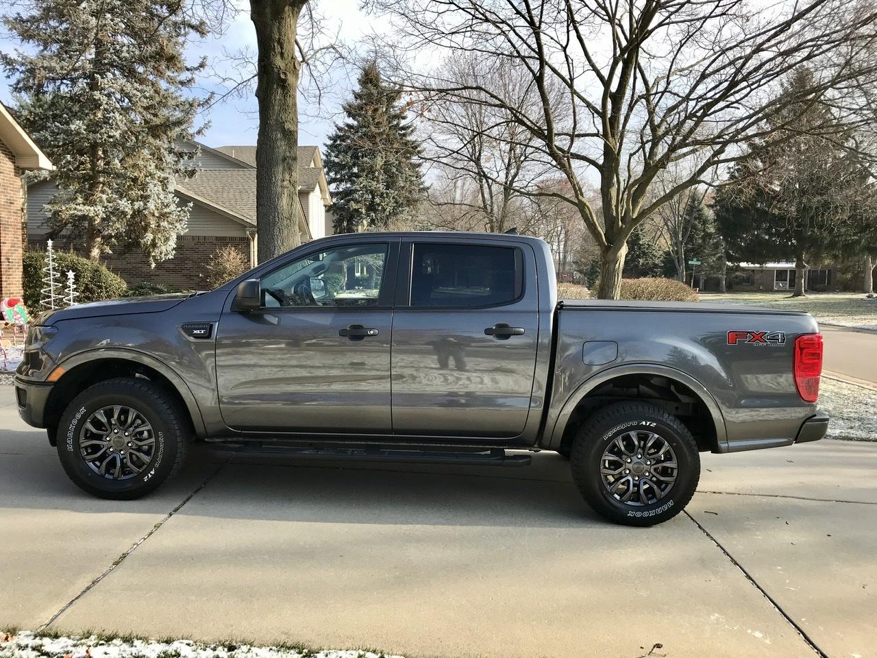

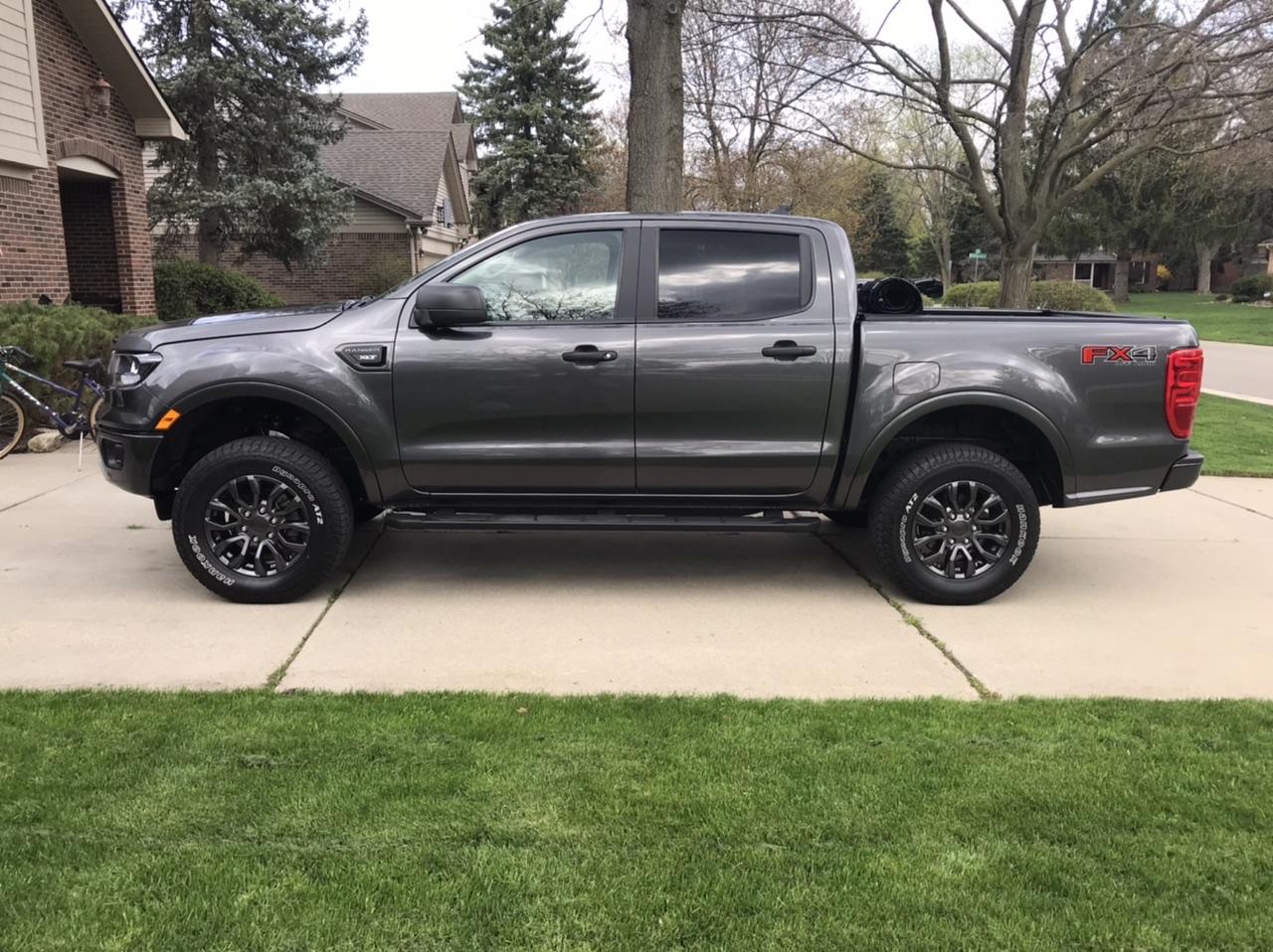

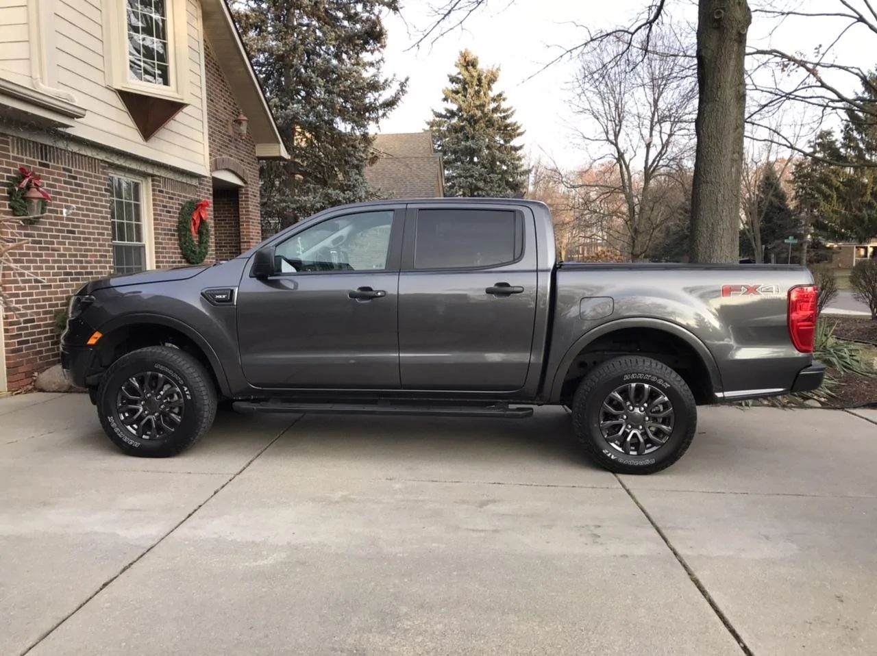

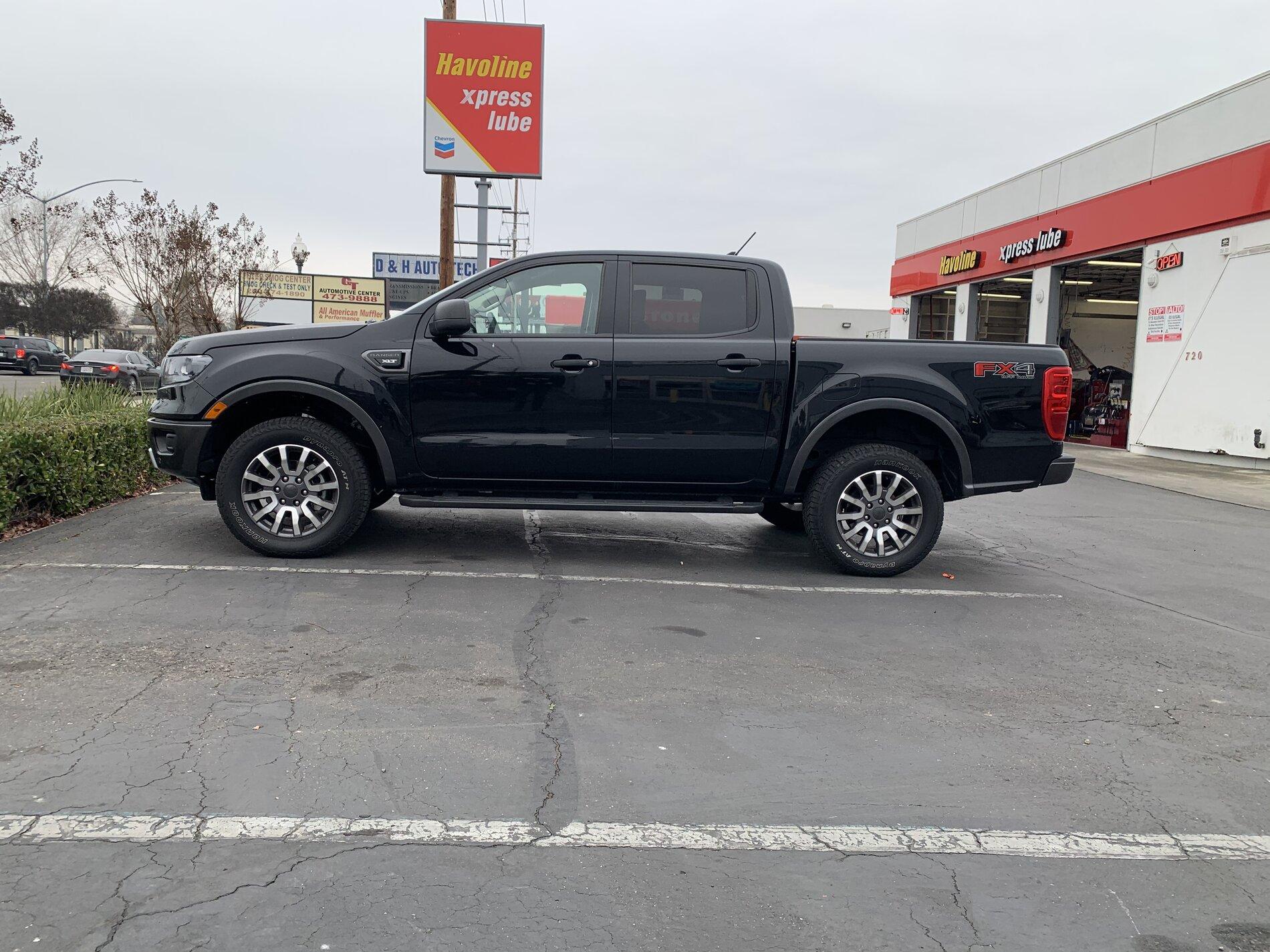

Posted these originally on another thread and thought they might be helpful for someone looking here.
OEM 17 inch wheels and OEM Hankook Dynapro AT2 tires
First pic = stock
2nd pic = ReadyLift 2 inch level
3rd pic = Rough Country 2.5 inch level
Very helpful. Just now debating 2" vs 2.5". Which did you prefer and why?
I'll give you my .02 which might be all it's worth. ?
I went with the 2.5" because it brings the front closer to level. It's still about 3/8" lower than the rear but by eye you can't tell. If you're going to be hauling heavy stuff you might want to go with the 2". This way when the rear sags from the weight the front won't be higher.

I agree with Dave. I most definitely prefer the 2.5 inch level for pretty much the same reasons. From a looks standpoint, almost all of the rake is gone making the truck look more aggressive but the rear is just a bit higher.
A note - the ReadyLift 2 inch only provided me with no more than 1.5 inches of 'lift' and there was still a noticeable rake that 'bugged' me. The Rough Country 2.5 inch that I used provided a true 2.5 inches.
My only hesitation on going with a true 2.5 inches would be if you are planning on retaining the OEM tires.....in my case, my truck came with optional Hankook Dynapro AT2 (not the ATM)....I think they look fine but once they wear I will not hesitate to go up a size!

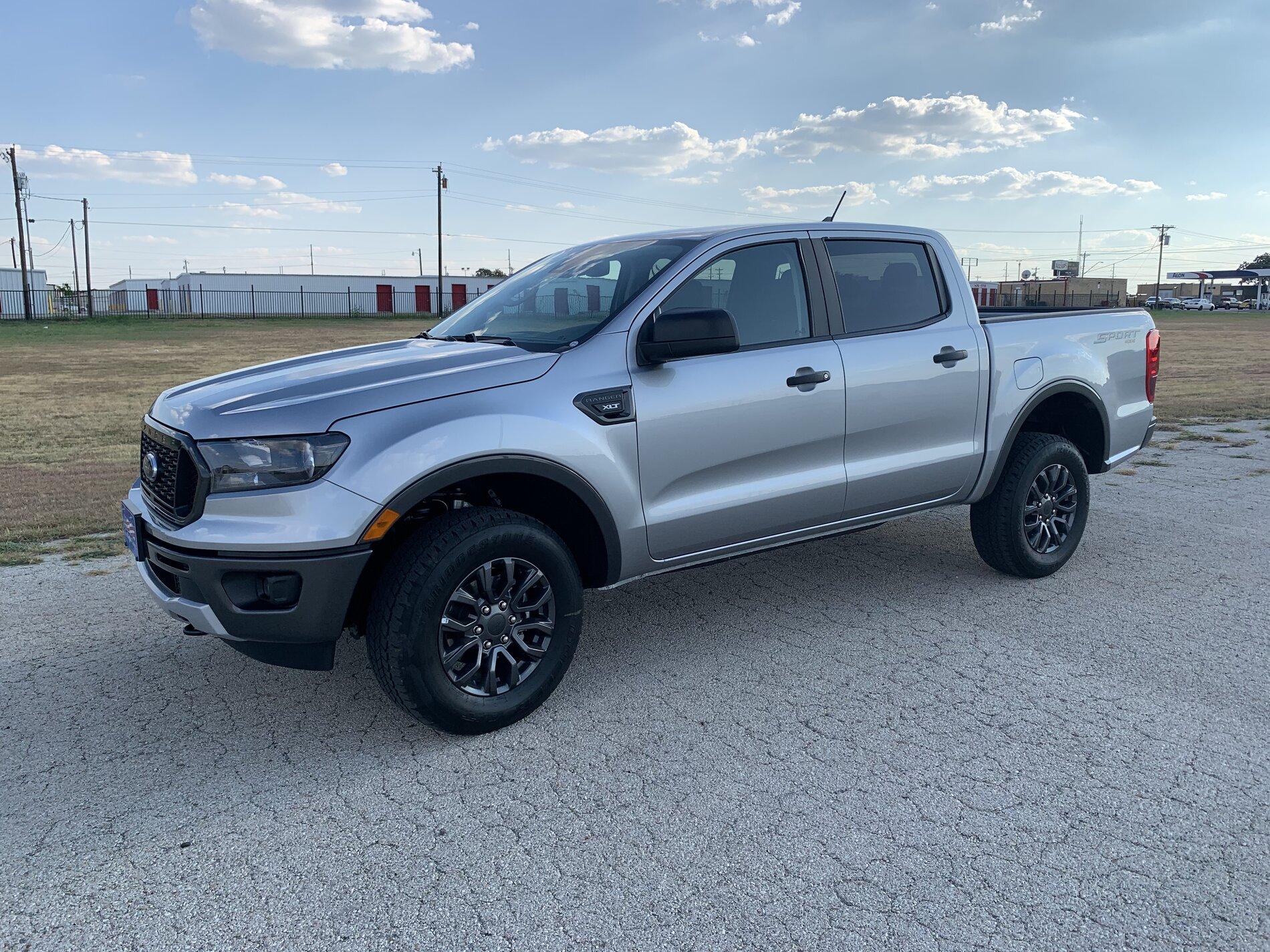

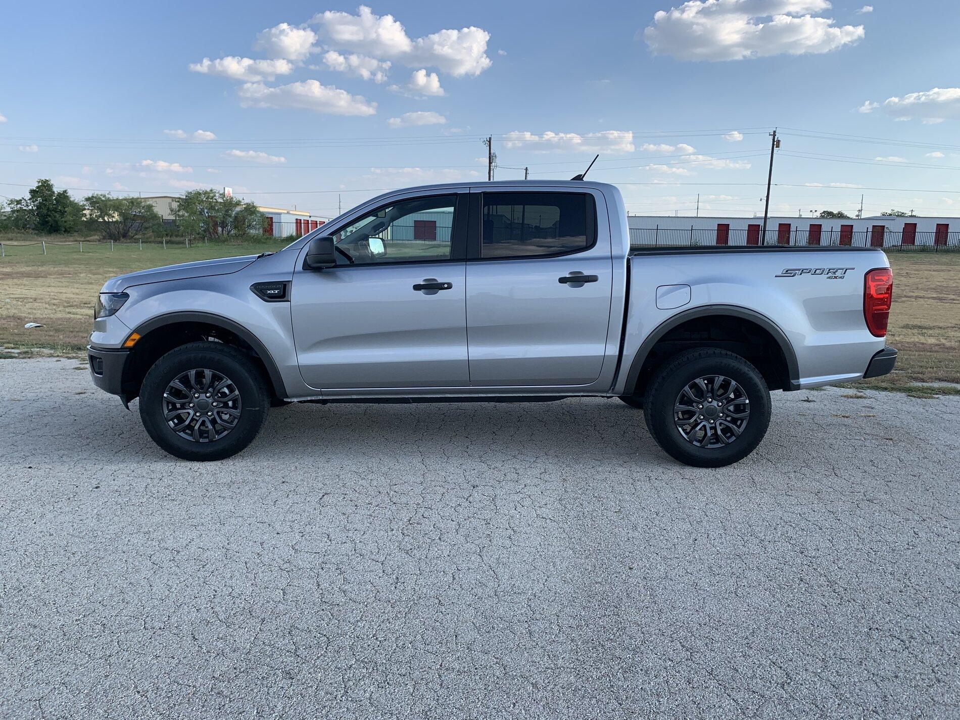

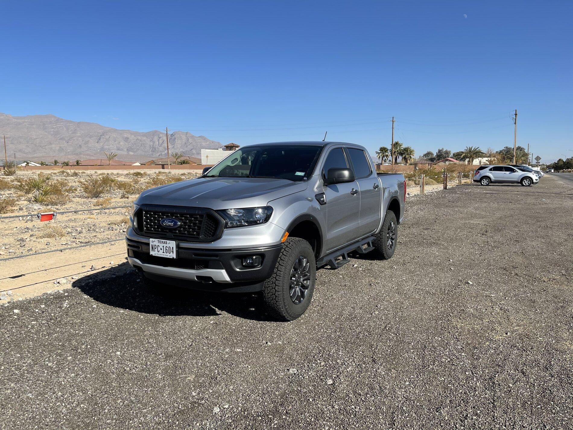

Before and after!
Bilstein 5100 all the way around 2.5” level in the front.
Icon rebounds 17x8.5 /0/offset
Toyo open country At3 285x70x17.
I love that it looks and rides like a completely different truck
Ps the running boards are gone now also.

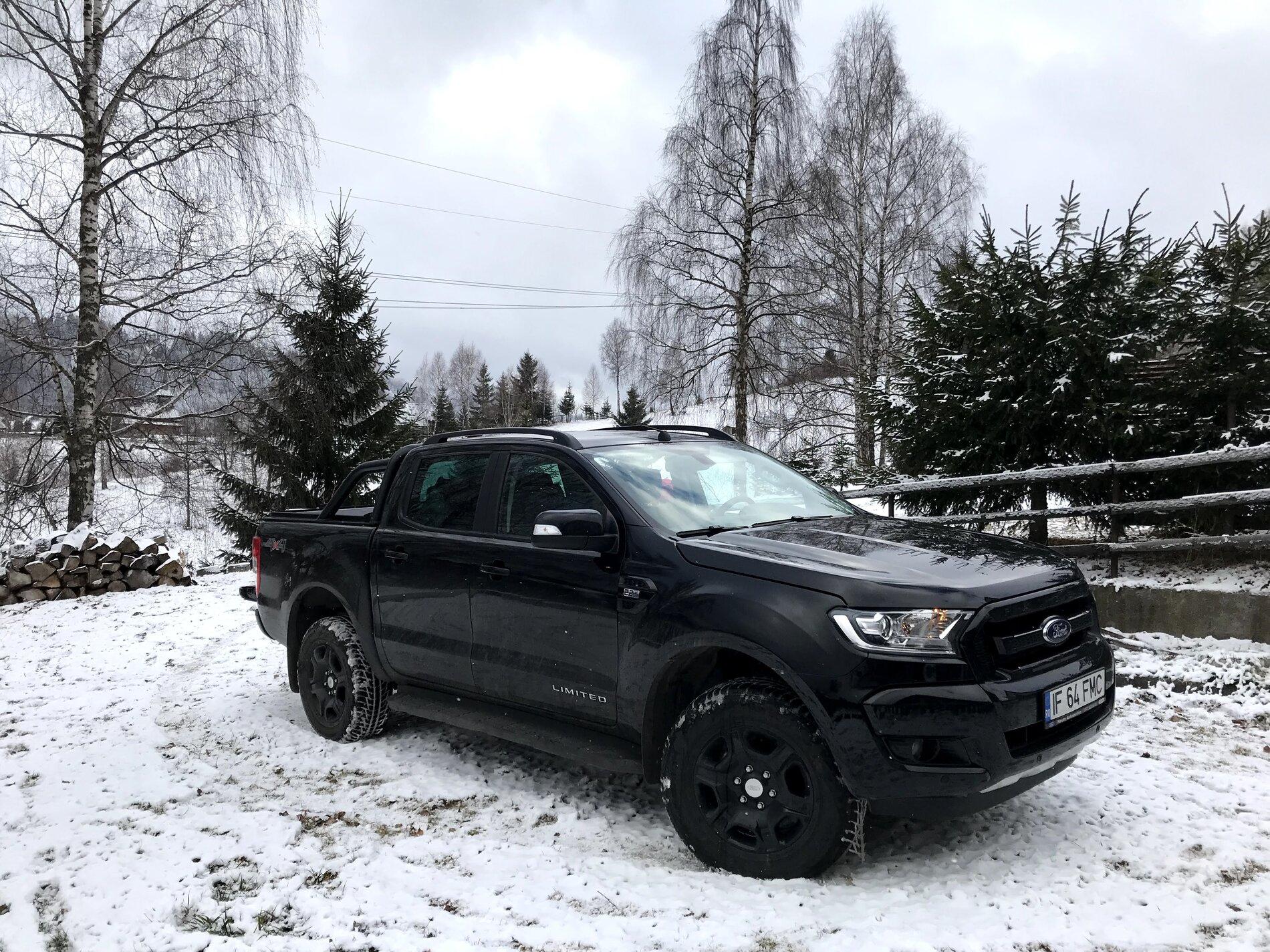

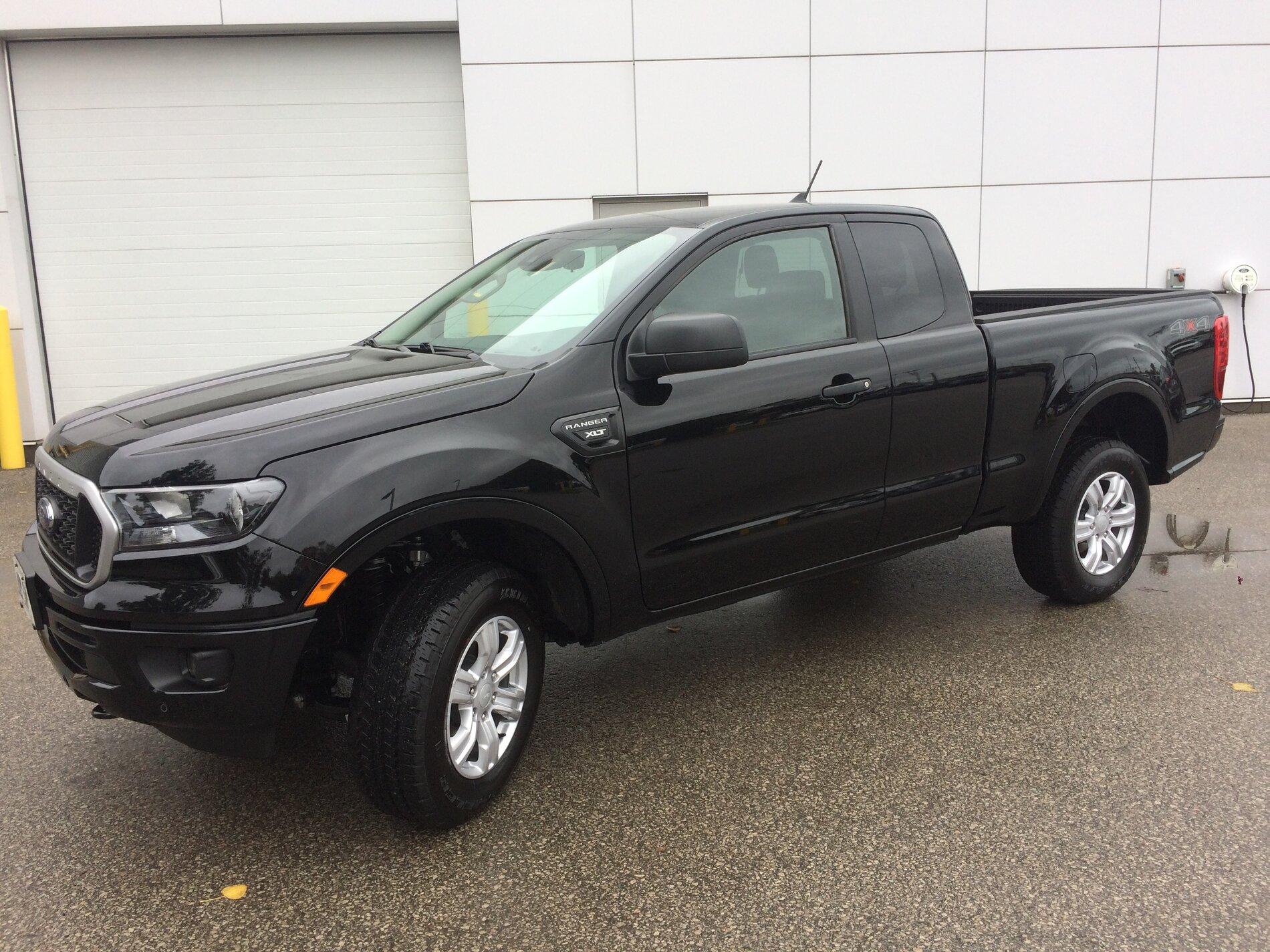

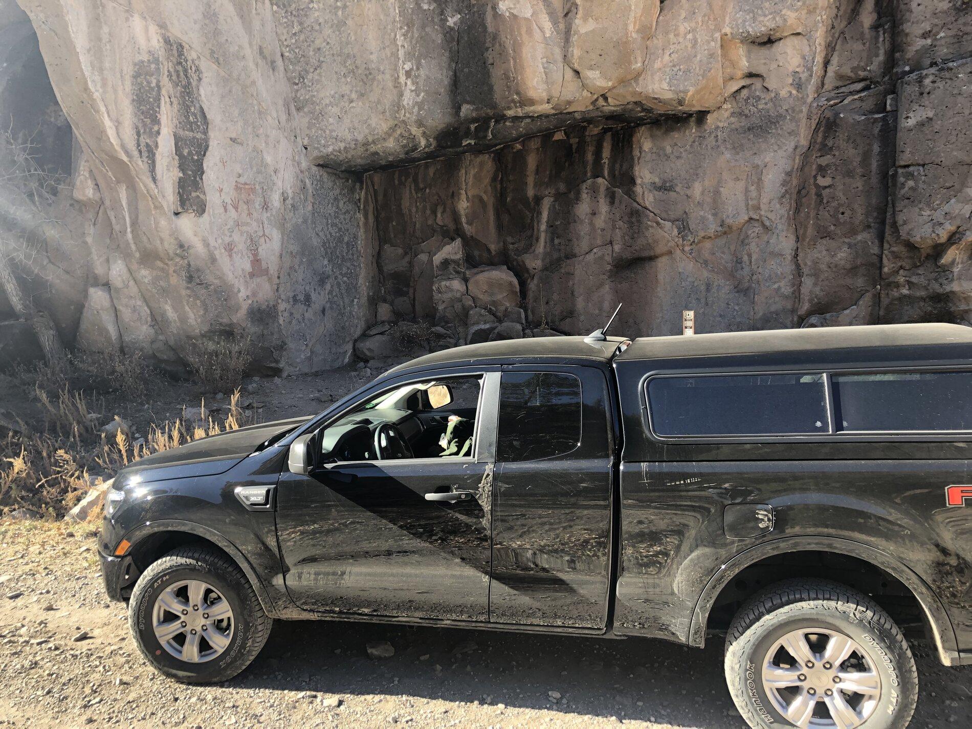

Not sure if I am allowed to, but here goes.
Mine, before lift, stock tyres 265/65/17.

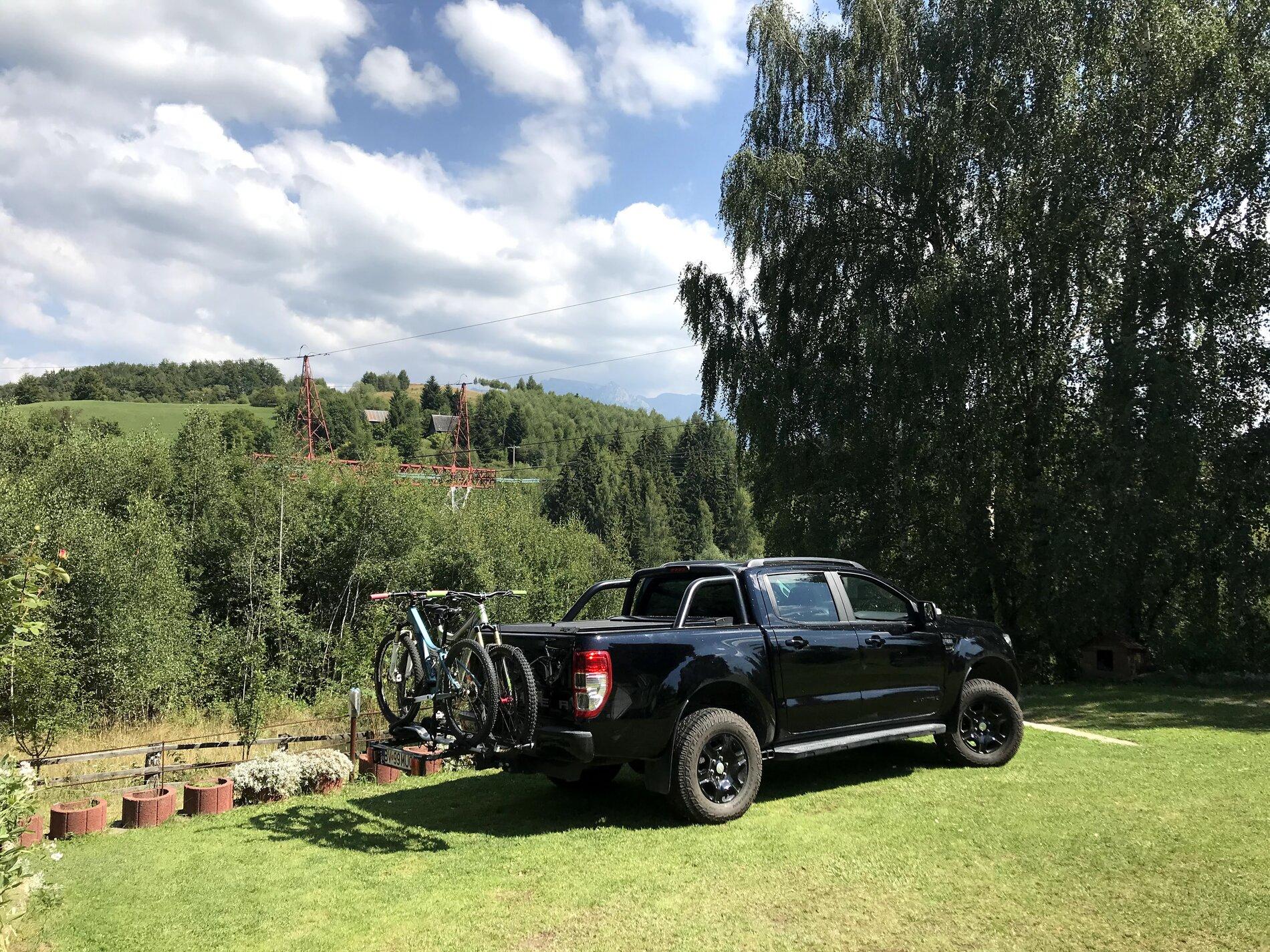

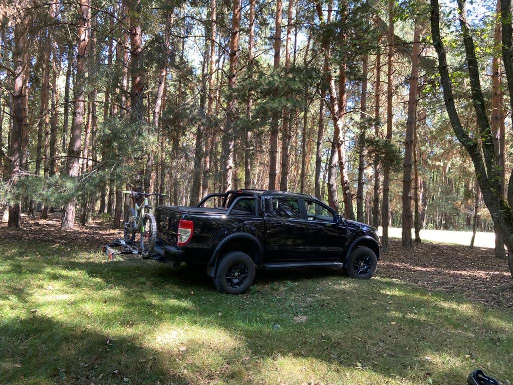

After lift: 2" front (32mm spacers) and back (add a leaf). Tyres 265/70/17". Flares added later.

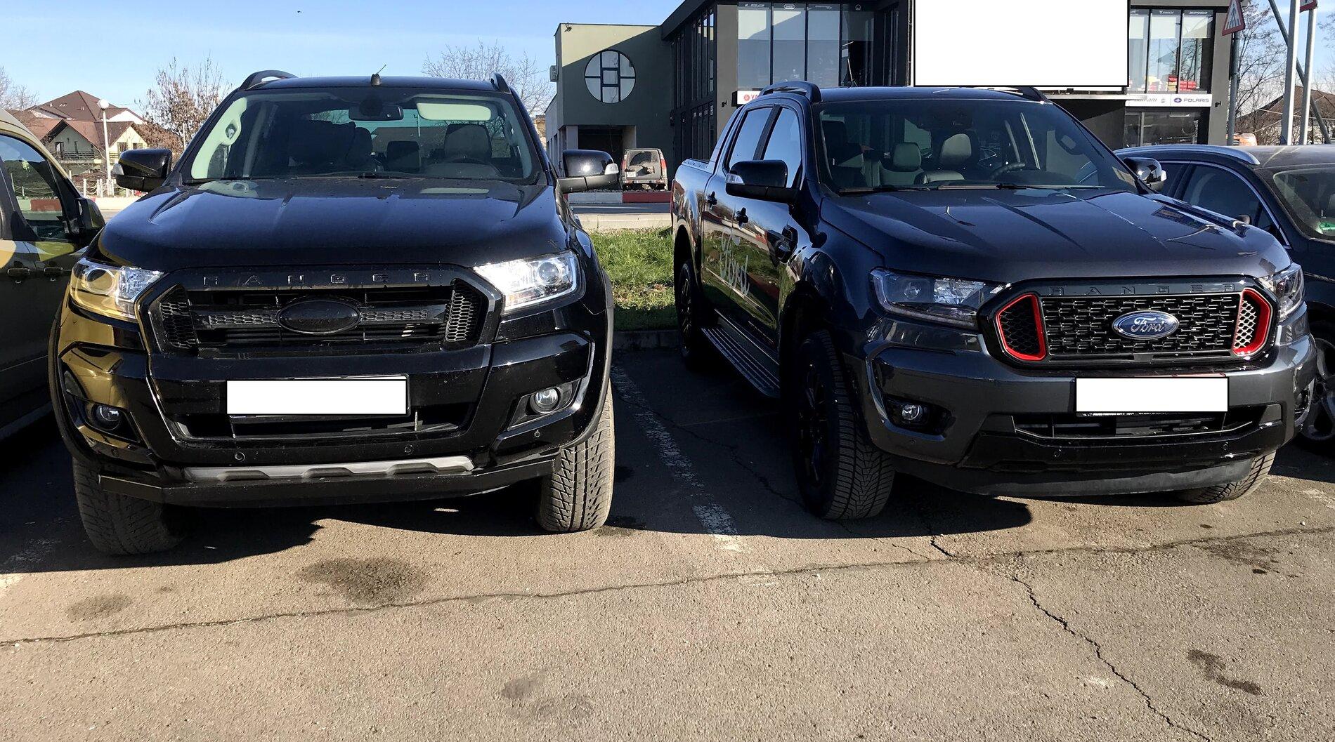

And here a comparison with a stock ranger, model Thunder 2020. This time is with the winter tyres, 265/65/17. It sits a bit higher with the all terrains.

Looks excellent, and beautiful scenery as well!
