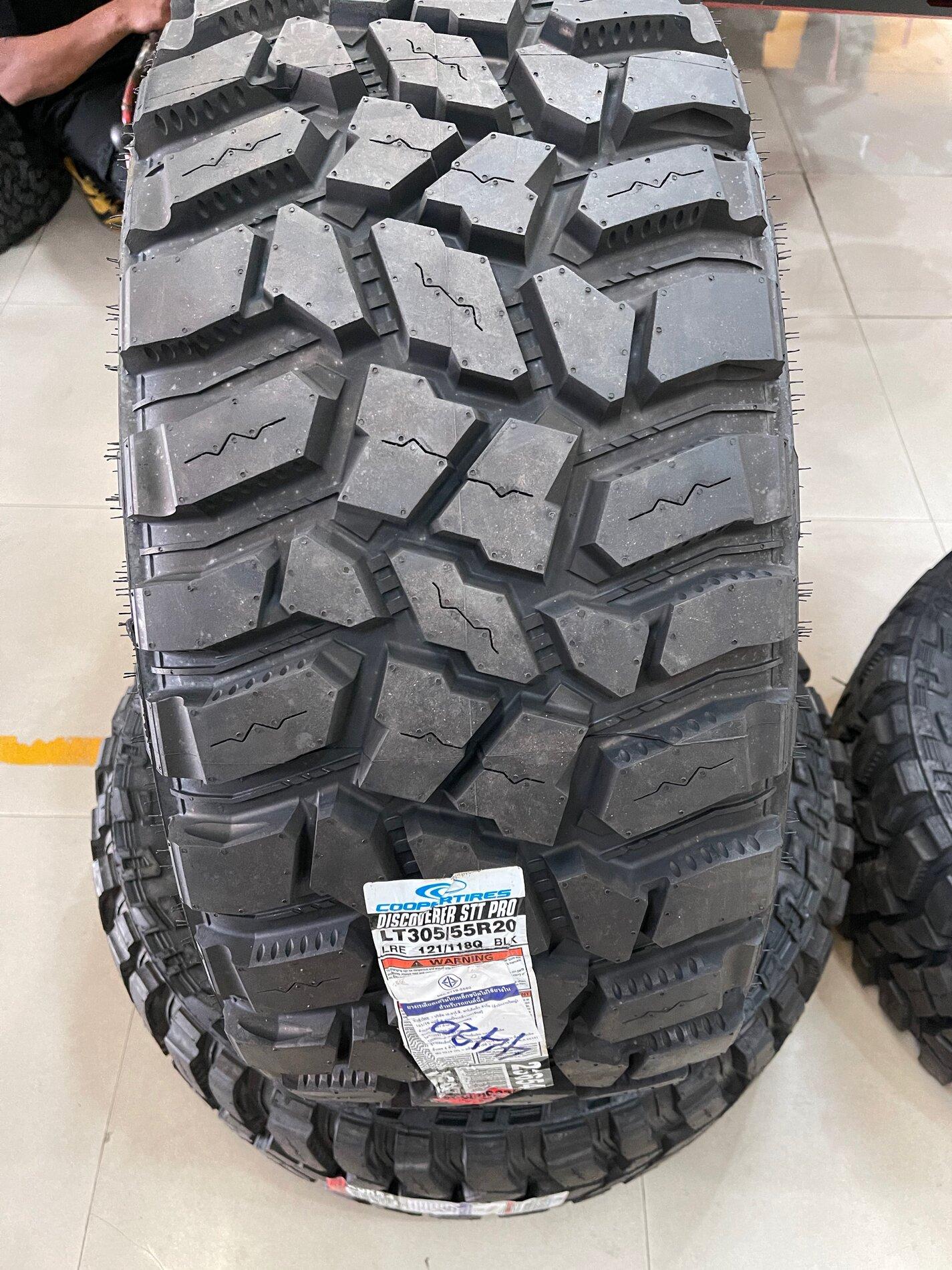

I very nearly put the same SST Pro Cooper tires on my truck in a 305/55/20 but when I saw them I just thought they were to chunky so ended up with Bridgestone KO2's instead.......are the above tires loud???
Here they are in the forecourt of the garage. They already had all my wheels off and started removing the tires when I was like f**k it I don't want them..........garage owner not happy but here we are 2 months down the road and I'm thinking of trying these tires again :) :)

I love my cooper SST Pro's on my Ranger. They have never let me down in mud nor sand. Really great in the rain and best of all I've got over 30k miles on these cooper's and have nearly half of the thread remaining. No increase in road noise either as they get older. However, I do rotate these religiously at 6k miles with out fail. Give them a try, you'll be pleased.
