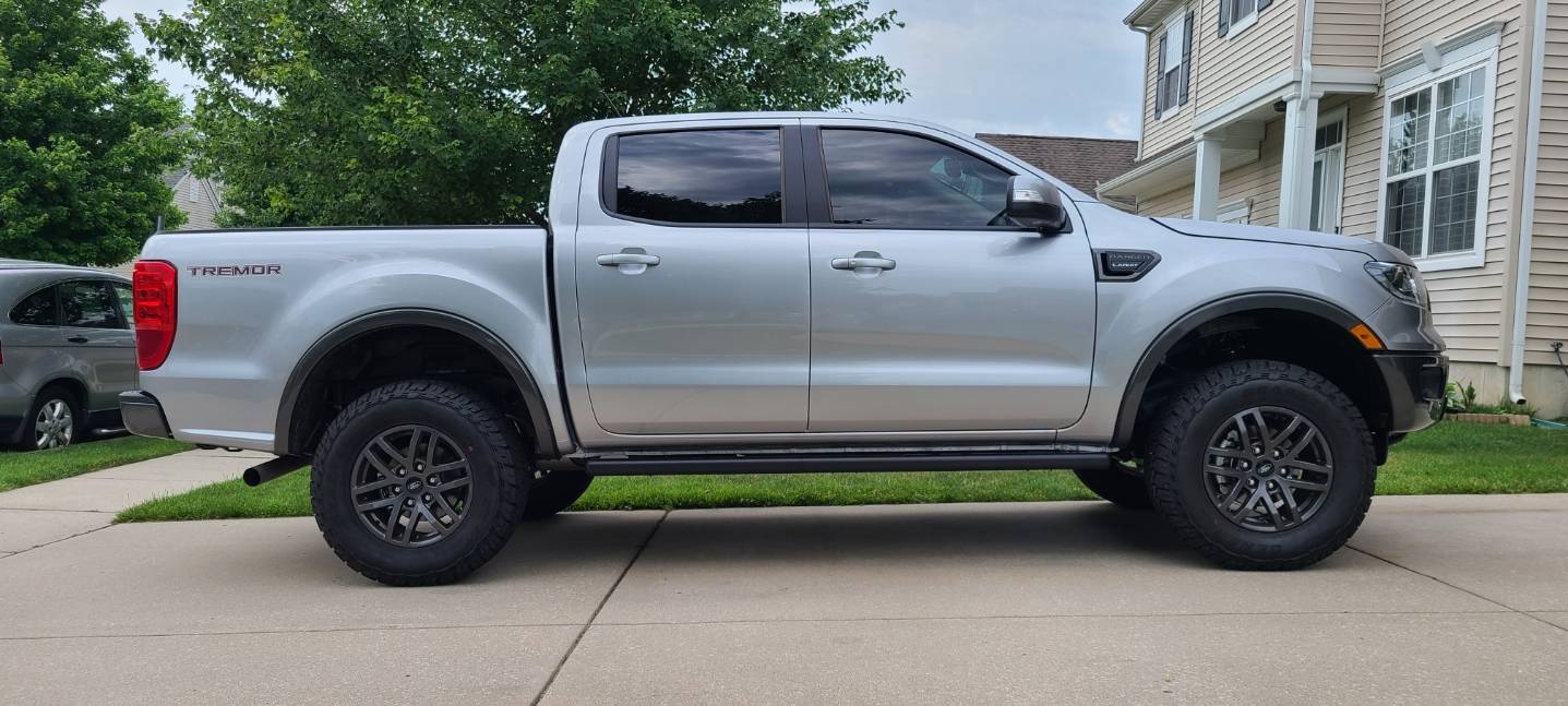

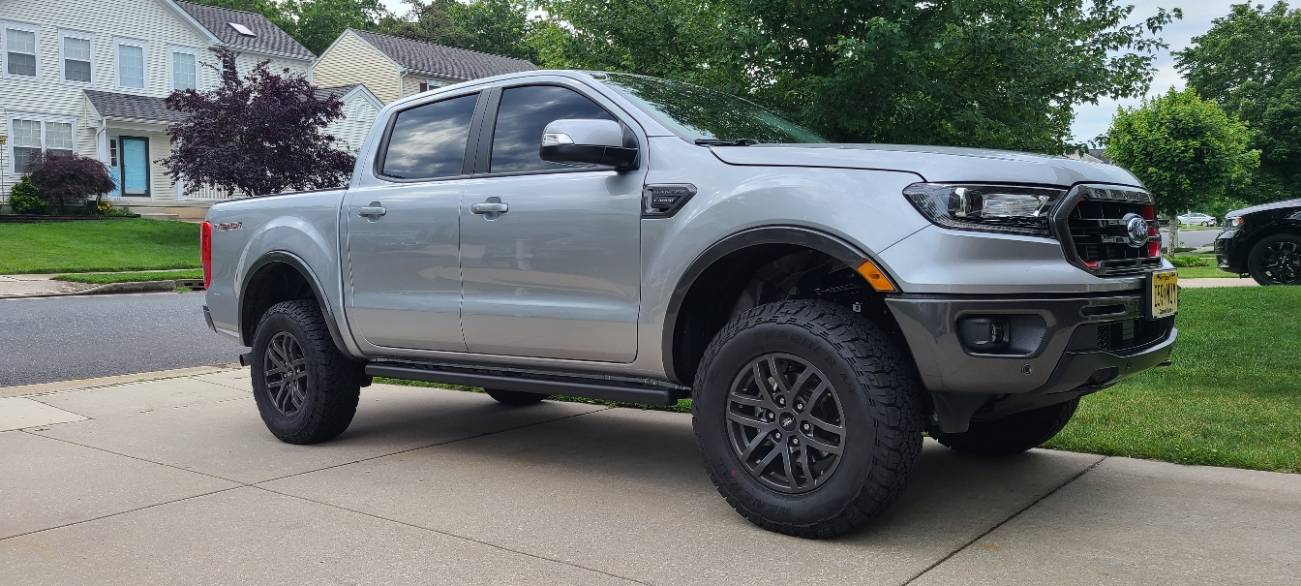

Greetings all. I'm a new member here after impulse buying a Tremor Lariat a few weeks ago. I installed a 1" leveling kit last night and managed to mess up the threads on my left side spindle. I have been trying to find information on the actual size of the axle and the thread pitch to locate the proper spindle thread repair die. I have ordered replacement nuts from my Ford dealer, and am having no luck on the correct die needed. I am hoping to not have to replace the entire axle shaft. Does anyone know the correct part I need? The install went flawless otherwise, and it looks great now. I'm not sure which forum to put this, so figured I'd start here. Thank you for any help you can give me.
