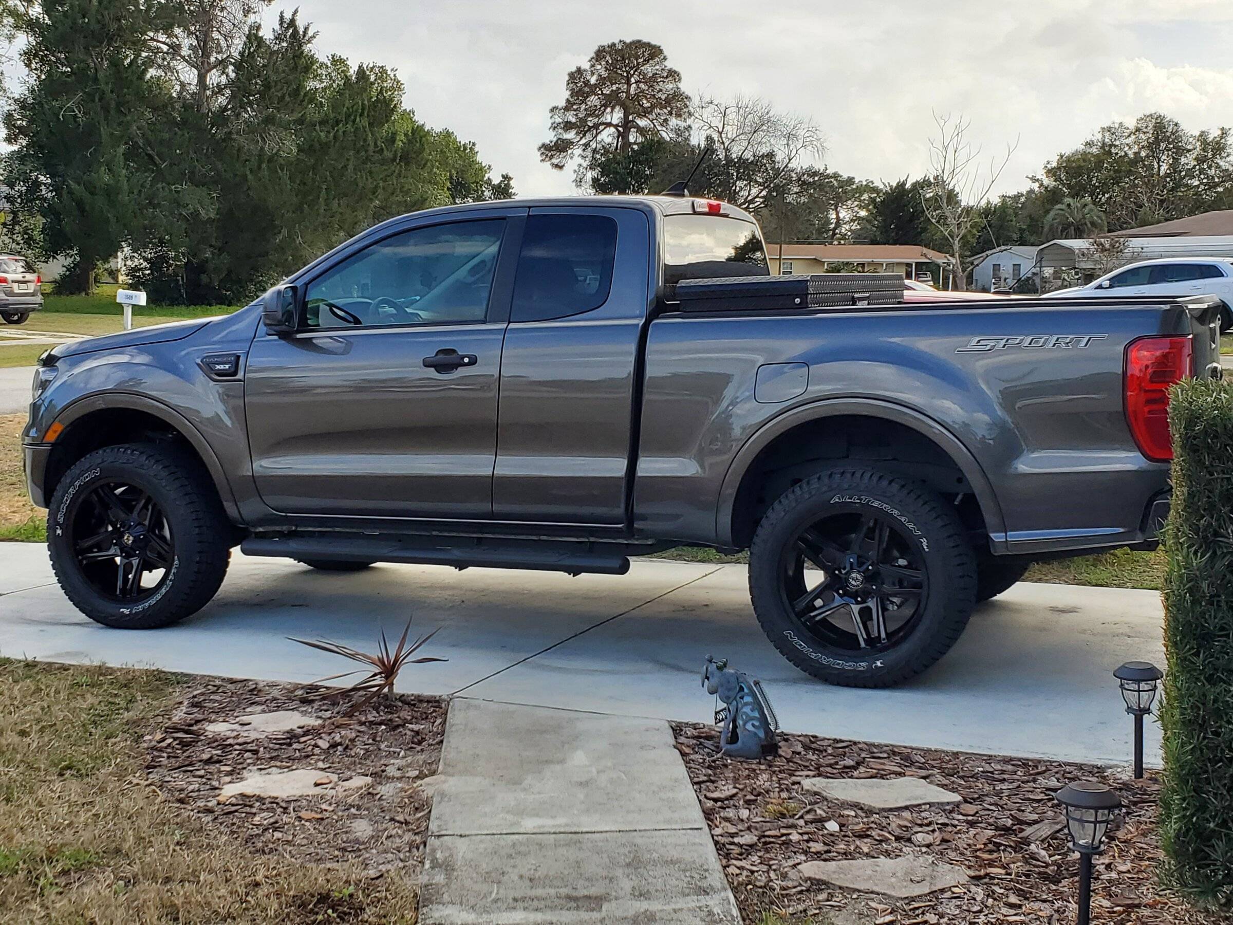

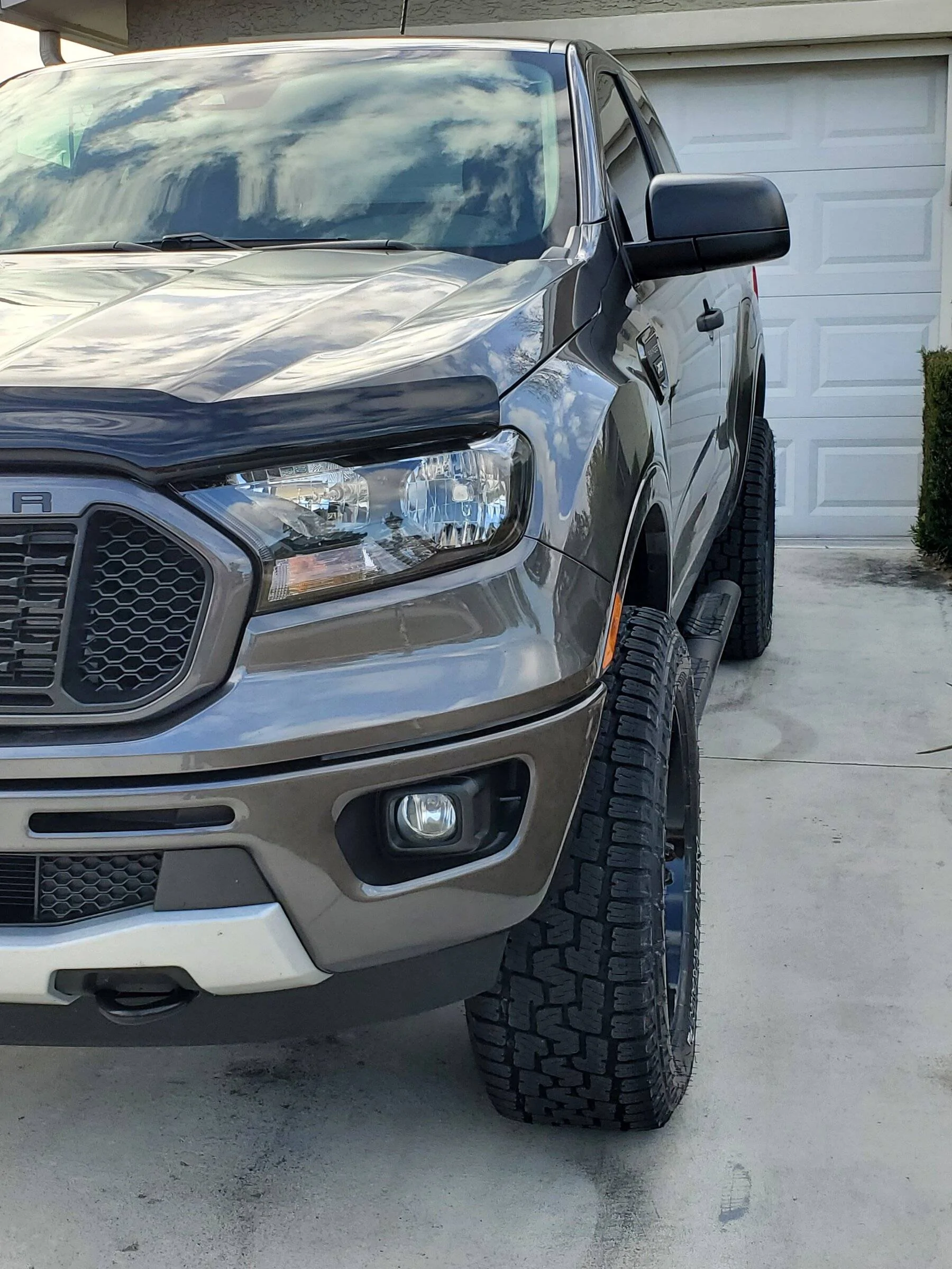

Finally was able to finish my project. This is with a 3in readylift level kit. Added readylift intrusion beams and wheels are 20x9 Lonestar with a +10 offset wrapped with 275/55r20 Pirelli Scorion All Terrain plus tires. I have no rubbing and needed no cutting. I know finding info you may be looking for can be difficult sometimes. So if anyone has questions feel free to ask.
CFLRANGER
Bobby
Oct 30, 2021
Florida
2020 Ranger
I'll post more pics when I take some tomorrow.
9,883
47,301
Any rubbing/trimming/spacers with this setup? Do you have any "down the side" shots?

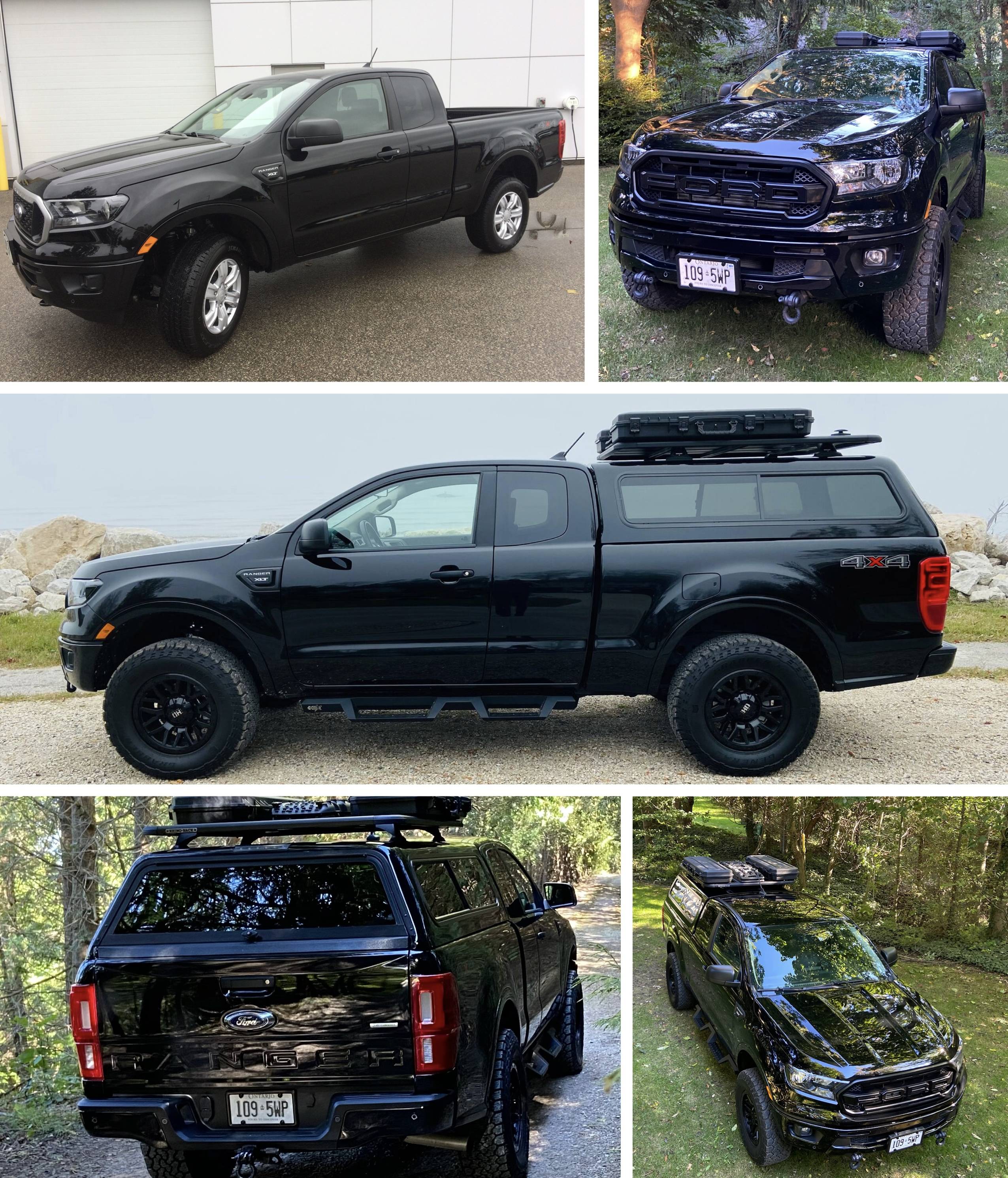

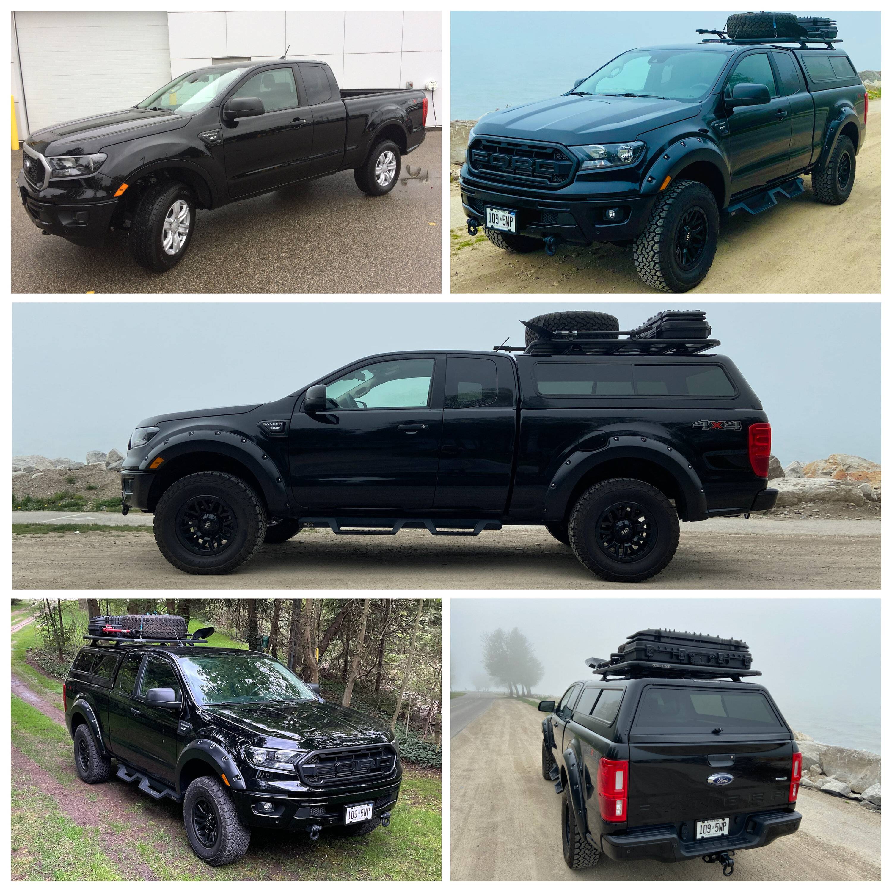

Garrett hasn’t been active since Feb. 2021 - not sure you’ll hear from him on this. However, that setup likely doesn’t present any issues. I had almost the same setup but with lower offset (+15mm) and didn’t rub - close, but no issues. His +25mm offset keeps him a bit further away from the crash bars. ?
His avatar is a bit revealing - the rear tire looks flush to the wheel well, which seems right for +25mm offset without any spacers. He also has some other pictures in his 8 posts that might be helpful.
Taking this opportunity to update my own before and after shots since replacing the RC level kit.
Rough Country 2-1/2" Level Kit
Fox Performance 2.0 set to 2”
General Grabber A/T X- 275/70R17 (32")
Menace Wheels - 17" x 8" +15mm Offset
ReadyLIFT Anti-intrusion Beams
Before & After with Flares
Before & After without Flares
Thank you for the reply. Love the look of yours with the Fox setup.
