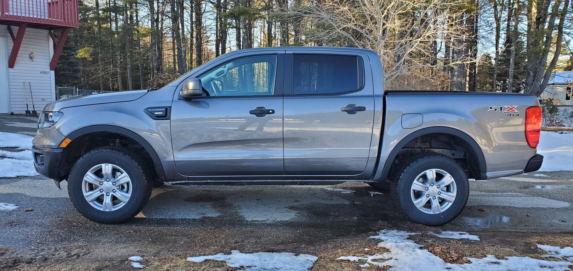

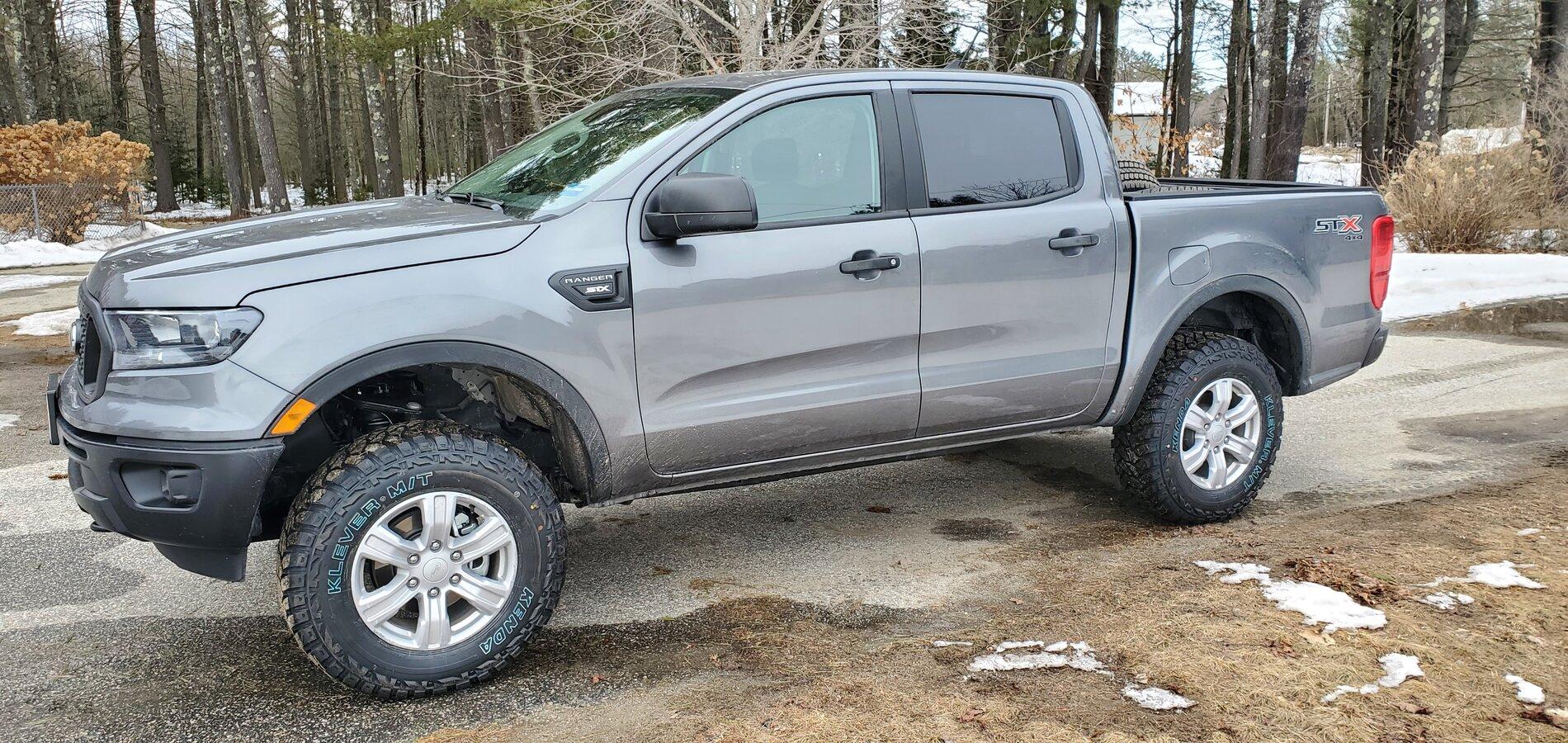

Before and after. Ford/Fox level kit, Firestone Destination X/T’s in 255/75/17.
What steps did you go with on your Ranger! My wife sure likes the looks of them and would like to do something like this on her Ranger, too. I five foot tall, she needs a little help getting in and out of it.

‘they are N-Fab Epyx bars. Easy install and they tuck up tight against the body.

Looking at the N-Fab site it appears that these steps attach to the body/cab of the Ranger. Is this correct? Not to the frame?
Thanks.

Yes, the threaded holes are already there from the factory. These are solid.

255 75 17.
Do you have a front pic so I can see the tire width on stock wheels? I want to keep the stock wheels for now and increase the profile with out dealing with spacers.

Thanks much! I think that is the size I have decided on since I'm not changing out wheels right away. It looks good!
Of course! And thank you, im more than happy with how it turned out.
The tires are stock width, but I can snap a picture later on for sure.
FWIW, everything I've read indicates that a 265 is as wide as you can go on stock wheels/offset before the tire rubs on the spindle.

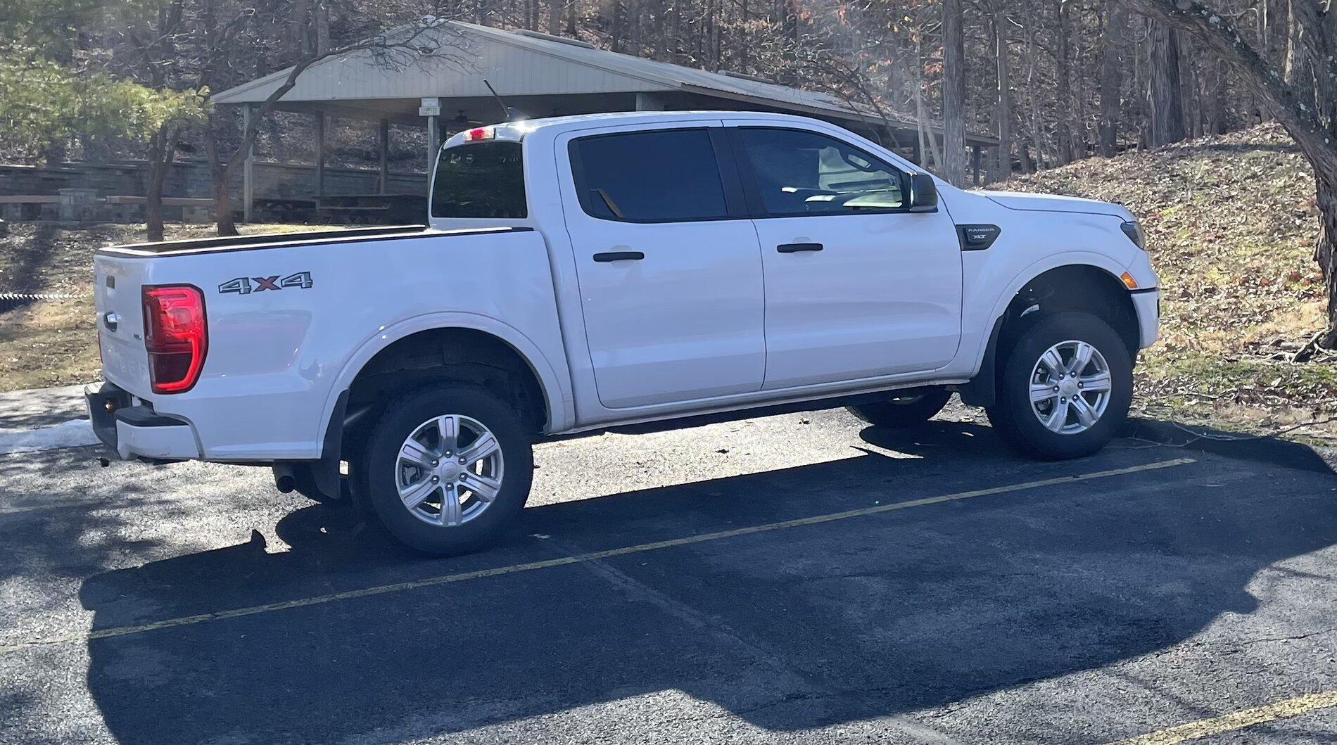

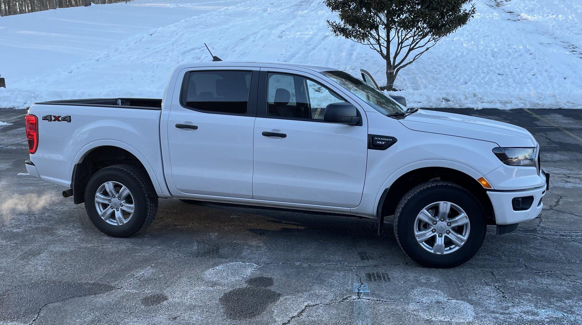

I went with the 3'' Ford Ranger Lift kit. Gave me a fully balanced 39" height front and back. Measured from the ground to the center of wheel well.
Before and after.
COOPER AT3 285/70/17
Do you have spacers on and did you alter the crash bar to get that size tire on?

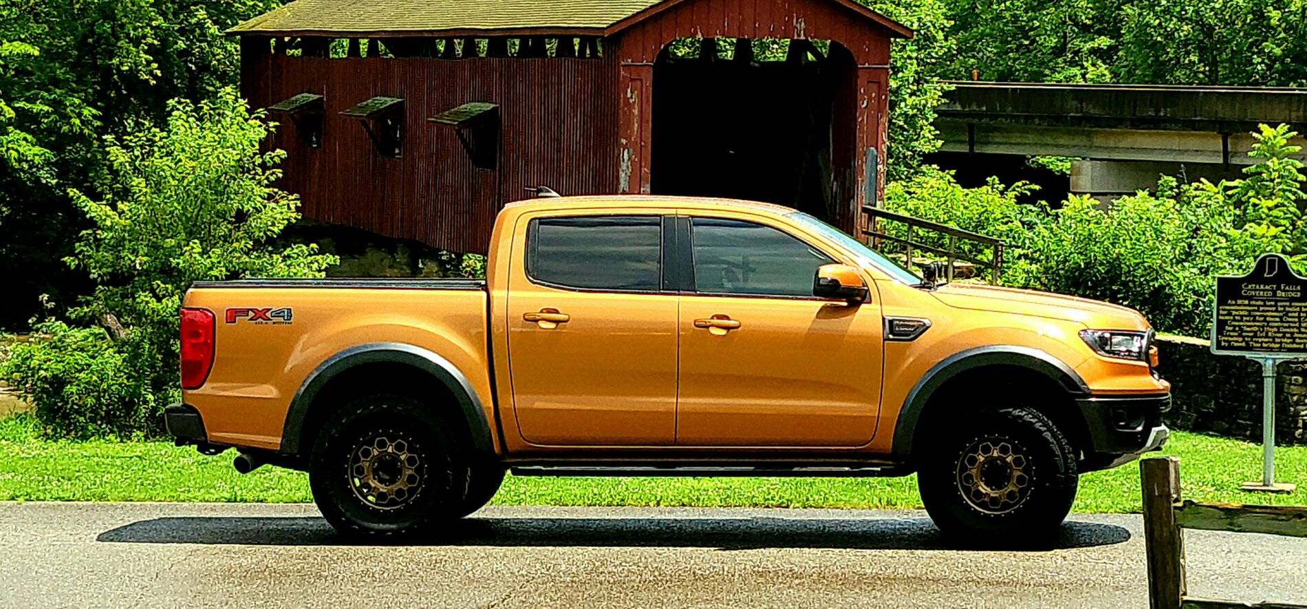

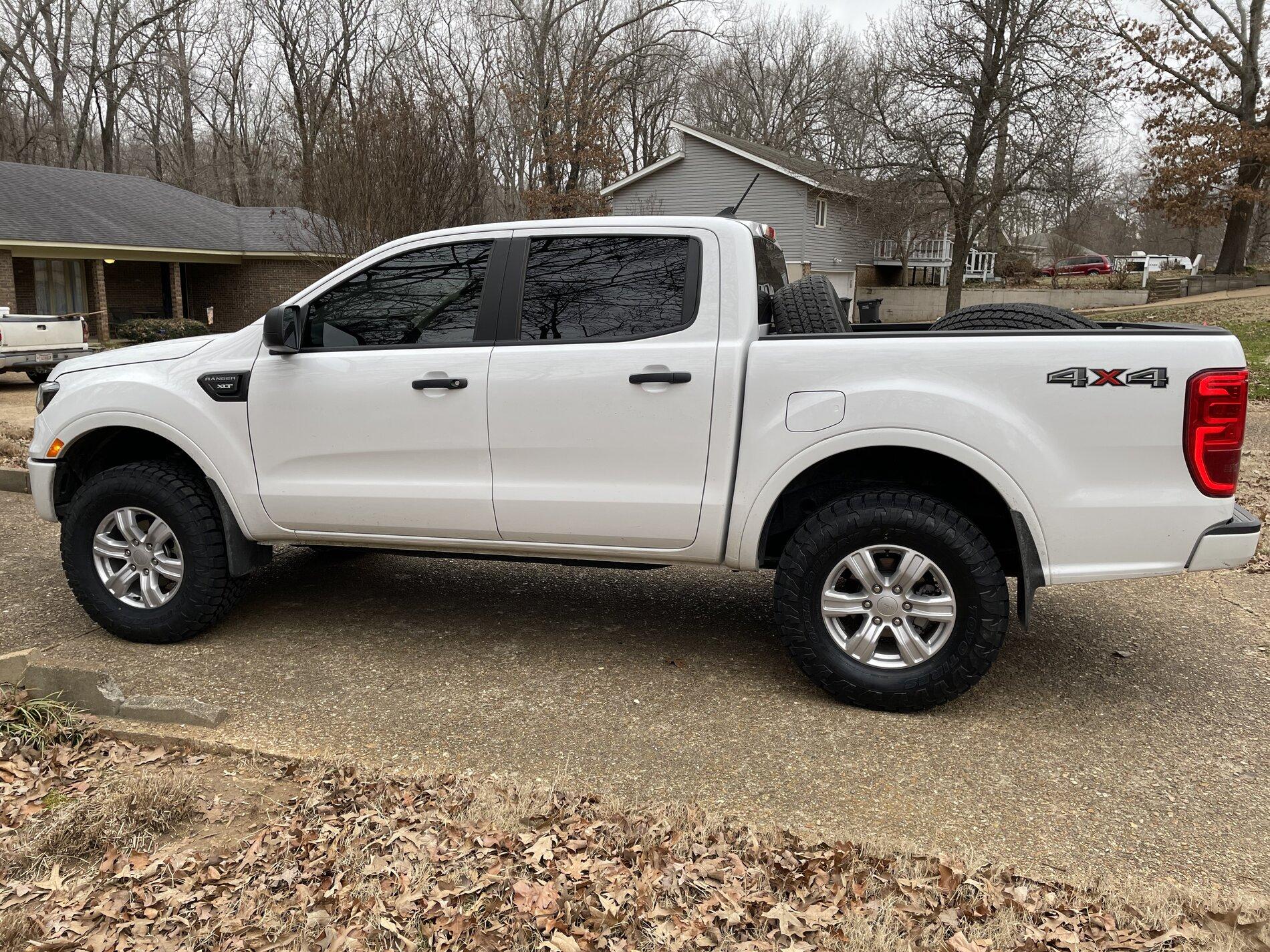

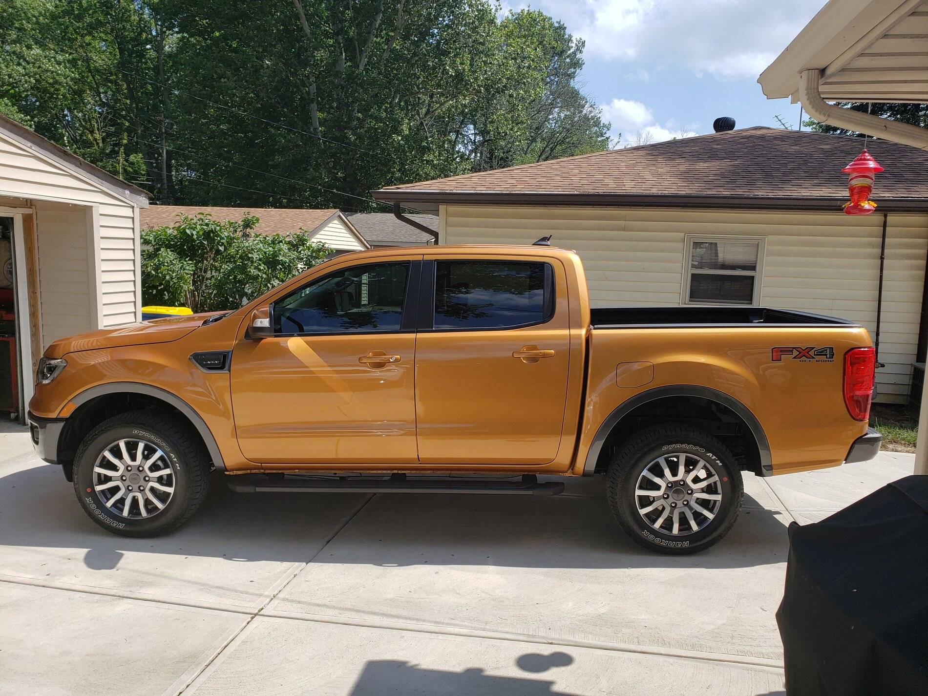

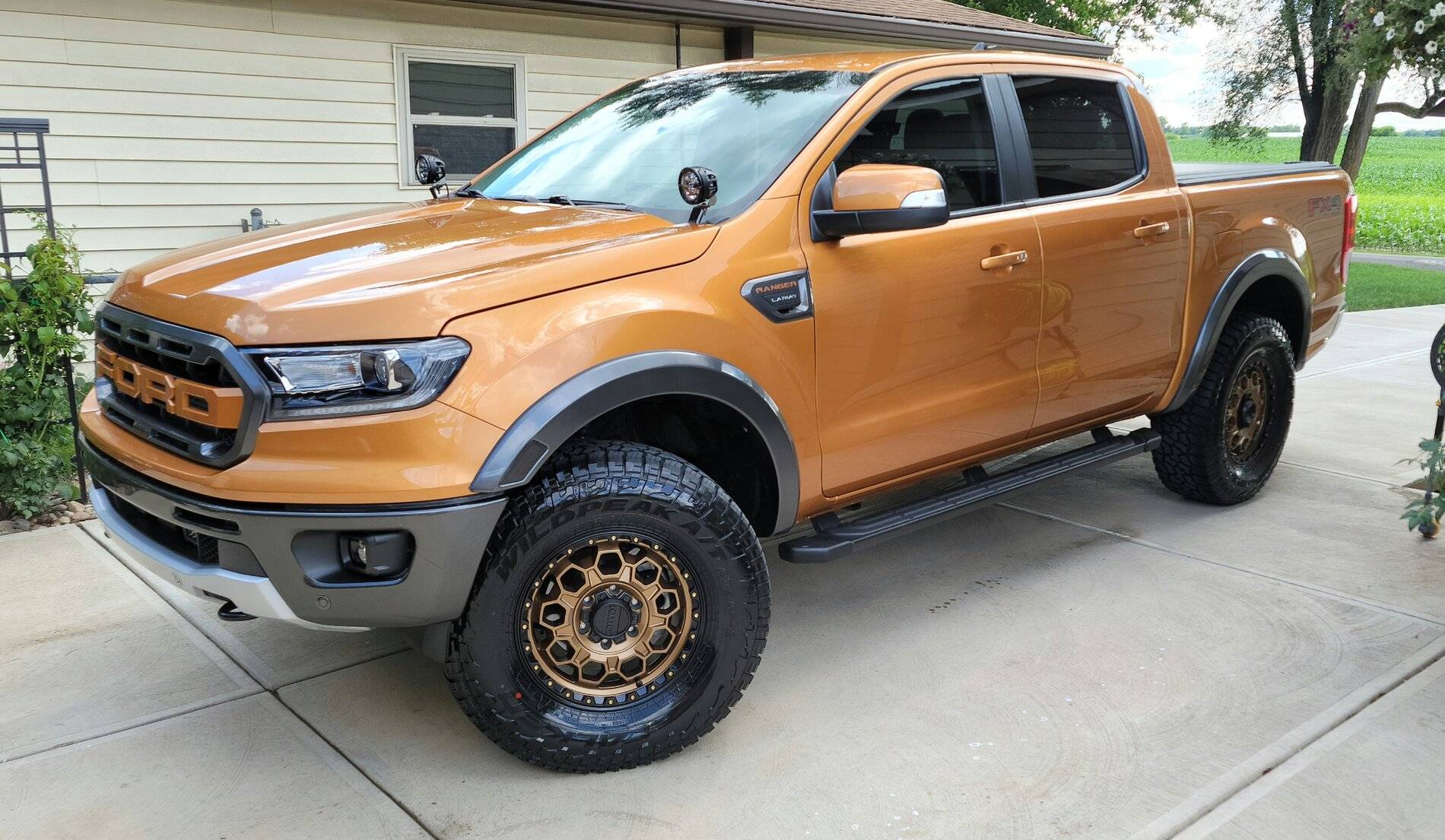

Ist Pic is bone stock on 18's
2nd & 3rd Pics with 3" total level lift and +25 285 70 17's, new ucas and new crash bars.
