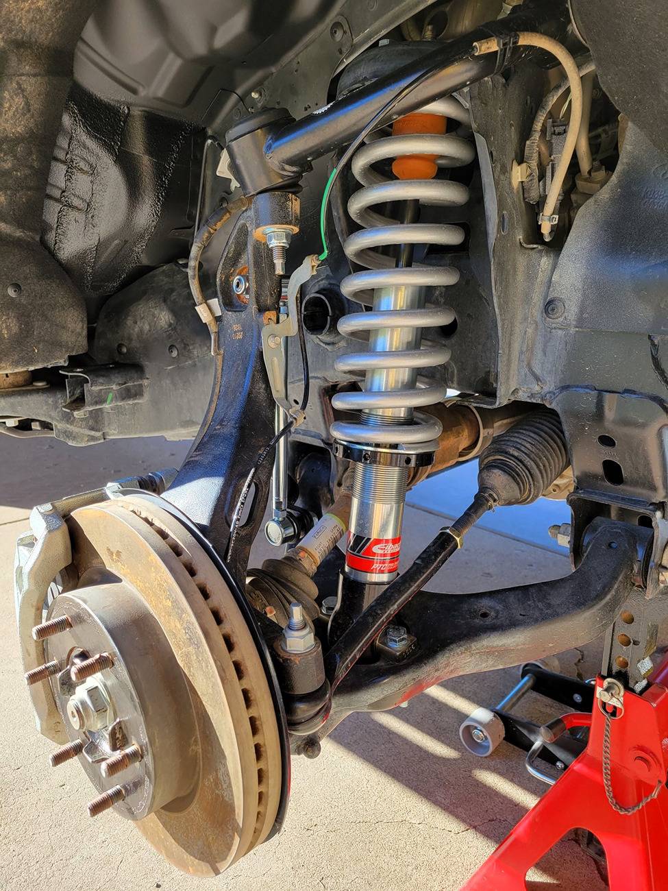

Curious, the older instructions didn't mention that and at one time (long ago) I thought they were set to 2". Will lowering them from 3" to 2" increase the stiffness of the strut substantially?

If anything, lowering the collar would unload the spring more so it should actually be slightly softer, although I doubt it would be that noticeable. The Eibach's have longer springs compared to the stock ones. My goal was about 2 1/2" total lift up front, which is why I turned the collars down 2 turns.

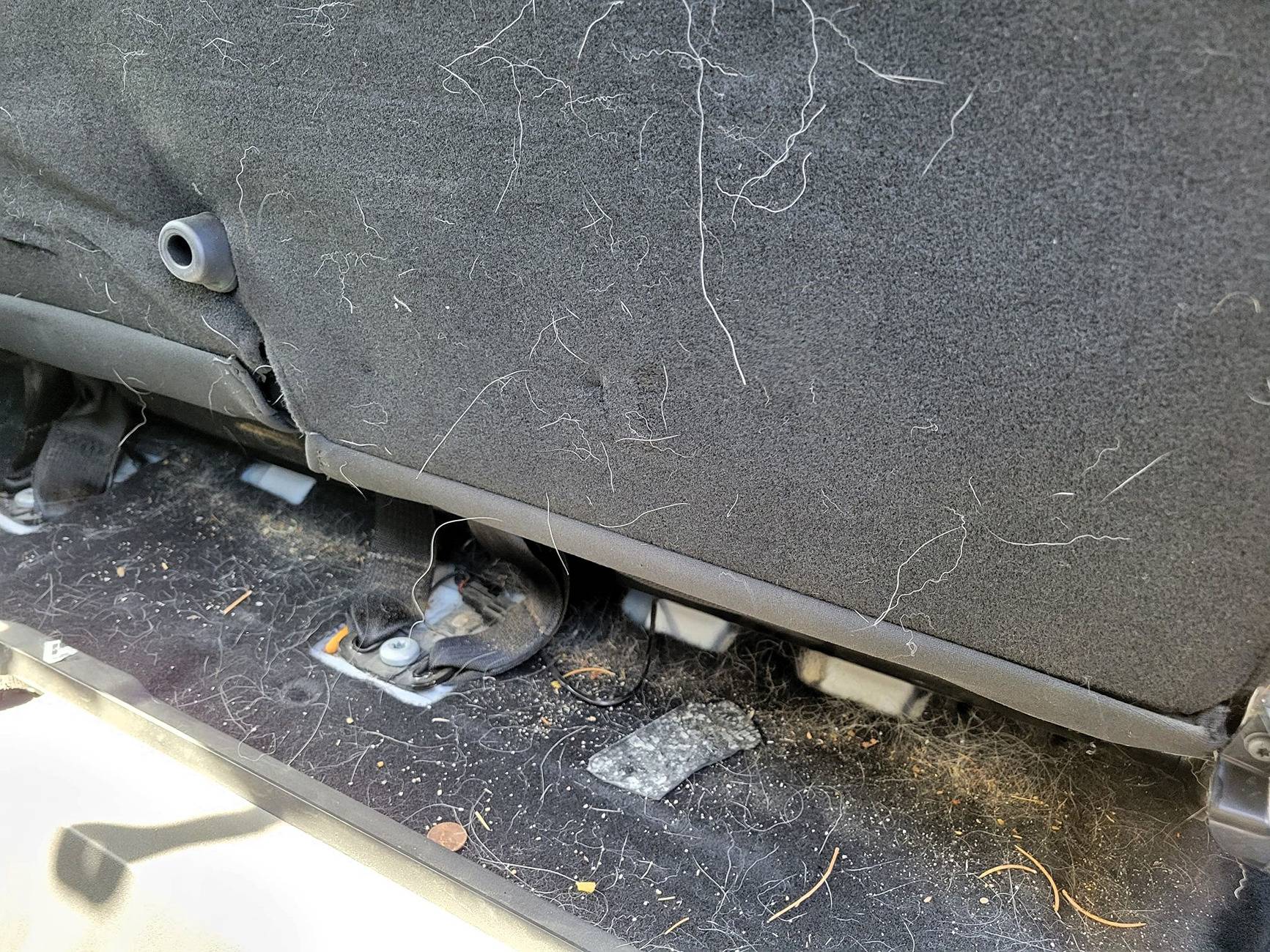

Also got the BDS 1" lift shackles installed along with the rear shocks, and vacuumed and tweezered out a crap-load of long, white dog hair and grit from everywhere. The interior was a serious mess in part to my friends at the body shop who apparently left the driver window down while they were working on it. The interior, mostly on the driver side, was covered in dirt and sanding dust. Looks substantially better now. It will get one more cleaning after the new windshield is installed.

You're correct. Sometimes I surprise myself at how stupid I can be! Of course you are lengthening the spring releasing spring load. Thanks. 8 turns gets you to 1.5" of lift.
6 gets you to 1 7/8" of lift
5 gets you to 2 1/16" of lift
Thanks for screwing my head back on straight.

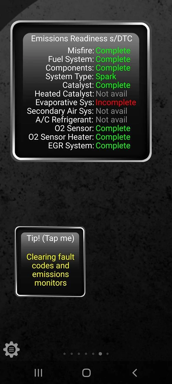

Busy Ranger morning. Got it insured last night and went to a local place for the emissions first thing. I knew it wouldn't pass because the ECU wasn't ready. Needs some more driving time. But I wanted the paperwork to show a cop I was in the registration process if necessary. Otherwise the March of 2023 purchase date would look seriously suspicious.

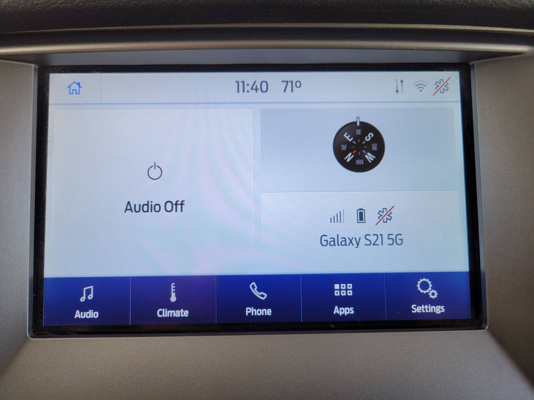

Other thing I was surprised about is no on-screen navigation, not even when using Android Auto. Just a compass shows up on screen. Haven't investigated that enough to figure it out yet but I really like our VW where a map on the phone is mirrored to the screen. At least I got it figured out enough to listen to an audio book. Was also surprised there isn't a garage door opener. Guess that's reserved for the Lariat.

A 2020 XLT should have Sync3 and thus Android Auto. Try a master reset to get it back to OEM, then update via Wifi and configure.

Yes, Android Auto should have popped up with the map on the left 2/3s of the screen as soon as you plugged your phone in. Agree on the master reset to get everything back to factory. You will need to download the latest version and install it via USB stick, it won't update via WIFI. Or you can go to Cyanlabs.com and use their Syn3updater app. I use it. Make sure to get the latest version 3.4.23188.
Good info. Thank you.
I did updates over WiFi but one of the files seemed to be taking an excessive amount of time to download, or it stopped downloading. I aborted the process. Other information I read online said that Ford Pass was required to pass nav info from the phone to Android Auto.
A master reset sounds in order so I'll research that.
FYI, the website is Cyanlabs.net.

Updates via wifi take a very long time. It's "normal". You should not need Ford Pass. I don't have it and updates work fine. The master reset is in settings on the Sync3 screen.

Looks like I have a downgraded infotainment unit. No navigation. Tried to upload an update with a map and got an error. It appears that if I want full Android Auto and navigation then I'll have to upgrade to something else.

Found the reset quickly and discovered the super slow WiFi upload after being more patient. As noted, it appears I have a downgraded unit so I'll have to install something different to get full nav and Android Auto.

OK, that is the normal 8" SYNC screen. Have you plugged your phone in to one of the USB ports in the console cubby hole? The 5G Rangers do not have wireless AA, so you must plug your phone in, and only the ones down in the cubby work for it. I do not have factory NAV on my XLT but AA works great.
