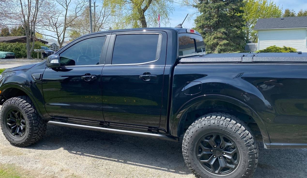

Hey Rick.

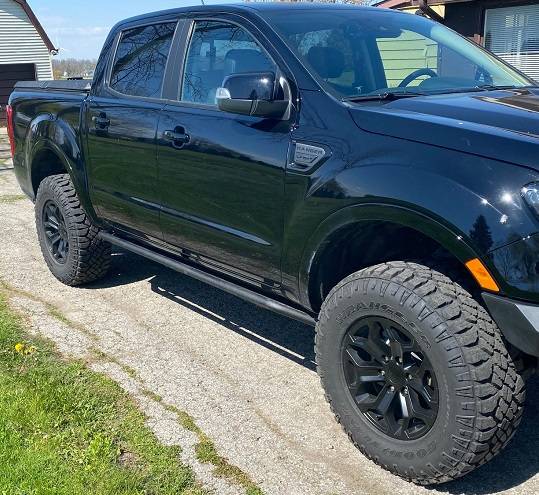

They are great. Not true rock sliders as they are bolted to the body not the frame. They use the same 6 holes as factory steps, but provide upgraded bolts, and are fully welded 2 inch steel tubing. They are very tough and I expect they will hold up to everything short of very hard drops.
Strong enough to be used as steps, but just round 2 inch steel pipe on the outside, no flat spot or step area per se, and tight to the rocker so tough to step on perpendicular. They do have a gritty texture so grip is pretty good while it lasts.
I love the look and quality, but I think there are actual rock sliders available for about the same price. Being in Canada the options were limited and these were advertised as available so I bought them.

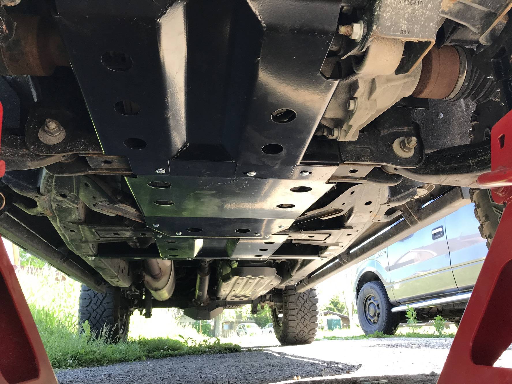

Shrockworks #2, 3 & 4 steels skid plates.

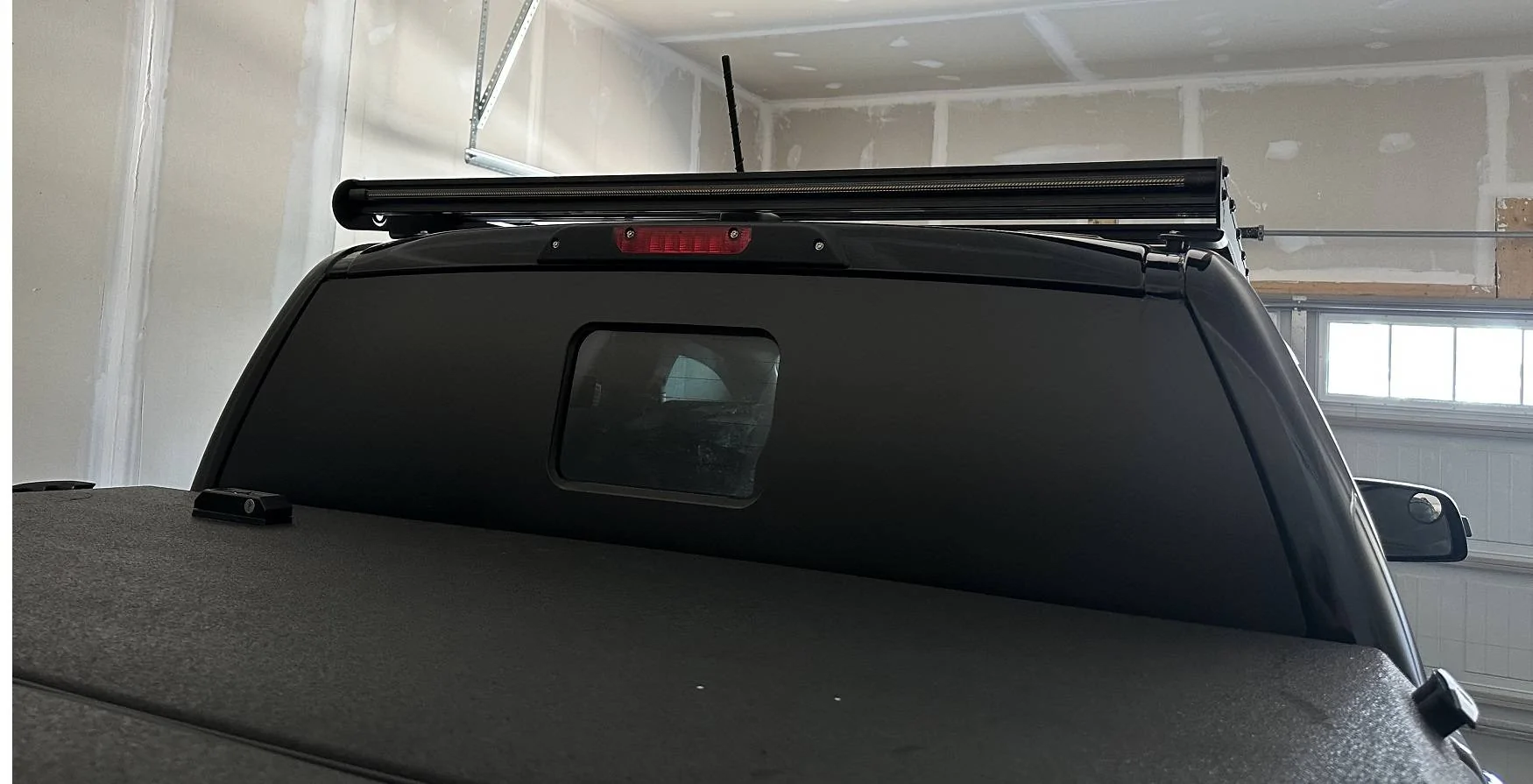

Putco Blade tailgate light bar on the rear of my Prinsu roof rack.

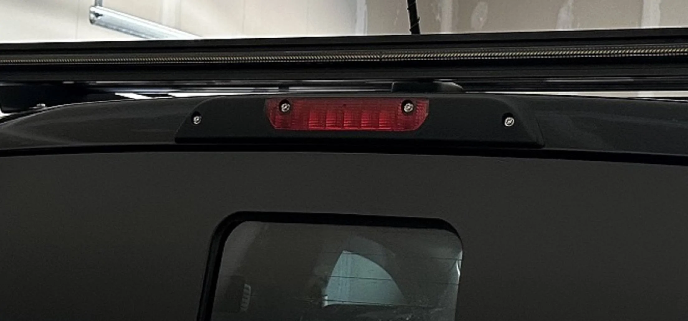

Plasti-dip the white lights on my 3rd brake light. The Putco light bar reverse light is wired to my S-pod controller so it replaces the white cargo light, not connected to the reverse switch of the truck.

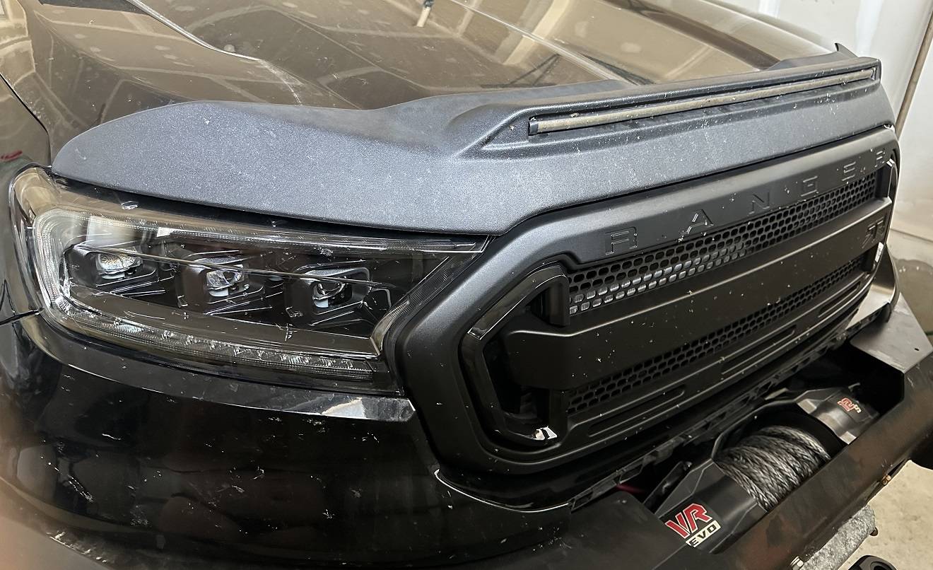

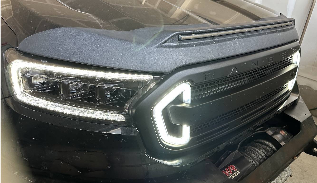

Morimoto XB headlights and RTR grill (also cut away the lower grill surround to accommodate a light bar going on this week).

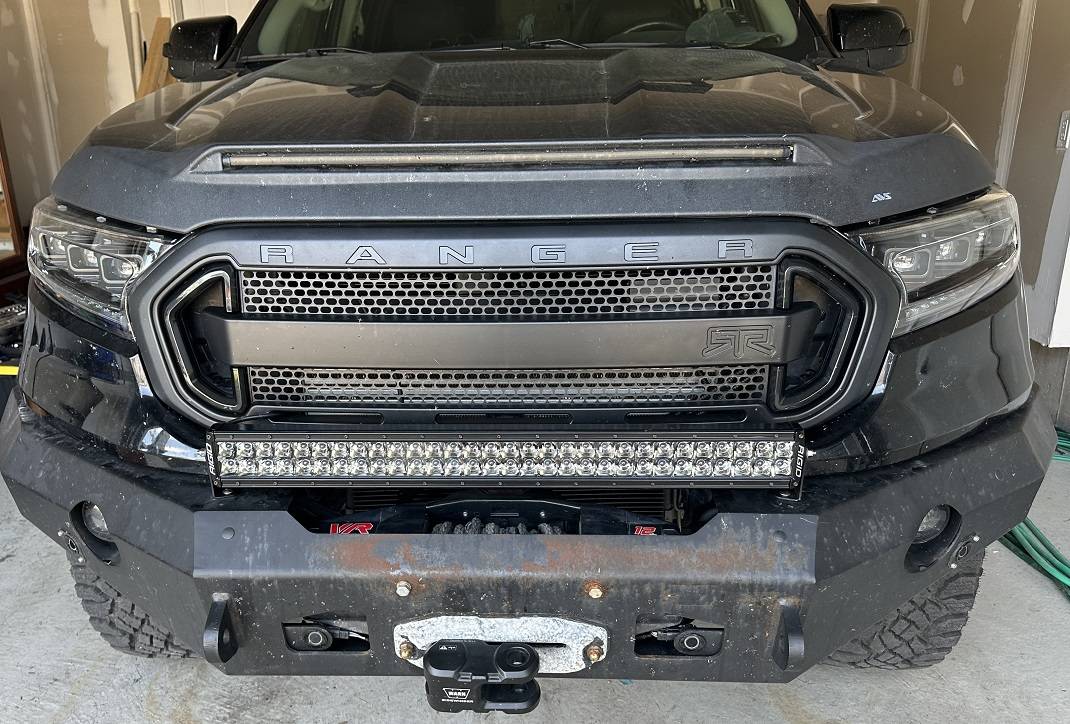

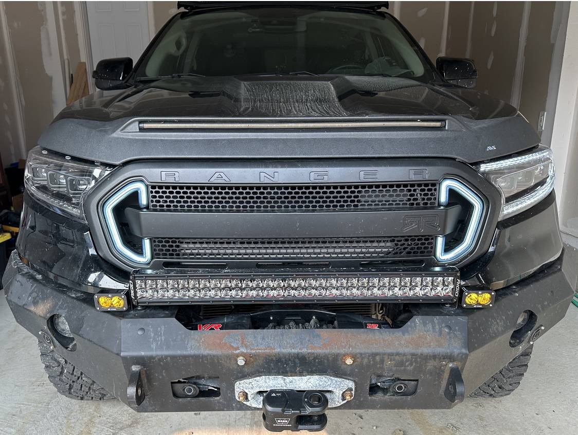

Rigid E-Series Spot Midnight 30 inch light bar installed today. Not wired yet, but got the holes drilled and hardware installed. The lens picked up some flash from the camera, but the light bar is much darker than it appears in the photo, and blends in very nicely with the blacked front end.
311 watts
22.2 amps
32,700 raw lumens

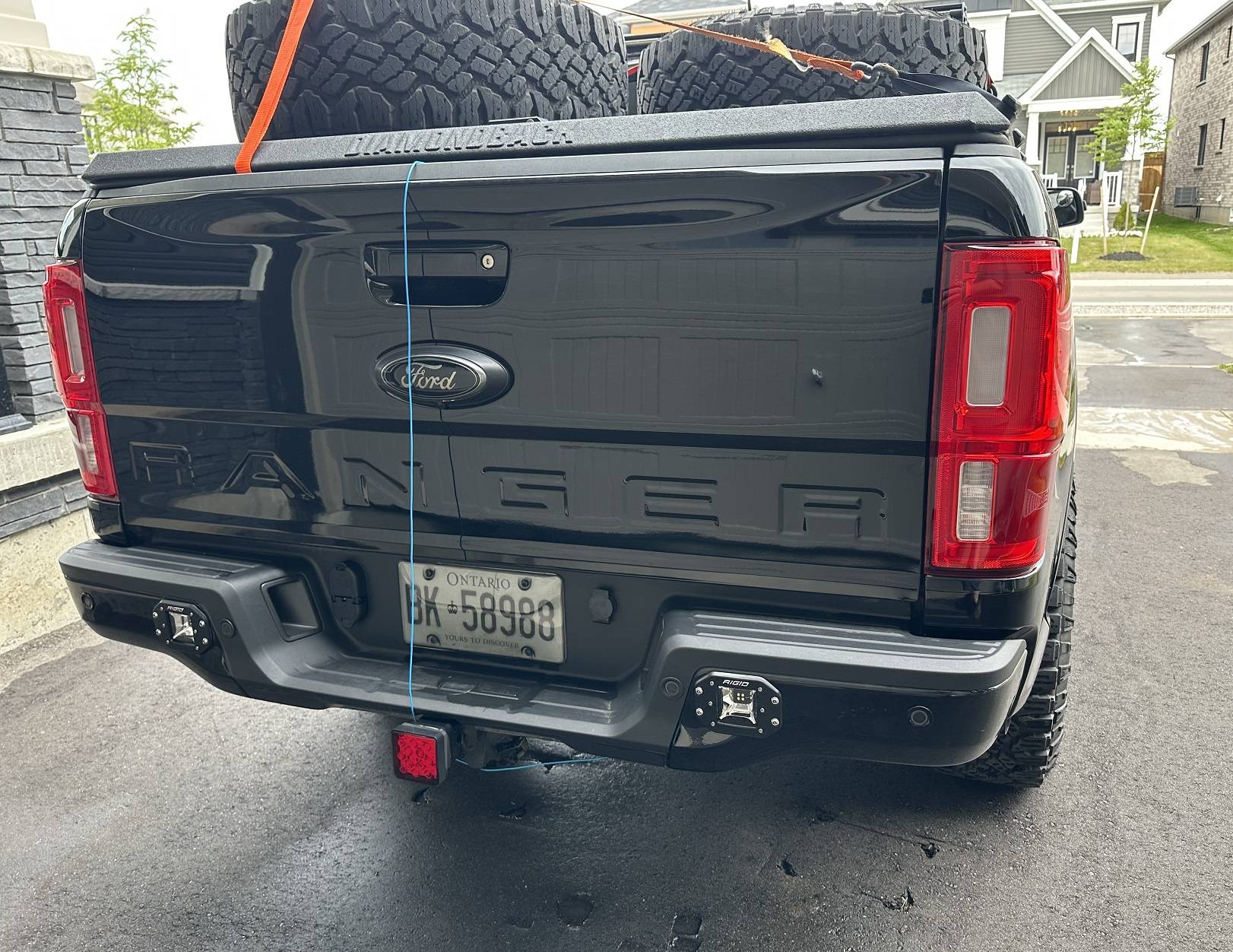

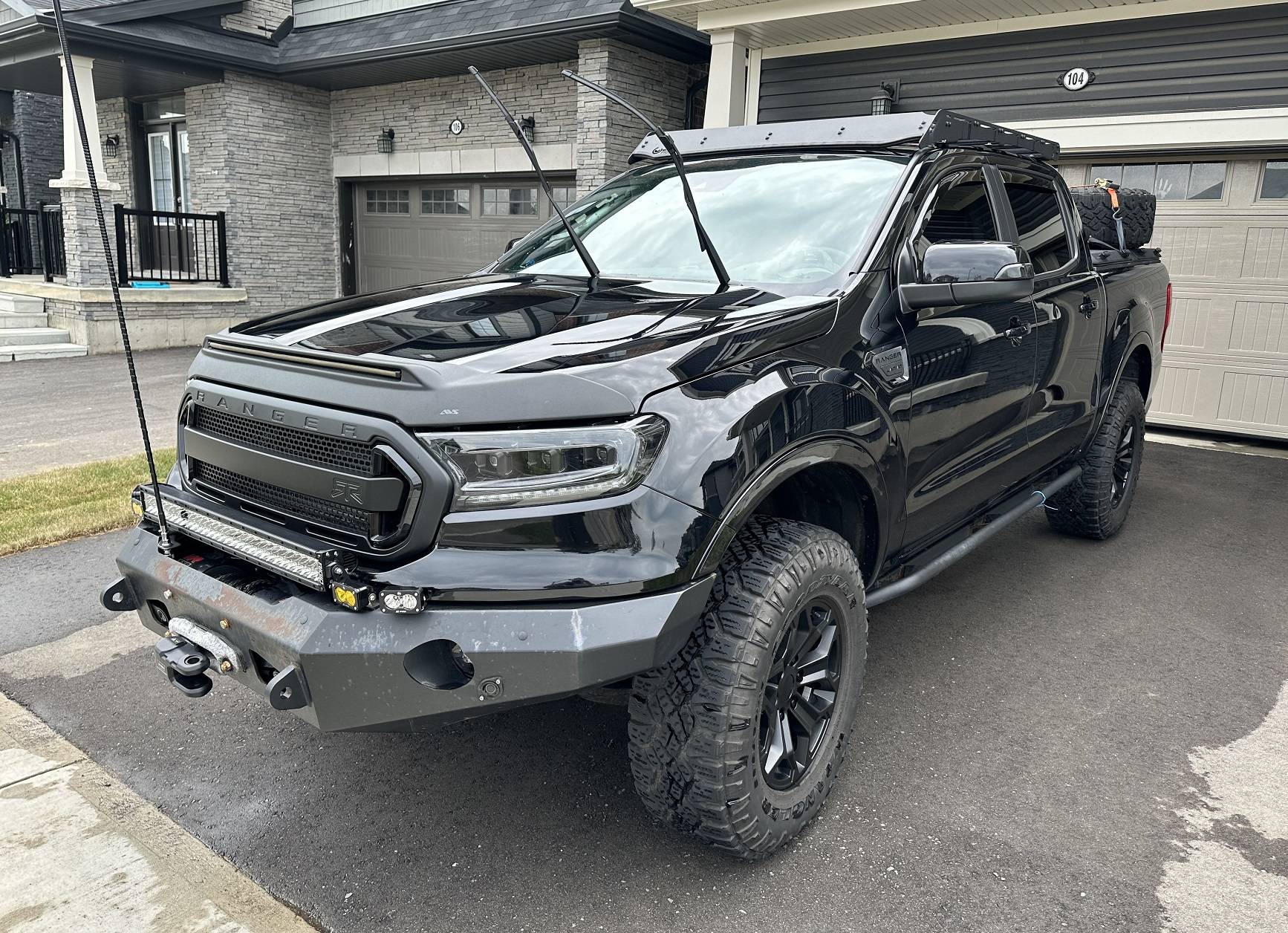

A 2nd set of Baja Designs S2 Pro, but white driving pattern as ditch lights, and 4' Firestick CB antenna.
Rigid Radiance Scene flush mount reverse lights and an Amazon cheap-o trailer hitch brake light.

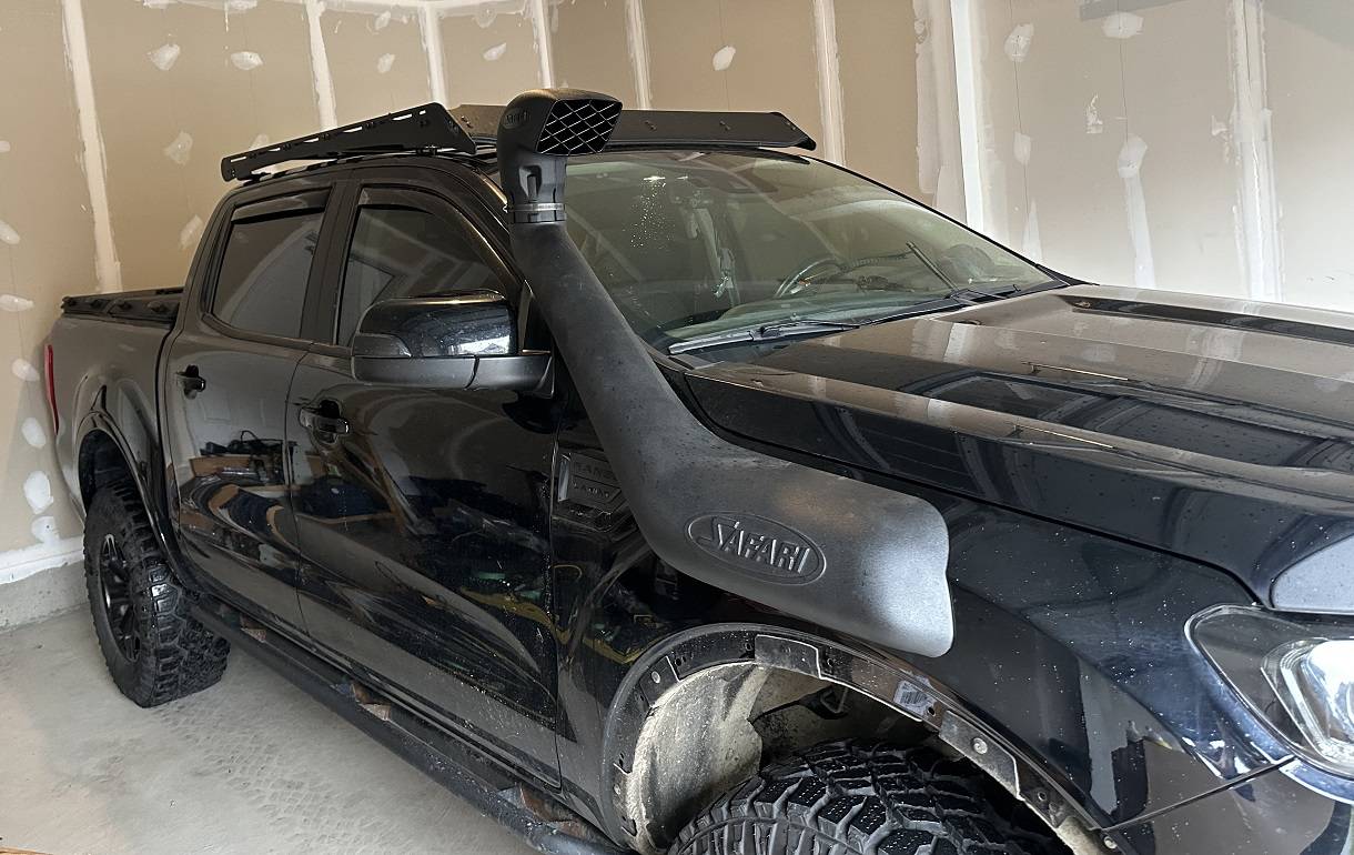

ARB Safari snorkel.
